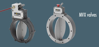

I appreciate all of the ideas and thoughts but there is already a proven system out there that has been in use for years, the emergency air kill is a simple butterfly valve that can be triggered in a number of ways, key off, tilt switch, over-speeding RPMs, or a simple manual kill, we don't need to "reinvent the wheel" , on my particular tractor I will need to reroute the crankcase vent but even if it's not the simple air kill will have the same effect as CO2, blocking the air intake with rags, exhaust gas, etc. the Air Kill WOULD have stopped the engine, yes it would have continued sucking in oil through the vent tube but it would not get enough air to continue running.
This air kill is required on all diesel engines that operate in hazardous environments, gas well locations, chemical plants, etc., I've seen them on everything from small water pumps to D9 dozers.
As I said I appreciate the ideas and if you want to rig up some kind of "rigged" CO2, fire extinguisher, exhaust gas re-router then that's fine but there is a already a "proven" system available.

I found these instructions from one of the manufactures of air kills...
Any engine crankcase breather connections into
the intake system between the MVX valve and
engine, or any internal crankcase breather
arrangement venting directly into the engine
intake ports must be sealed and replaced by an
external breather system venting either to
atmosphere or to the intake system upstream of
the shut down valve. External breather system
kits for various engine types are available from
Chalwyn.
So it looks like the real culprit here is the crankcase vent plumbed into the intake.
