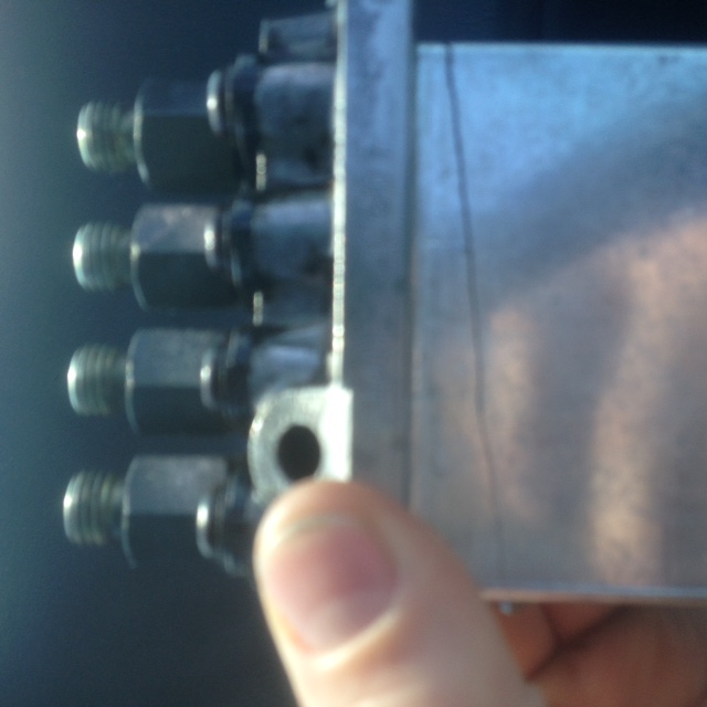

To: Myhoe: Thank you very much for your reply, and a thanks to all other interested parties. Every thing you asked about and suggested is spot on. Now to answer some questions:
First off let me clear one thing up. After hydro locking the cylinders myself and an older gentleman from church with lots of diesel experience, Huey, from church pulled the injectors to get the oil out. When removing the injectors one came apart, so Huey took them all apart and cleaned them with chemtool. Well turns out he got one wrong and it has been stuck closed since, hints the reason why its been running at 80% power.
So all that being said, I knew I had to get the injectors to the shop but had a backlog and ran the tractor against my better judgement to finish the jobs I had booked. On the morning I was taking it to the shop it was cold and the tractor was really hard to start. I gave her a "TINY" snort of either, got her started up and wemt to hook up to the trailer, came back and it had died and puked a bunch of oil/fuel out the exhaust and intake, and a lot of fuel in the oil.
I called some guys with experience and the local franchised kubota dealer, and the common consensus was since the injector was stuck closed and the fact that I didn't have the proper compression tester that it was the rings. the dealer did say there was a possibility that it was the injector pump but considering my lack of experience and the high cost of injector pumps, I regretfully now went with the rings being broke.
When I had the head off I took all the valves out and cleaned them, considering the tractor only has 604 hours there was very little carbon build up on the vales or the cylinder walls. I did check for bent rods and replaced the rod bearings. I honed the cylinders and checked valve clearance and got a new head gasket and reassembled. I had a hard time getting her primed and started and getting the air bled out of the fuel lines, but with a 25% gas and 75% fuel I got her started she was hitting on all four and sounding the best she had since my accident.
She was idling for 10 min or so and changed pitches and started smoking so I shut her off and went home and cried in my dinner plate. Went back after determining that it was a faulty fuel pump and spending $100 more to replace it. We went back out put the pump on and she started right up. It idled for 5 or so min changed pitches and started smoking again and I gained fuel in my oil again. Boys, its at this time that I curled up on the shop floor in the fetal position and had myself a good ol fashioned nervous breakdown.
Back to square one we go. After consulting with my local kubota mechanic that I have gotten to know really well over the past month and a half, we, As a team giving each other plenty of moral support, went back out to tackle the injection pump. FINALLY we got the pump pulled out after about a whole 10 min of grueling labor we got the pump off and as the picture will show, if I can get it to load, the problem was plain to see.
Operating psi for those injectors can reacH 2300 lbs and with an injector stuck closed that fuel had no where to go. The tech at the local diesel fuel system service shop said he had seen busted plungers, and barrels, but he had never seen one bust a complete housing. I told him well daddy always told me to find something I am good at and stick with it, turns out I'm really good at breaking things.
So all that being said I have the pump at the shop and hope to have her back up and running by the end of the week.

This is the split in the housing.

Jrobyn The problem wasn't the pump or reassembly of the pump the problem is I had a plug injector and the pressure had nowhere to go. I talk to my diesel shop and the man said that not only was the pump it repairable but there wasn't a Nother pump available. I guess having to replace a whole pump is fairly odd. They said it would be 3 to 4 months before I could get a new one. So here I am stuck at square one. Tractor still in the shop and no injection pump. So the saga continues while I search for a used injection pump.
   / Rolled my kubota 7800... Now it wont turn over. Please HELP #68
I think JR is saying the disassembly of the injector and "dirty" reassembly caused it to be locked shut. Thus over pressuring your injection pump and causing it to fail. I'm afraid that's a correct analysis...... Sorry for your hassles..... :(

I'm not sure I agree with mishandling the injector causing the problem. First off isn't this an indirect injection engine? If so the injection pressures and injector tolerances are much lower than a high pressure common rail. Second, even if it was mishandled, I think it would just mess up the pattern but not plug it.
