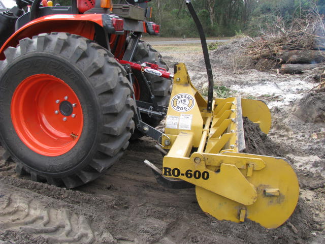

OP AGAIN - THANKS TO ALL WHO CONTRIBUTED TO MY POST​
I have installed and removed my 630 pound Rollover Box Blade numerous times in the last month, utilizing posted suggestions. Amazing....I can now whip it on and off in just a couple of minutes with NO bad words and NO sweat.
Obviously, technique is key and I had not been able to evolve satisfactory technique on my own. Perhaps a case where frustration breeds further frustration.
On my own I discovered it helpful to stake the lift arms, spread at the appropriate width, by tapping a couple of pieces of re-bar into the ground, just short of the implement.
As my other implements go on and come off RELATIVELY easily, I am leaving my recently acquired "Pat's Easy-Change System" in its shipping carton for the present.
PARTICULAR THANKS TO:
CalG, Post #6, One support point in the front, not two + grease. Made scooting around 630 pounds nearly easy. MOST HELPFUL REPLY.
jmc, Post #10 Adjust right lift arm height with 3-Pt lifting rod turnbuckle. Why didn't I think of that?
radrock, Post #17 Use spray graphite. Yes, graphite is really helpful on the draw pins; superior to grease in this application. Here I have to insert two 3/4" (6/8") draw pins into their corresponding 7/8" holes on the 630 pound box blade. Tight fit, beaucoup inertia. As I have it, I used a small spray can of household lock lubricant. With second application the pins slid in/out much easier.
NAPA Auto Parts Stores sell graphite in spray cans, both wet application and dry application. Multiple types of graphite lubricant are available from amazon.com.
Thanks again, Everyone.

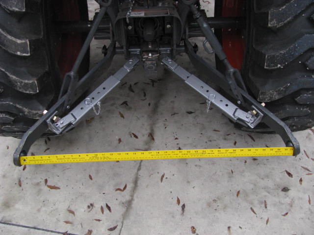

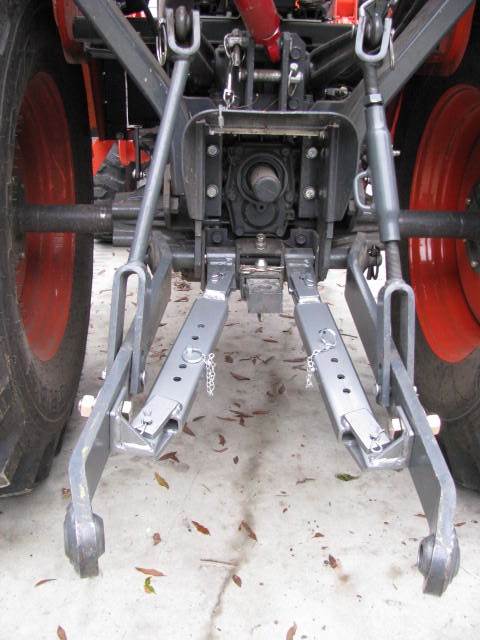

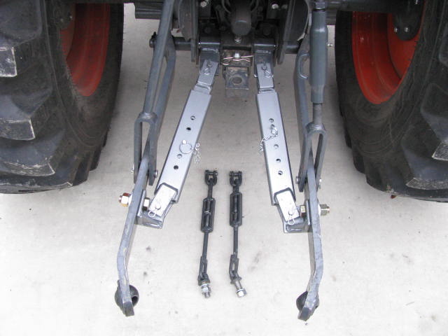

OP UPDATE
I have added <$200 Stabilworks' pin-adjustable, telescoping, lift arm stabilizers (Kubota still calls them check chains in the manual.) to my three point hitch.
I can attach 630 pound 'Bush Hog' Rollover Box Blade to draw pins in less than 2 minutes every time, while reinforcing the lift arms; another minute for the Hydraulink top link and good to go.
Kubota tractor stabilizers Kubota [url]www.stabilworks.com - YouTube[/url]
Note: rollover box blade is PUSHING loose dirt in reverse. Something I was afraid to do before reinforcement via Stabilworks mechs.
