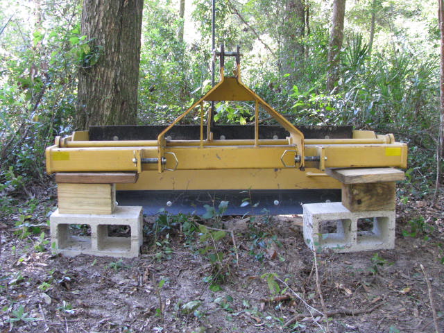

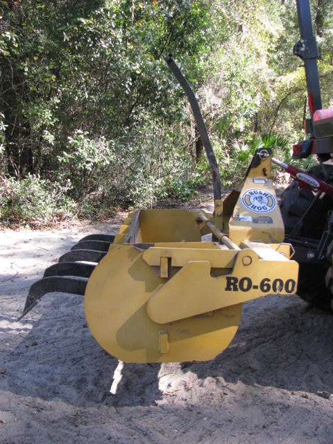

I have a new-old-stock 60" Bush Hog Rollover Box Blade. Good tool but more difficult to load on the 3-Pt hitch than my other implements.
Some of the factors which make attachment difficult: weight: 630 pounds, close fit implement draw pin holes/draw pins, ground settling under parked implement.
Draw pins are wiped off and newly lubricated with lithium grease before each attachment.
I can purchase a 2 ton capacity, 6" lift, hydraulic bottle jack at Walmart for $13, which should help vertical alignment, but I dislike the idea of another widget acquisition for use with a single implement.
I am hoping someone out there with a Rollover Box Blade has figured out a brilliant solution to loading same on the 3-Pt.
Mtnviewranch -- Guru of RBB's, are you out there? I wanted to PM this to you but could not attach photos.
I am 65 years old so brute force is in short supply. Tractor is a Kubota B3300SU package.

support the implement on three pads ONLY. two some what closely spaced under the blade, one under the center of front crossbar. That allows YOU (all 65 years of you, I'm 63) to tilt the tool without lifting much of it.
Use the concrete blocks and two layers of wood, but grease the the wood to let them slide over each other while carrying the implement weight.
My grandfather taught me to never lift more than 1/2 of anything heavy!
Let the tool do the work."Use your head, save your back" KISS

Flattery gets you no where. ;) We have 3 Gannon roll over box blades. All that I do is have a couple of 2x4s or 2x6s about 18"-24" long under the cutting edge and a 4x6 standing on end cut to the proper height to support under the tower. Pretty simple.

I may be missing something here but I don't see a need for a jack if one of your side links has a length adjustment. Just attach the fixed length side first then tweak the second side height as necessary with the crank.
Did you try sandpapering the inside of the ball holes that your pins go thru?
