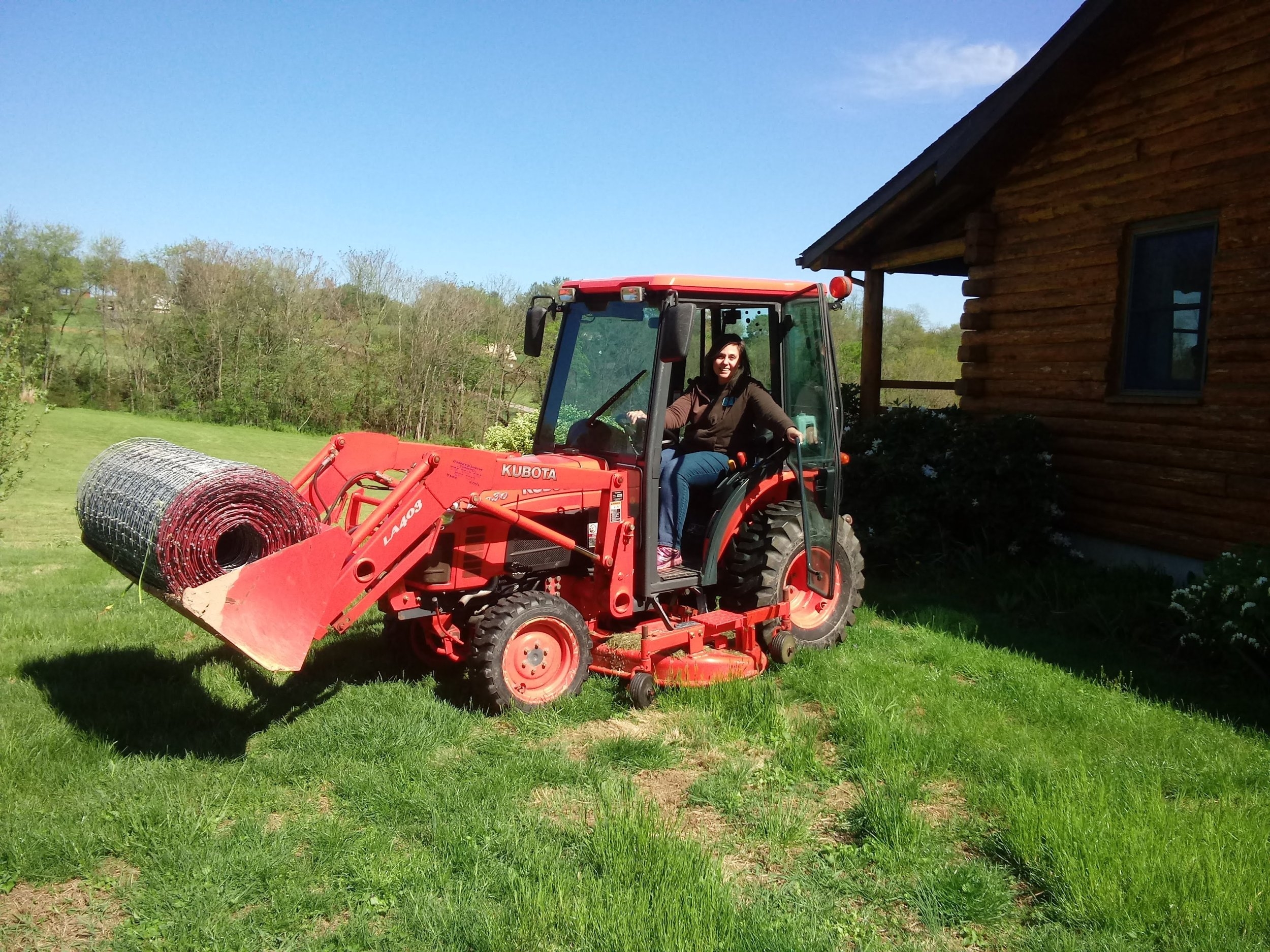

This post is not to criticize the safety minded out there amongst you. Far from it, as I'm a lucky guy that rolled his tractor and survived it four years ago. My issue is wondering whether the "respect" that the incident instilled in me is proportional to the actual risk. My Kubota B3030 was the first and only tractor I've bought. Total noob guy. I was backing while moving dirt, hit an unexpected mound of dirt and rolled. The built in ROP of the cab protected me, and the door glass contained me and prevented entrapment or limb loss. My first thought laying there in the shattered glass was turning the motor off (fire), then getting out. Once I was standing outside looking at the dead tractor carcass, I wondered whether any of my neighbors were out and had seen me due to the potential embarrassment. I was all alone. Then it dawned on me that I had no cell phone, my wife was away, and had I been trapped it would have been about a 5 hour wait for her to find me. Then the fear set in. Totally preventable. I think the root causes were ignorance of both proper technique and the risks, rushing, and overconfidence. I happened to have an excavator on site, so I just chained the Kubota and flipped it upright. To my surprise there was absolutely zero damage besides the shattered door glass.
To my point- now I'm so nervous on most of my almost exclusively non-flat property that I'm hesitant to use the tractor for many things. I think remember the spec on it saying ok up to 12 or 15 degrees, but the worst slope anywhere I'd encounter is 11-12 degrees and even that gets me really anxious. I think the spec is for a bare tractor, not one with a FEL, belly mower, etc. so it doesn't help me feel any more confident. I tried leaving the belly mower installed to lower the CG but it was interfering enough that I opted to take it off. Not looking for a how-to or strategies for transiting hills, counterweighting, FEL tactics, etc. (Now) I've watched all those videos, which is why I admitted my ignorance as a factor in my accident.
Did I buy the wrong tractor? (kind of a narrow front axle) Am I unreasonably cautious? Is there such a thing? I considered getting an alarm/inclinometer to at least let me know when I'm reaching the nominal limits, kind of as a training aid to better know when nervousness is called for. It's almost like a fear of flying scenario situation. so, alarm or therapy? That's the Mrs., not me.
