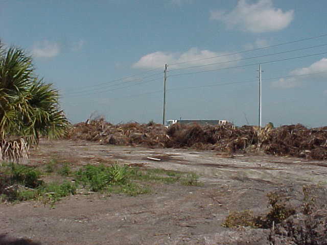

The grapple would be a nice addition. The stuff we were clearing included acres of wild grape vines which have a mat of roots. When raking them, a lot of dirt comes along. As a result, we couldn't burn the piles - too much dirt. We ended up moving all of the piles (over 45 of them) to one spot (a row about 200' long) for subseuquent burial. Not having a dump truck or trailer, I moved all that stuff one rakeful at a time - took almost 5 days. I got very familiar with the Cat in that period! A grapple would probably have cut the time in half because each payload would have been greater.
The attached picture is part of the row of brush after it was moved...

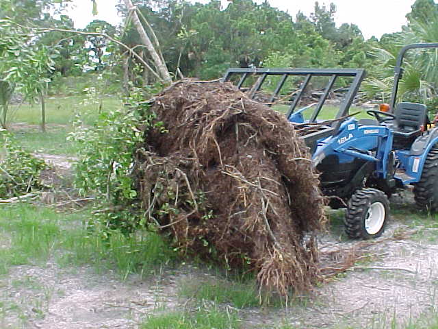

Rolling works good, too. As you start to pick up a load, let the rake (or bucket) "accidentally" roll over the top of the pile, and everything underneath kind of rols with it, losing dirt in the process. We also used the pick up-and-drop method; works good with trees and brush with defined roots.
But, those grapevines - learned to hate 'em. Here's a shot of what they look like from underneath...
After several failed attempts to burn them (and using enough diesel to travel from here to there in the process), we picked out a nice spot far away from any buildings or landscaping improvements and are going to bury them. We're just waiting for the property to dry out enough for the contractor to bring in his track hoe and dump trucks. Interment of the brush comes first, then a pond. Just had another 6" of rain pass over the area in the last few hours - looks like another couple of weeks of waiting.

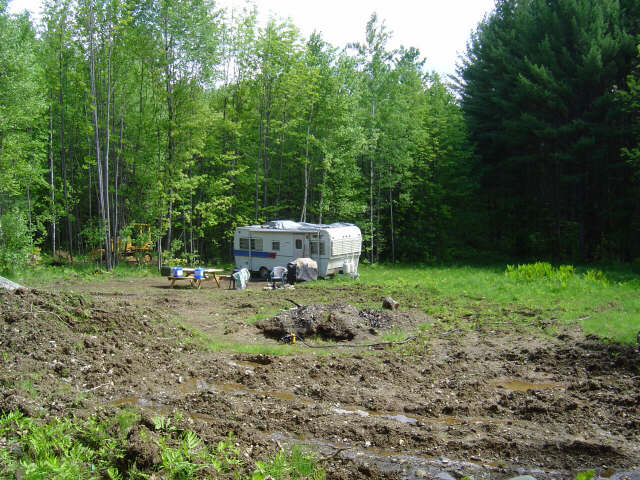

Just got back from spending two weeks on my property. I think it rained the entire two weeks. If not, it may have just seemed that way. The culvert that feeds the runoff onto my property was pretty much silted up but it was still pouring water. The picture shows what used to be my fire pit in the center of the field. That's a pump in front of it. Pumping it out was pretty much an exercise in futility. When things dry out this summer I'm going to install the drain and cistern.
