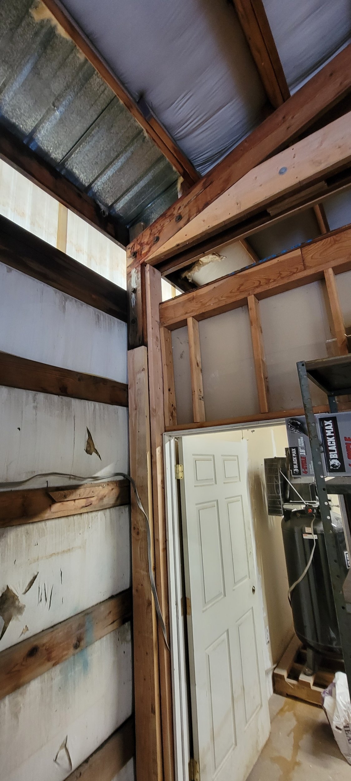

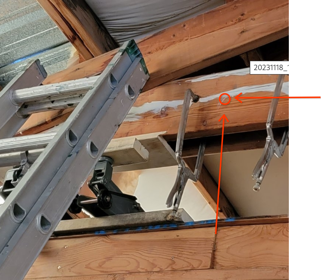

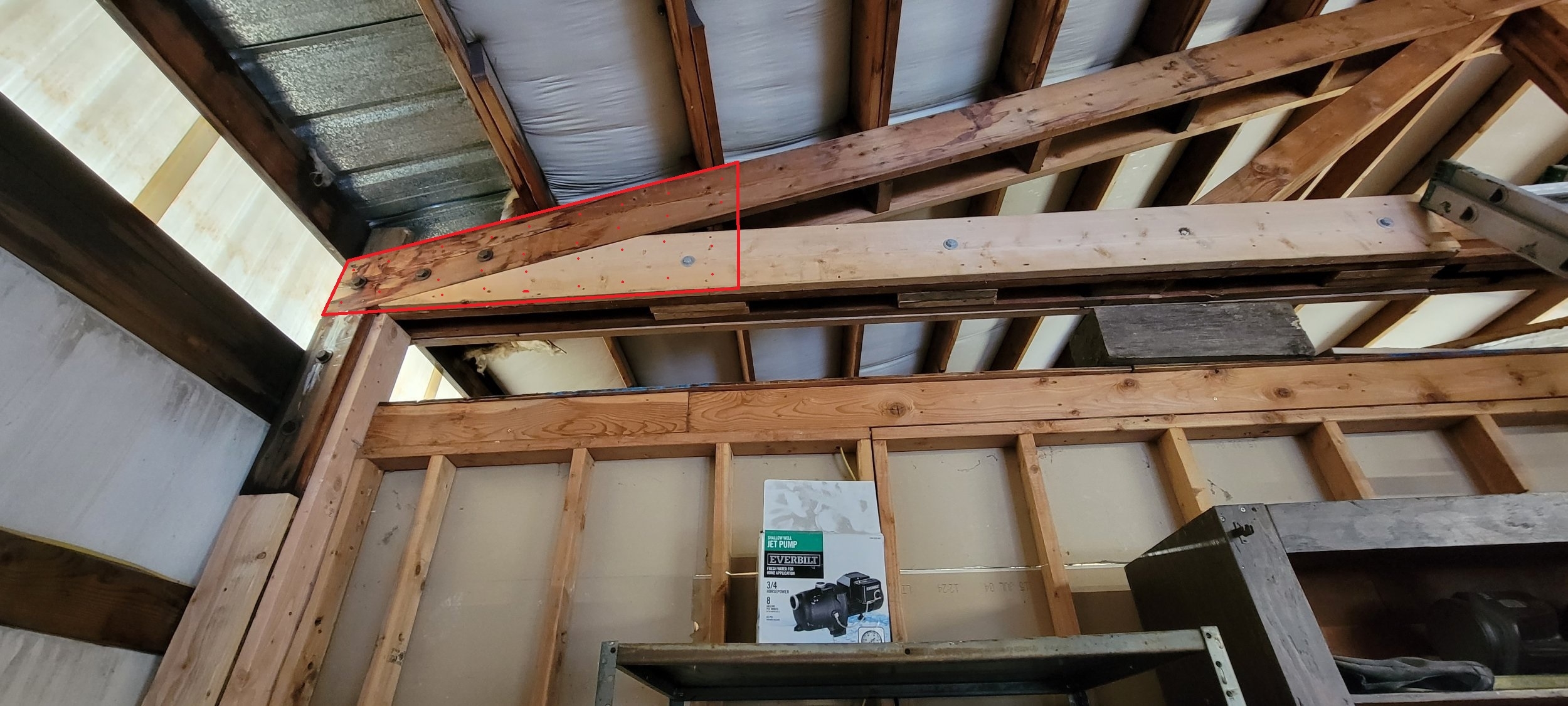

I personally wouldn't bother with an engineering review. What are they going to tell you? That the trusses suck? You already know that so why bother spending the money.

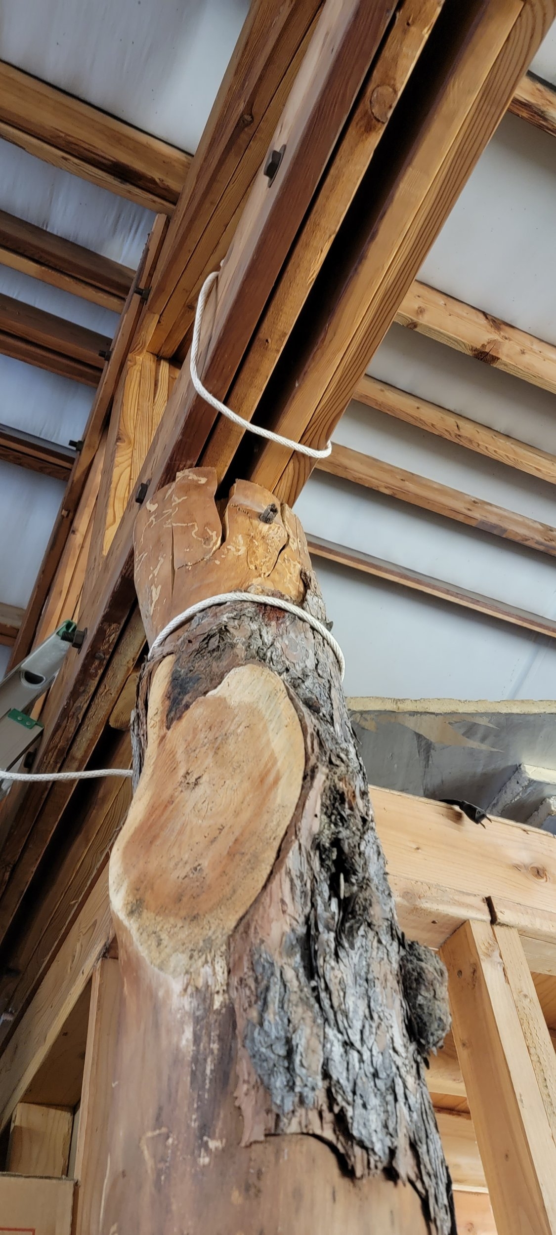

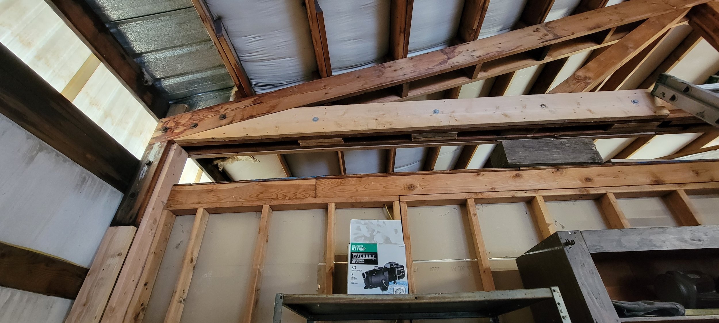

After some of the comments here and after having a good second look at the pictures I've changed my mind. You could replace/repair the broken parts but you still have a truss that sucks. The way they are bolted together is just an invitation for future problems. I can well imagine that someone thought they were building a super strong truss by bolting it all together but all the bolts are accomplishing is to concentrate all the forces onto a small portion of the wood. A good example of this is how the peak is overlapped and bolted together. Each side of the roof "truss" should be butted against each other, not overlapped and bolted. If you enlarge the picture and closely examine the truss you can see examples of poor design all through the truss. Joints overlapped and bolted where they should be butted and joined properly is just one example along with others mentioned by previous posters.
I believe the owner is going to have to come up with a plan to replace the trusses with something that will last or remove the roof and start over. Anything less will over time result in a collapsed building. The only other solution would be to add posts to hold the roof up but really that's only a mediocre band aid.
I can see an engineer looking at this and recommending a way overbuilt solution just to cover his/her butt. Not because the building needs it but just because! But truth be told what you really need is to replace all of the home built trusses with engineered trusses that will properly transfer the forces involved to the posts.
I would be very careful about getting an engineer to examine the building. You don't want them to all of a sudden complain to a zoning/permitting authority and have the building condemned. Just because!
You could take the pitch of the roof/span/rafter spacing information etc. to a rafter manufacturer and have them build you proper rafters. It also wouldn't be a difficult job to remove one rafter at a time and install an engineered replacement. The way the building is built you could prop up one rafter and replace it and then prop up the first rafter and replace the second one. It would really help to have an experienced contractor with that part though.
These are my thoughts on the subject based on what I see in the pictures. If I saw the building in person I could very well think differently. And ya I'm kind of hard on engineers but that's another story.
