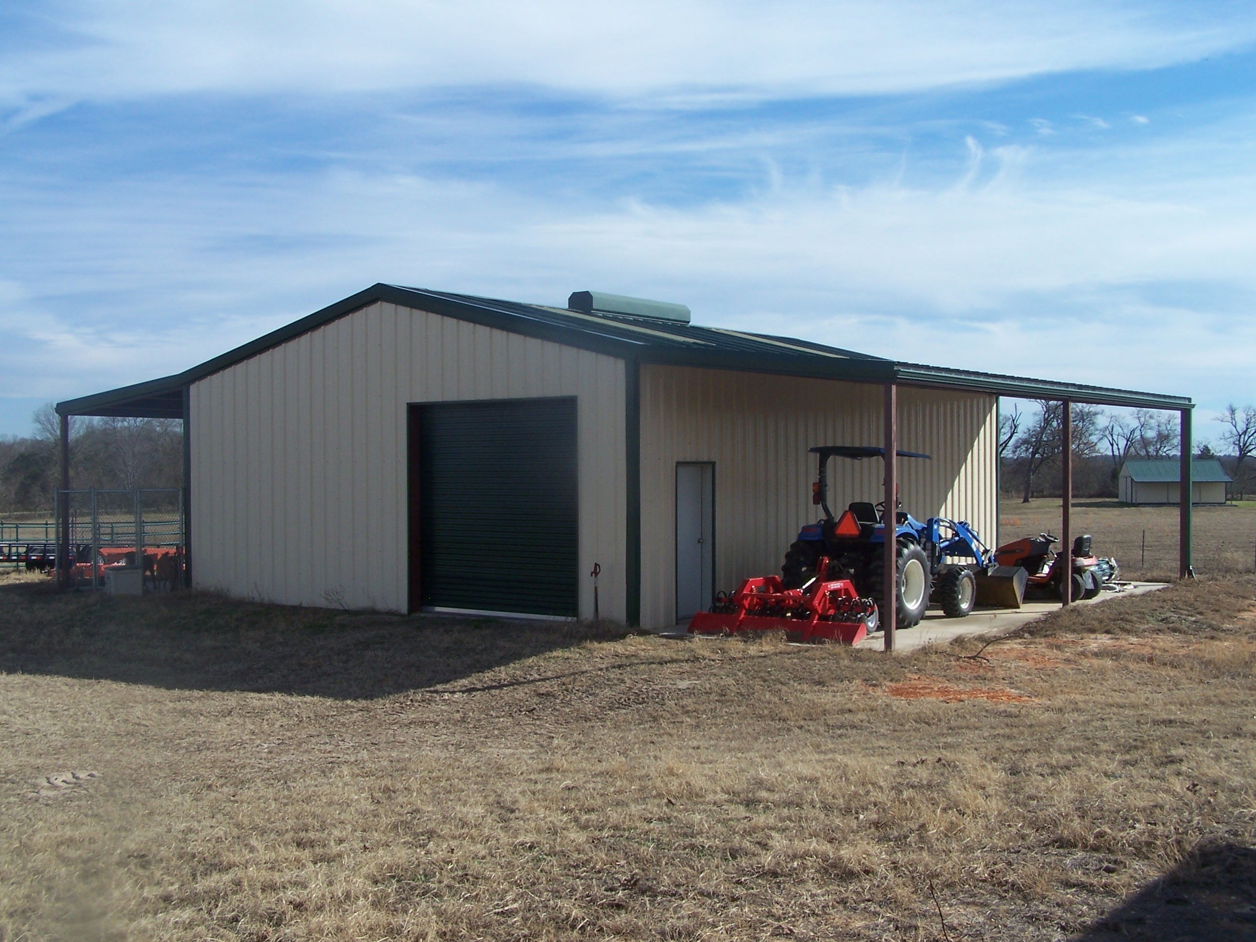

I prefer the 4:12 pitch for the look. Our shop has 4:12 pitch main roof with a 1:12 pitch for the 12' lean-to on each side. Have not had a leak in 12 years it has been up. Snow load is not an issue in East Texas.
