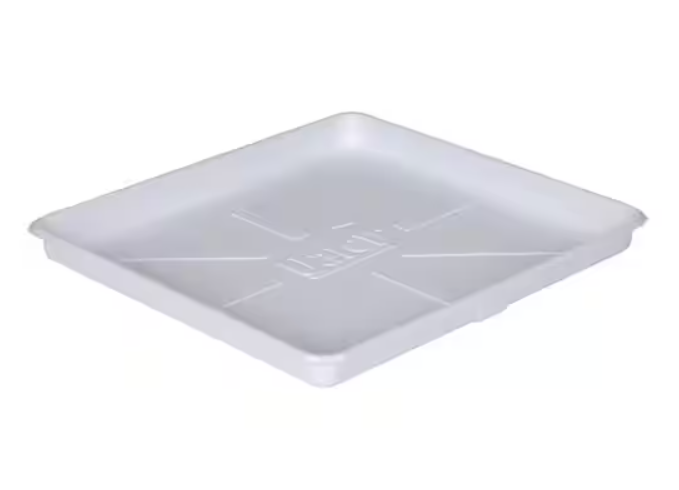

When I built the house, I purposely didn't install a ridge vent due to the rain / snow issue. It's very windy here and I had heard of too many problems.
The 15 year shingles I used, lasted 25 with no heat or condensation damage. When I had the roof replaced, I used 40 year shingles but the warranty required a vented ridge. The roofing contractor installed one and, sure enough, rain & snow started blowing in. It soaked the insulation and stained the drywall ceiling. I tried blocking the vent in a variety of ways but with little success.
Finally, I bought a few of these shallow plastic pans you put under washing machines.
I laid them on top of the insulation under the spots where the precipitation blows in. I know it sounds stupid but it's worked perfectly for over 10 years. The rain/snow collects in the pans and evaporates over time. There has never been an overflow in all that time.
