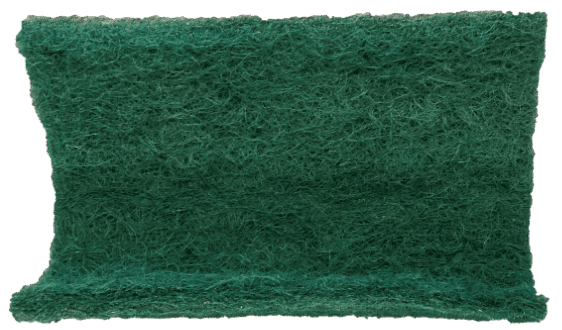

You want to block the snow, rain, animals etc. from coming in.
Normal insulation (foam, fiberglass, etc.) would probably be too dense to allow air flow.
"Hog's hair" or "horse hair" (linky) may be better. It could stop most stuff (rain, snow, hail) and (if not edible) small rodents etc. Yet it should still let air flow thru.
Coincidentally I just received about 6 square feet of the stuff as packing material in shipping packages this last 2 months.
