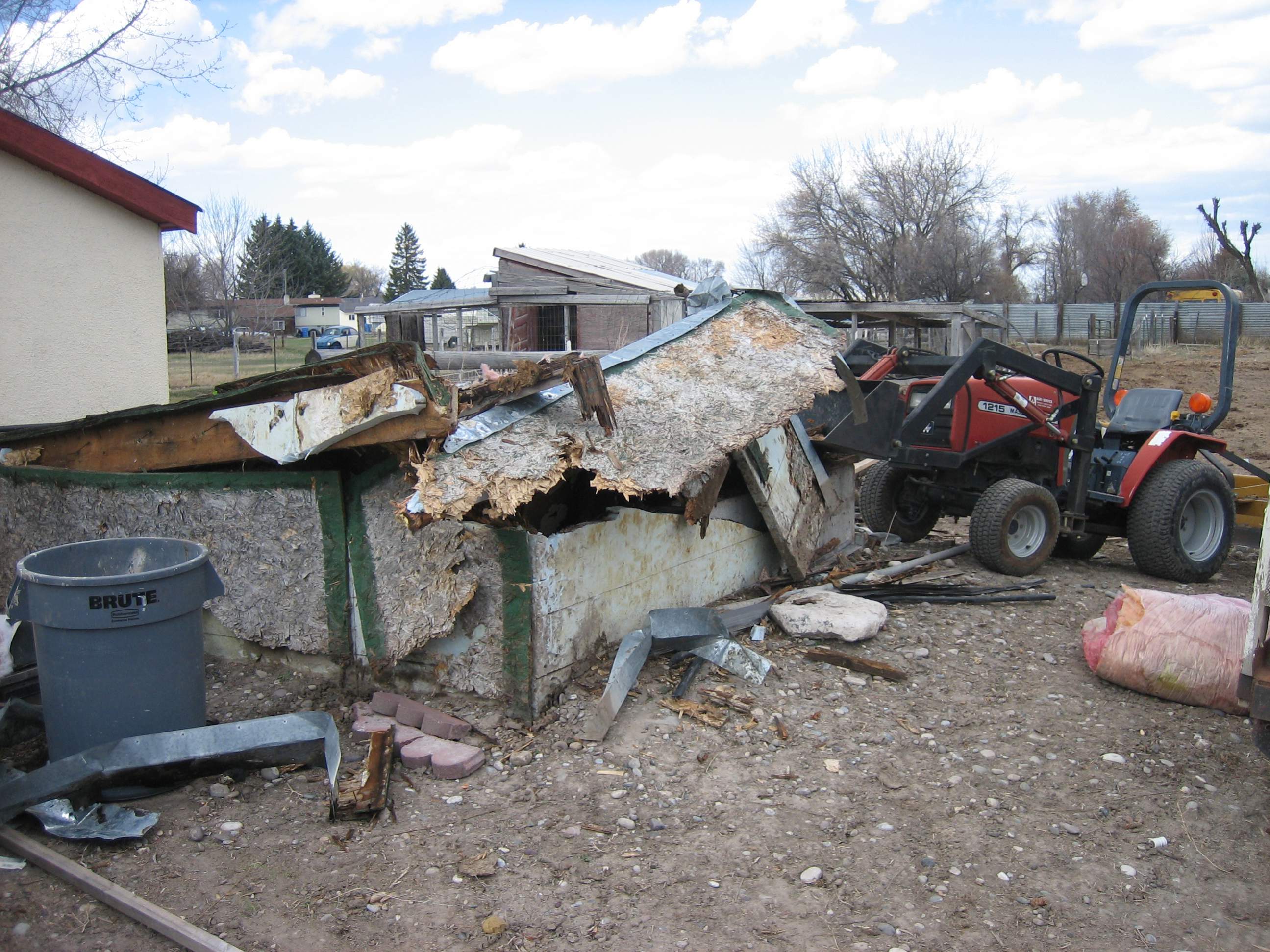

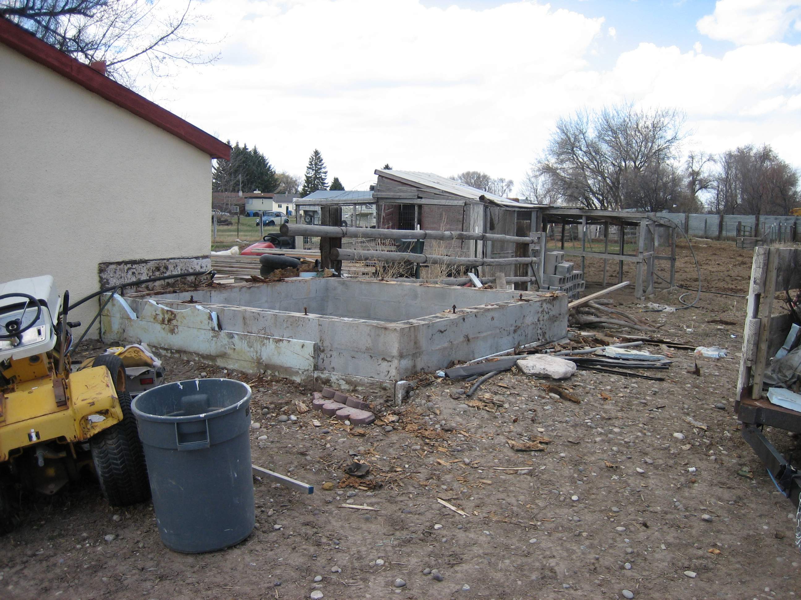

Phase 1: Demolition
I had visions of removing the old roof one piece at a time and neatly stacking the pieces on my trailer to haul it off to the landfill. After 20 minutes I had removed one piece of flashing. So, I fired up Little Red and 20 minutes later I had the whole roof off. I'm in the clean up stage now. Most of the big pieces are on the trailer, but I have a lot of little debris that I still need to clean up.
See below for some before, during and after pictures.

Sounds like a good project. One thing I'd be careful of is possible frost heave of the foundation of your root cellar. If you expose the foundation of the root cellar to freezing air temperatures, you could get frost heave. I'd make sure you seal the new ceiling of the cellar really well to keep it above freezing down there. It looks like the foundation wall is pretty well insulated in the photo, make sure you repair that insulation to help keep the temps up.
   / Root Cellar Remodel, Split Level Storage, Shop, Shed Pole Building on a Foundation
Thanks for the tip. I do plan to insulate the foundation. We'll sometimes get below -40 and stay there for a week or so in the dead of winter. If I'm going to keep my paint from freezing, I'll have to insulate really well.

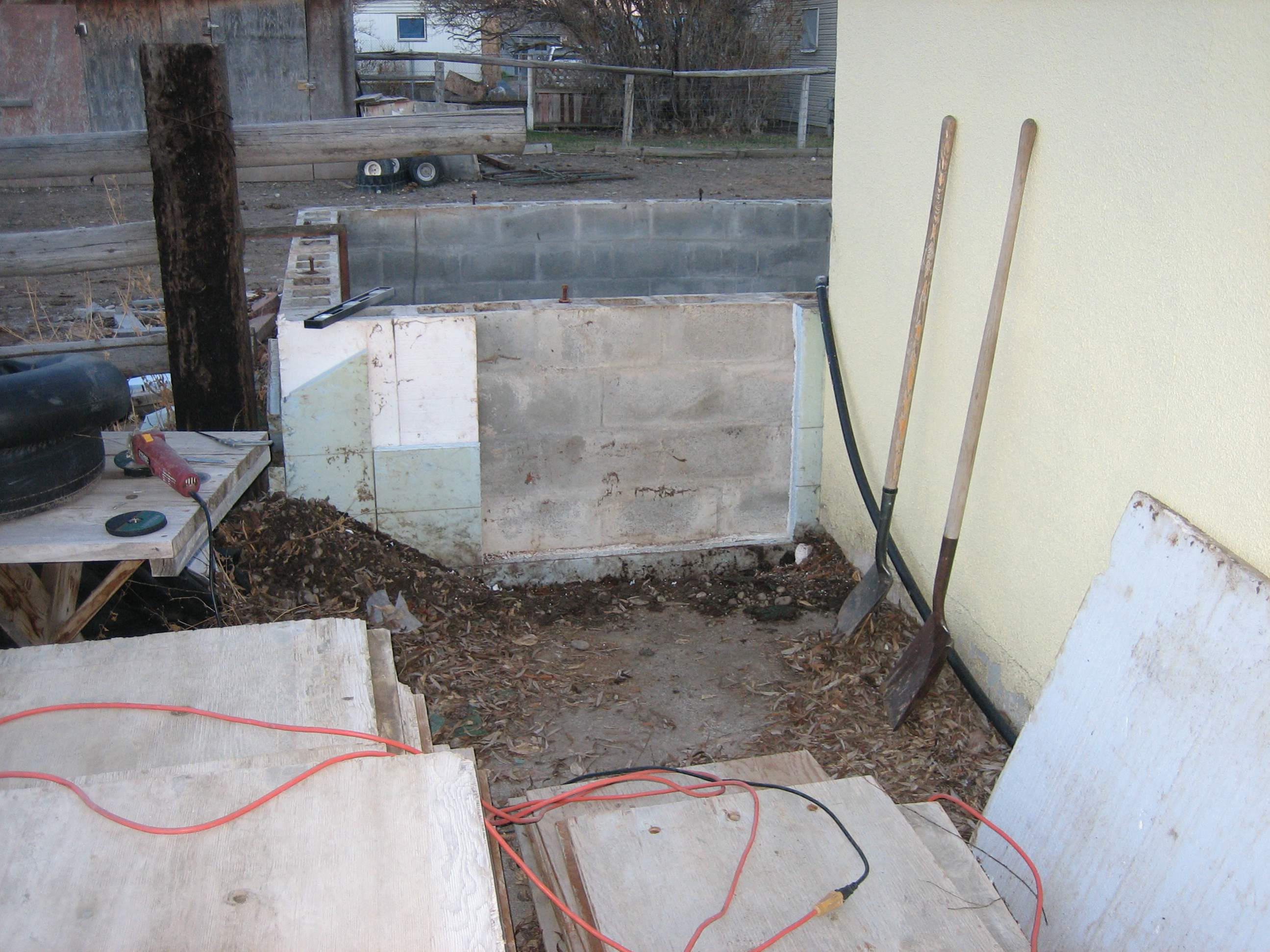

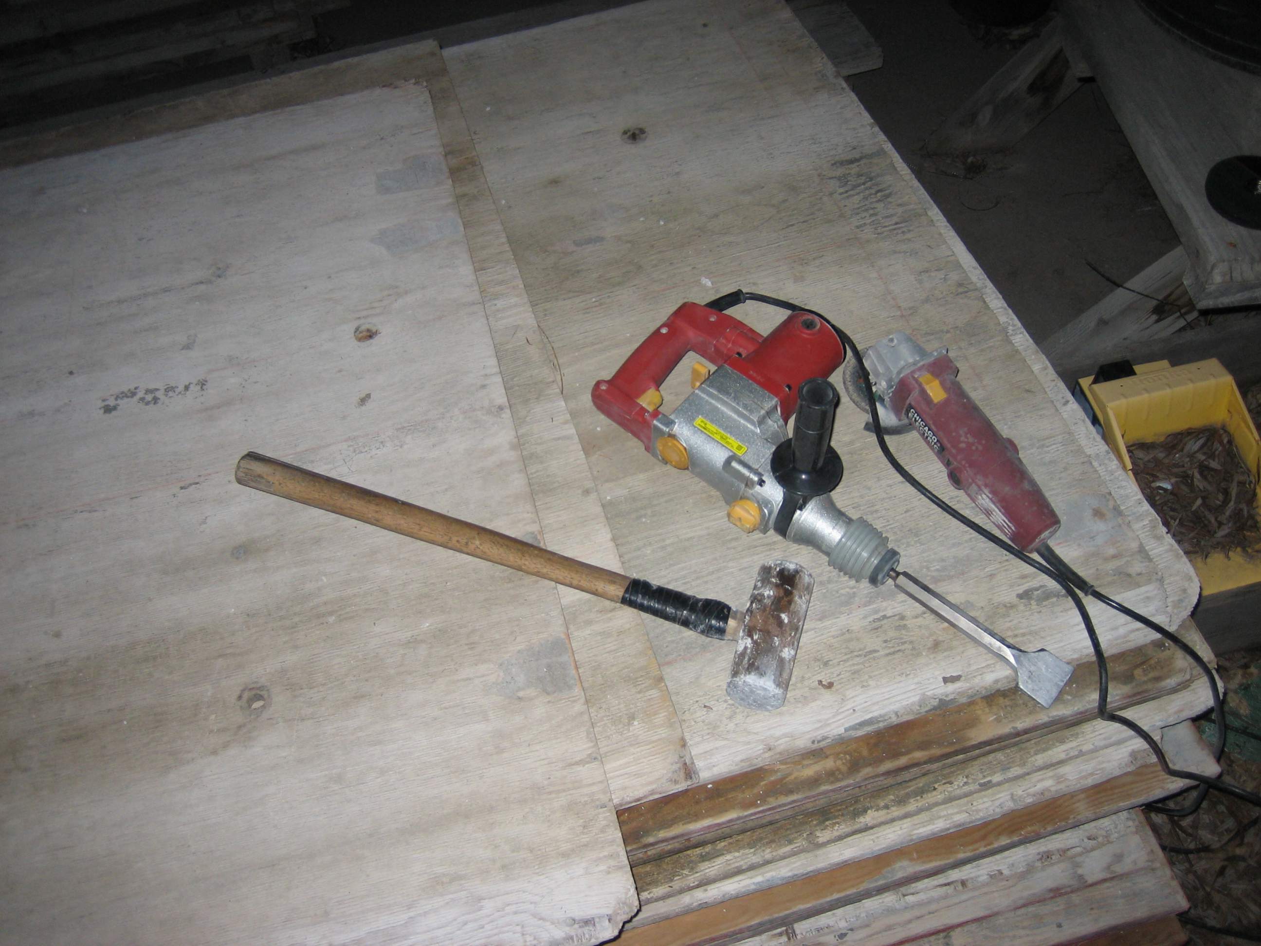

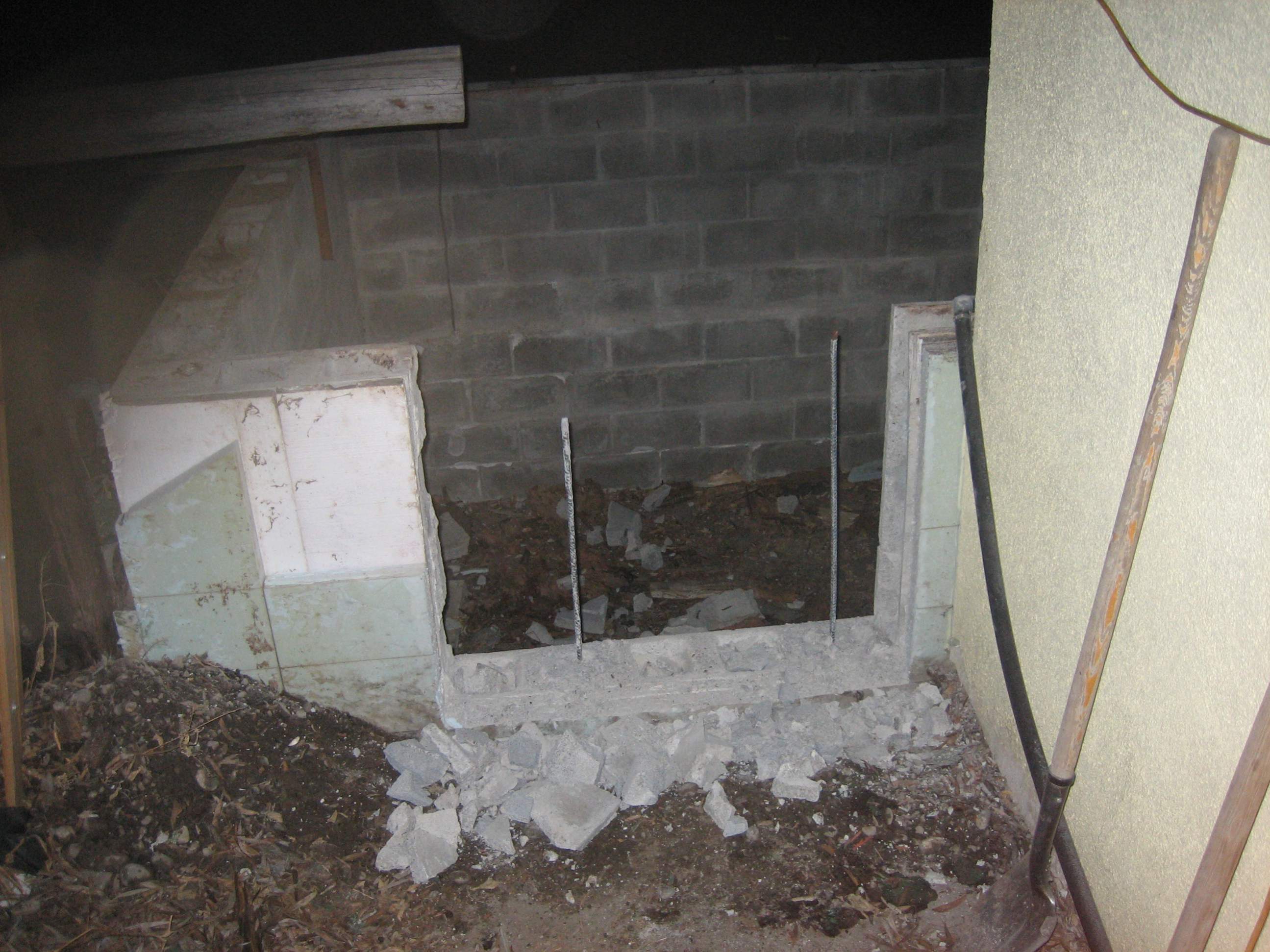

I'm still in the demolition phase. I cut the brick out of the old cellar where I want the door to go. See the before and after pictures. I did it all with a Harbor Freight angle grinder with their masonry blades, a Harbor Freight rotary hammer, and a sledge hammer. I'll have to go back tomorrow when I have some daylight and clean up some of the rough stuff left in the middle on the right side. I'll also cut off the rebar.
Sad story, too. I got a measuring tape from my kids this last Christmas. At one point when I was measuring to mark my cuts I put the tape up on the top of the wall. The tape fell into one of the cavities in the brick and went all the way to the bottom. It's there forever now. Sad Day.

If you've got a strong magnet, tie it to a rope and drop it down the hole. You might be able to fish the tape out...
Just a thought...
Just a thought...
I may try that. The tape has a plastic houseing, but I may be able to grab the hook on the end of the tape and get it back that way.
