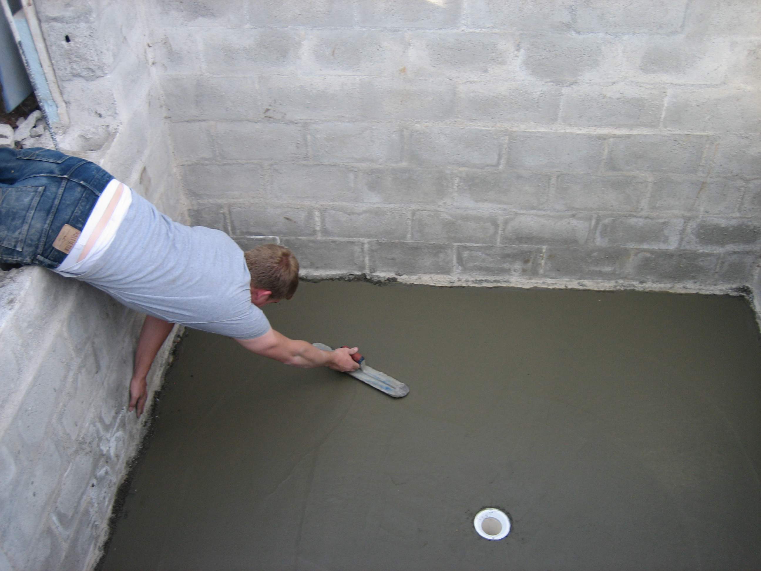

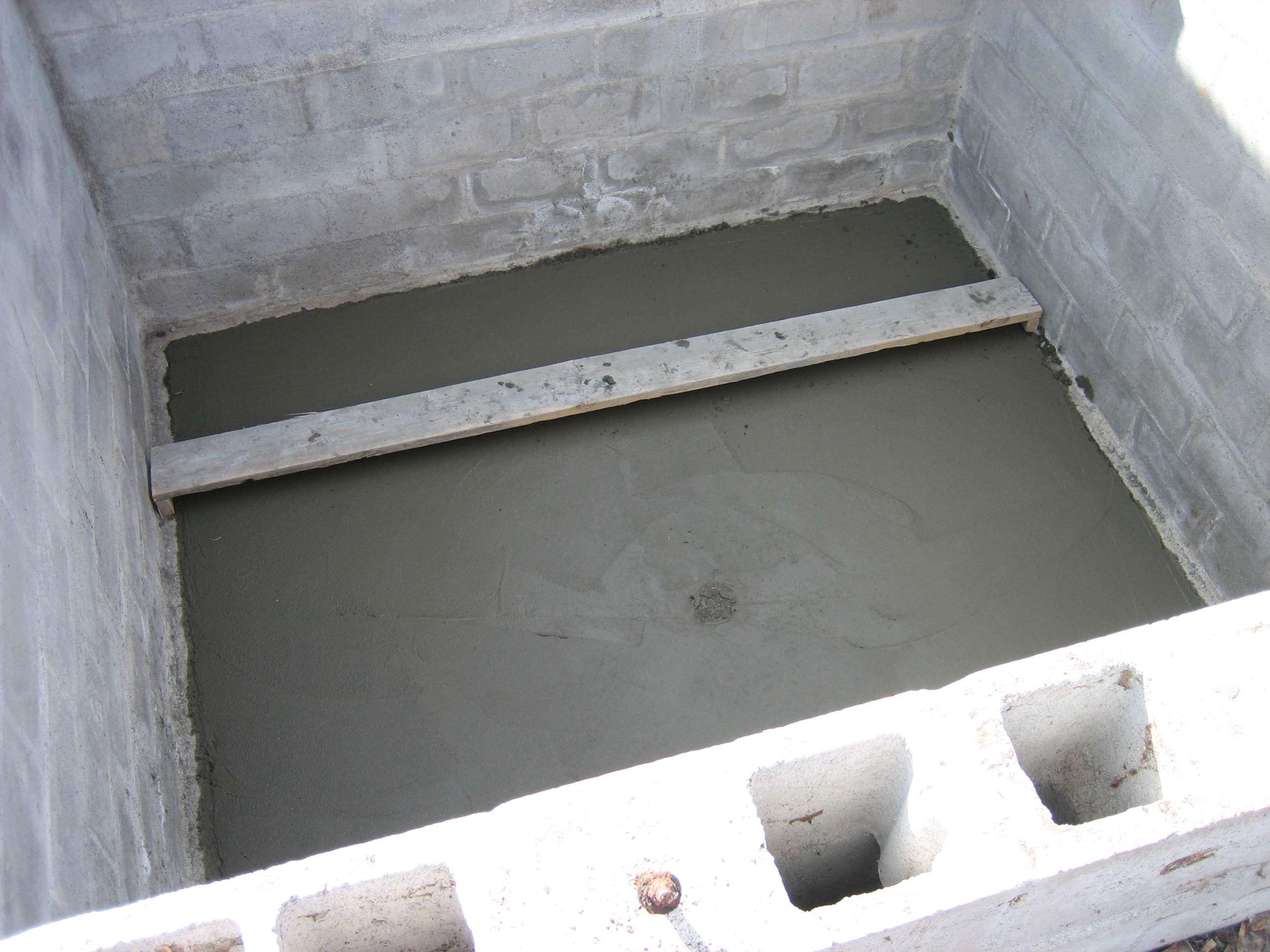

#23
Yesterday was concrete. I am SOOO glad to have friends who are so willing to share their time and talents. This friend of mine brought his two sons who have been helping him do concrete since they could hold a shovel. It was like watching a professional dance team watching that crew work together. I was in the hole with them moving mud around, but I don't think I really made the job go any faster or any better. I sure learned a lot, though.
I gave the camera to my 10-year-old to document the day. Here are a few pictures that help show the process.
Pic 1 - This is a shot of the trialer that I rented to do the concrete with. I bought 1 yard and it was the perfect amount. We didn't have any left over, and we covered the floor perfectly.
Pic 2 - One of the biggest challenges to this job was working in a hole with nowhere to stand. I rigged this bridge out of a board with a standoff on each end. This gave the guys a place to kneel while they were floating the surface.
Pic 3 - Once again managing the challenge of dealing with a concrete pad that is 3 feet below the surface with no real exit. In this picture you can also see a good view of the drain.

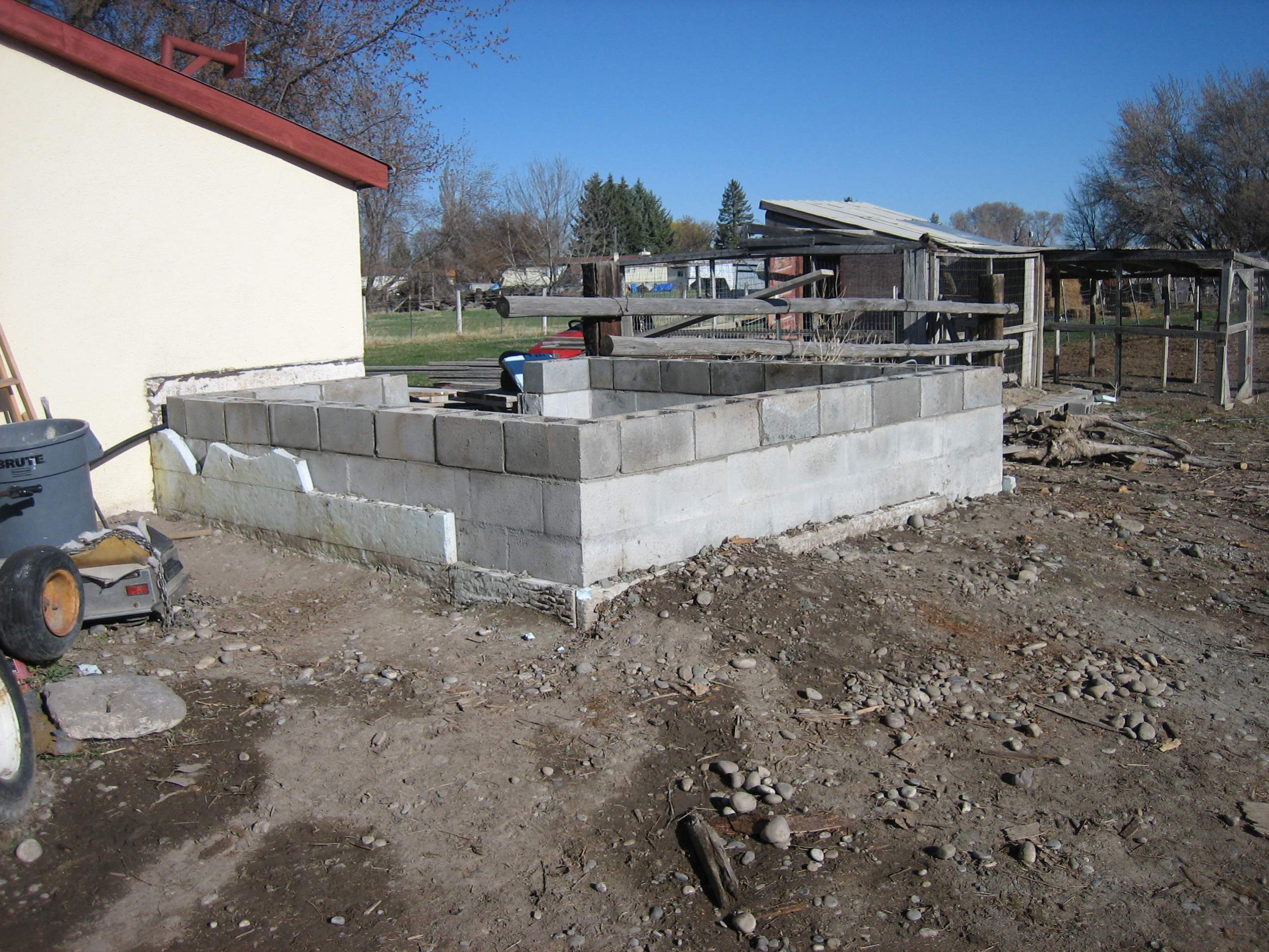

I got rained out yesterday before I could lay any brick. The next opportunity will be Saturday.
   / Root Cellar Remodel, Split Level Storage, Shop, Shed Pole Building on a Foundation

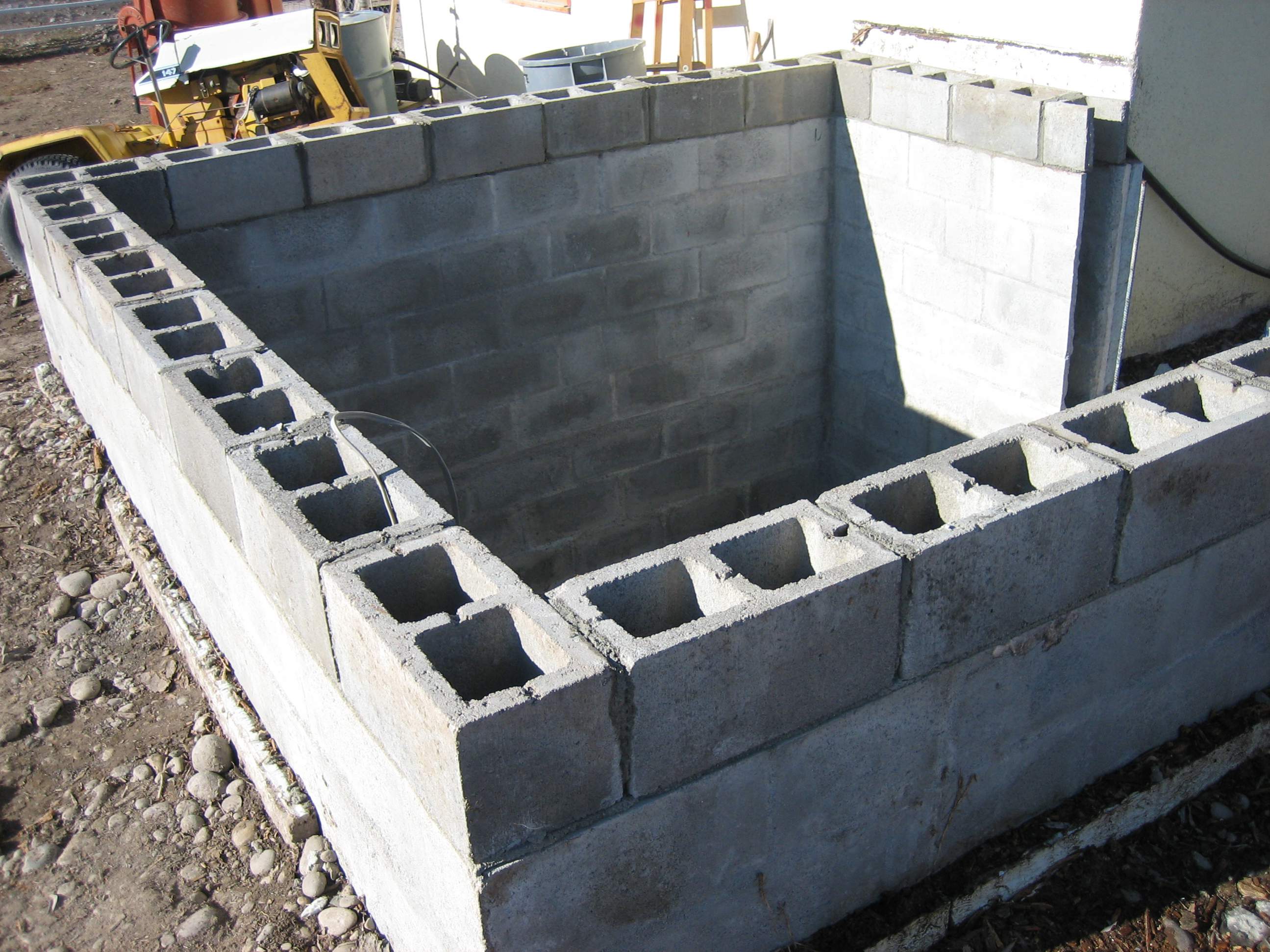

#28
I found some time last night to lay the brick. I'm really bad a laying brick. I watched a lot of Youtube videos and read a lot of stuff, but nothing was working like the videos and articles described. In hindsight I think I may have had the mortar too stiff. The other concern I have is that the online calculator said I need 3 bags of mortar for 25 blocks. I didn't even use the mortar from one bag.
I think that if I can do a good job on anchoring the j-bolts so that they borrow strength from the bolts below I'll end up with a good structure.

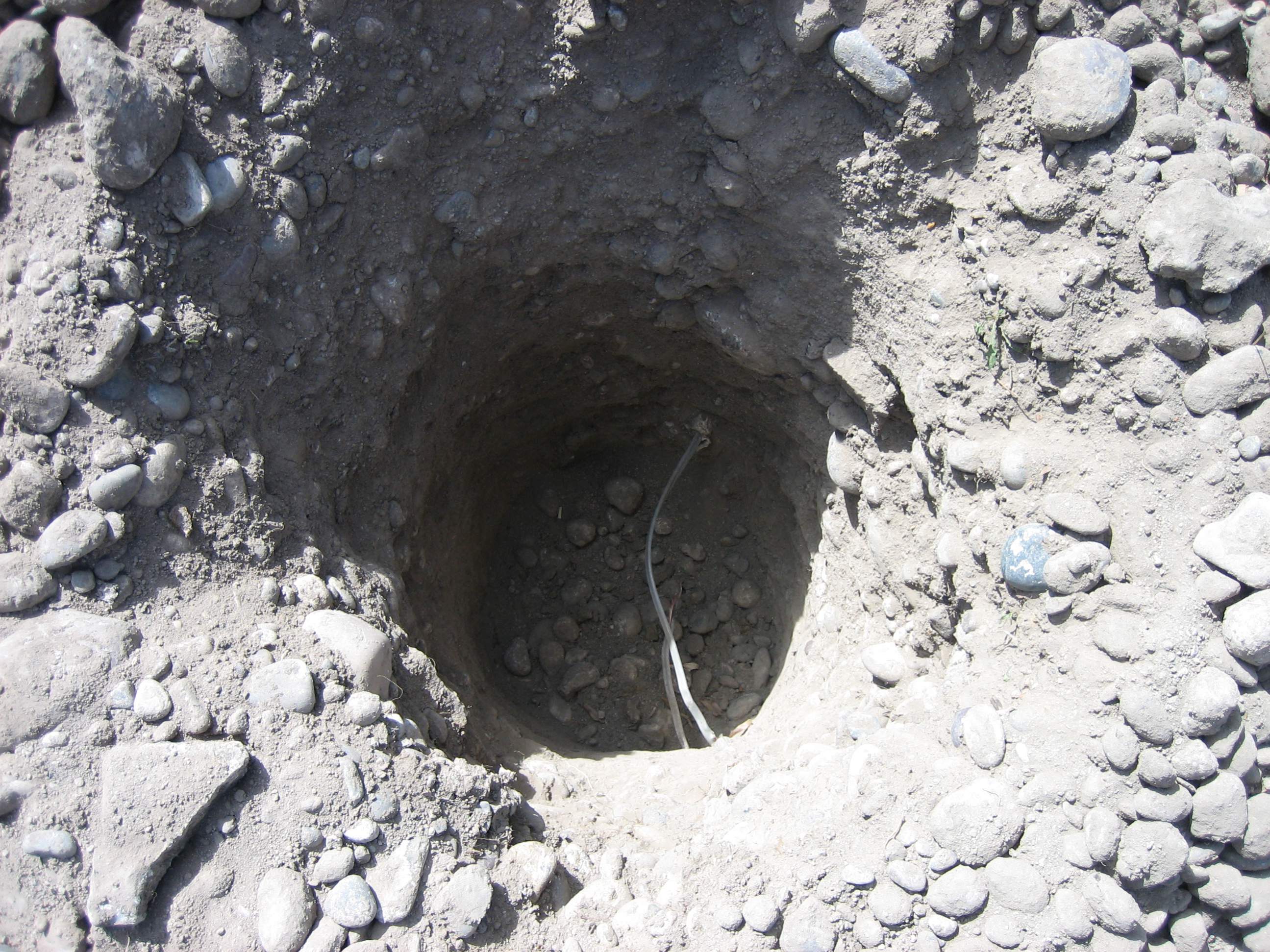

#29
I learned how to do an underground splice today. There is a wire that goes from the old root cellar underground to another outbuilding. I knew it was there, but I got caught up in the process of marking out my support posts and neglected to check if I was going to clear said wire. I didn't. I pulled the auger up after drilling the hole, and there was a section of wire wrapped around the auger.
Lucky for me, I was able to pull enough wire through so that I only had to do one splice. The attached picture is of the wire in the bottom of the hole after I pulled the extra wire.
If anyone was wondering, the hard part of an underground splice is standing on your head to do it.
