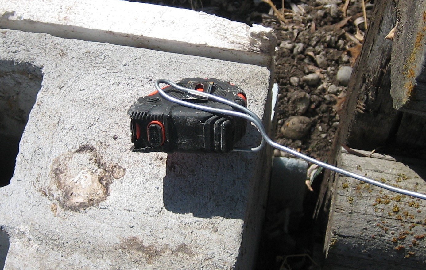

I've been playing instead. Today turned out nice, so I hauled my tractor down the valley to my parents place and tilled their garden. Then I hauled the tractor up the valley to one of the fire department commissioners and tilled the front of his property so he could expand his lawn.
I did switch the tiller for the post hole auger after I got home so that I can drill the holes when the time comes. And...
I retrieved my measuring tape!!
I tried the magnet on a string trick with no luck. Then I got the crazy idea to bend a little clamp out of wire and see if I could press it over the tape. I had to stick the bent wire and a 2X2 board down the hole to push the clamp onto the tape, but it worked. Now I can measure where the post holes need to be.
My Brother in Law brings me his cement mixer tomorrow. Next week should be a good week to show progress.
