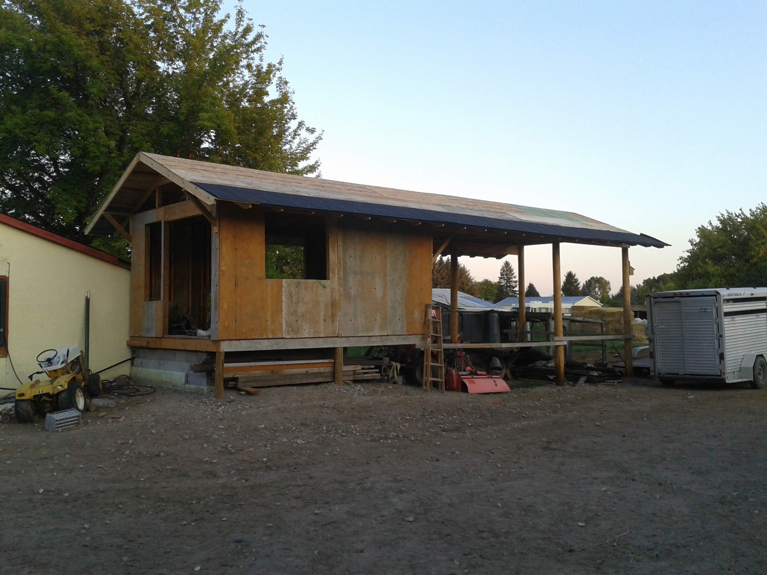

I got the first row of tar paper down last night. Here's hoping it doesn't rain today. Before I put down the tar paper, I went over the roof and put the rest of the nails in the plywood. We were in a hurry on Monday so we only nailed the corners on some of the sheets. I also put up the drip edge on one side. By the time I got this first piece of tar paper down it was getting pretty dark. I hope to squeeze some time out of my schedule tonight to get the rest of the tar paper down.

Another vote for an gable/attic fan. It's a shop, so flip it on when your out there and leave a window open when your not. Looks good and 3/4 ply on the roof?...wow most around here use 1/2", but there is no real snow load.

Most around here use 1/2", too. 3/4" is what I had from all of my surplus scrounging. I had to buy a half dozen or so sheets to finish the job, but I figured 3/4" would give me a sturdier structure in the end.

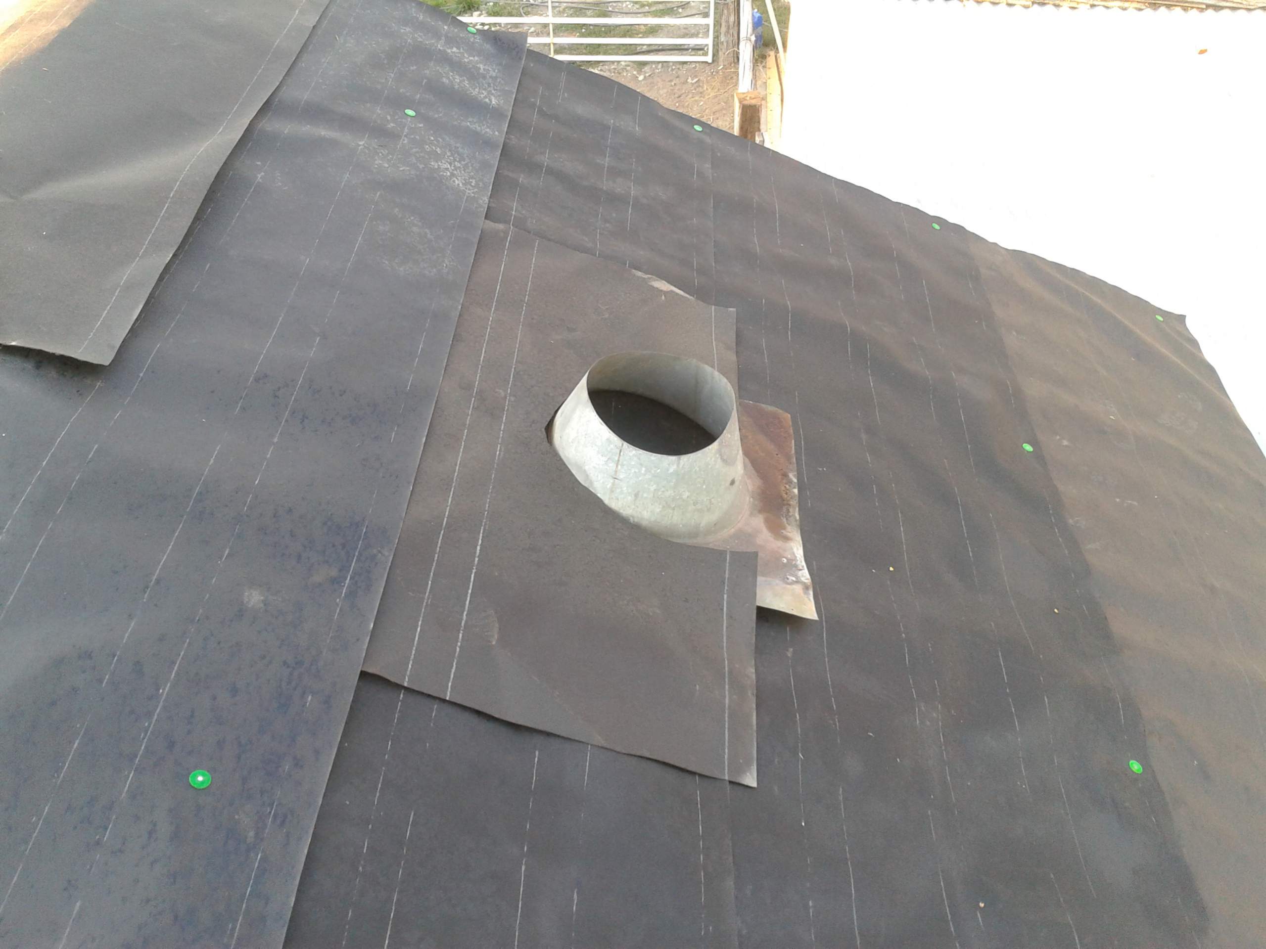

I have a roof flashing question. Do I put the tar paper under or over the chimney flashing? I've seen all the instructions for how to add roof flashing after the roof is already installed, but I'm not sure if there's a better way to do it if I'm constructing new.
This is a very informative website for roofing.
http://www.nrca.net/consumer/types/asphalt.aspx#flashings
This is the section dealing with pipe penetrations.
[http://www.nrca.net/consumer/types/details/asph-8.pdf
To answer your question, the felt / tar paper underpayment should be applied first. You can't go wrong with this approach. That said, there are instances where you would want to apply a water / ice dam material over the flashings, but on top of the underpayment. (Low slope roof edges in northern climates; skylights, etc)
Hope this helps, and I tried to wait a bit to let others chime in. Perhaps I need to get a life :)

Here's what I did... I put the felt paper down first, and then put the flashing over it. THEN, I put more felt paper over the flashing, but tucked the top of the extra felt paper under the row of felt paper above it. See the attached picture.
I've made more progress since this picture, but I'll post details later. For now I need to get out and do some more work.
