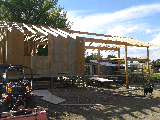

I did pretty good this morning, but then I got rained out after dinner. Here is a picture of this afternoon's progress. I didn't get much farther than what you see in the picture.
I guess that we'll have to do some more framing on Monday before we sheet the roof.

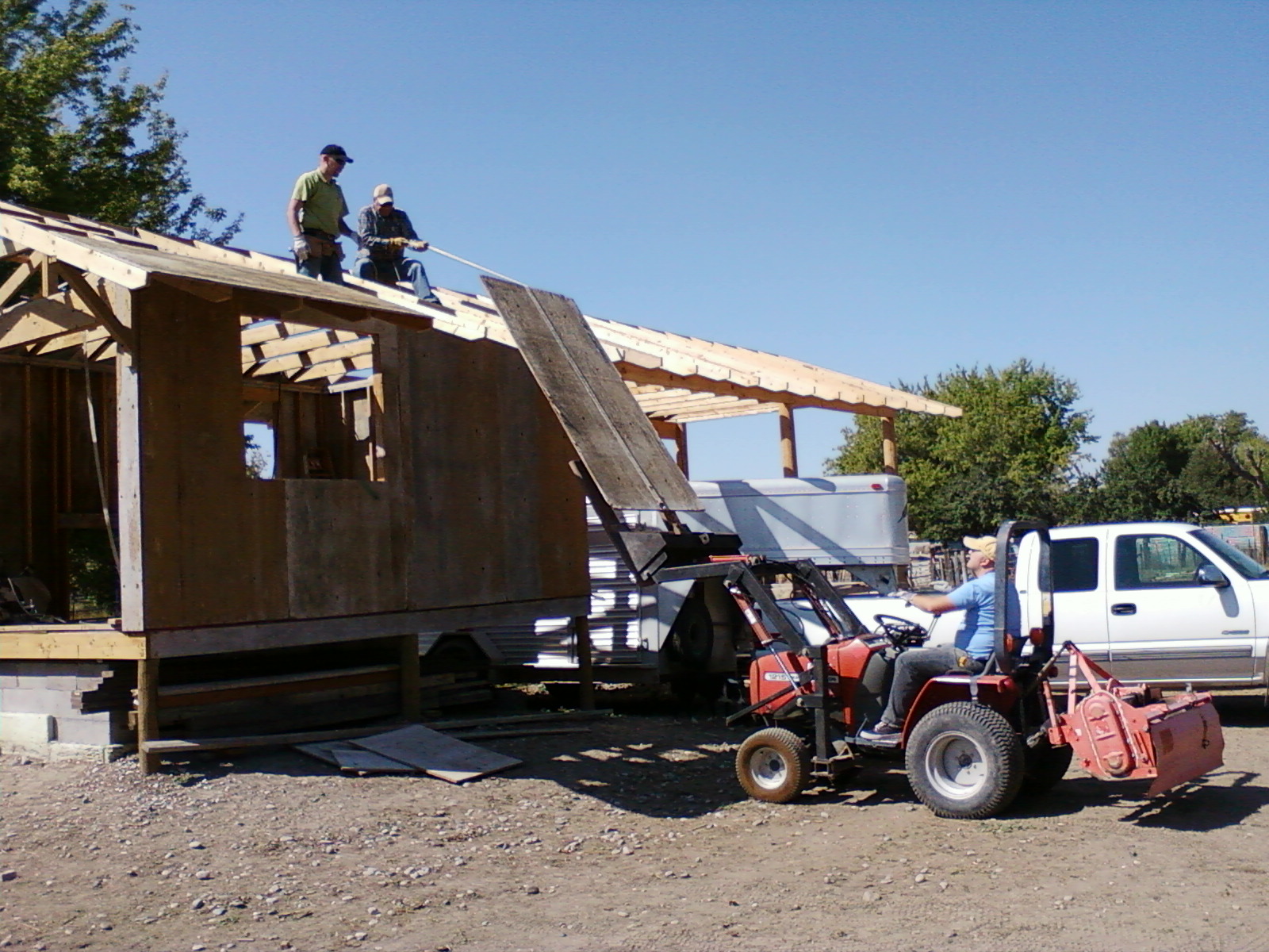

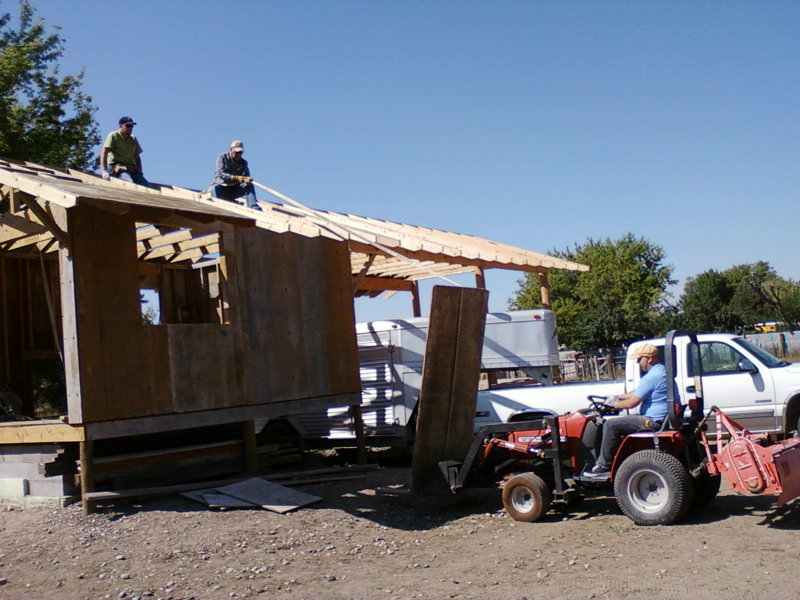

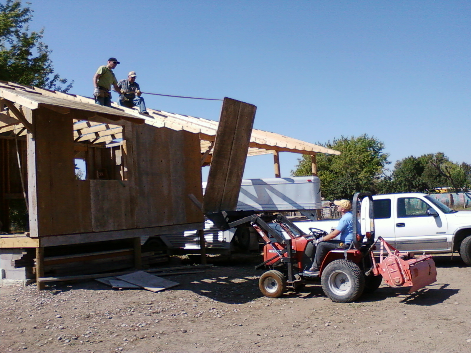

I wasn't quite sure how we'd get the sheets of 3/4" plywood up onto the roof. We learned quickly that lifting them up by hand wasn't going to work for the whole project. Between the three of us we came up with the system illustrated in the pictures below. Laugh all you want, but it worked VERY well.
I have some makeshift wooded clamp on forks from a previous project. My brother was on the ground and he'd set a sheet of wood on the forks and put the hook of a strap over the bottom of the sheet. We'd lean the sheet back so that the top was supported by the weight of the wood leaning against the strap, and my brother would lift it up as far as my little loader goes. Then one of us would pull on the strap to lean the sheet against the rafter tails and keep pulling to get the sheet up to where the other one could comfortably grab it and set it in place. The first row on each side was pretty slow because we had to measure and place each sheet. The other two rows on each side went surprisingly fast.
You may also notice my moving scaffolding in the background behind the truck. It doubles as a horse trailer. That made a nice platform to work off of. It put me at about the right height when we were setting joists and rafters.
It was an amazing day's work, and I'm very pleased with the progress we made. I owe my dad and brother big time for the help today, and I owe my brother in law big time for what he helped me get done on Saturday.
