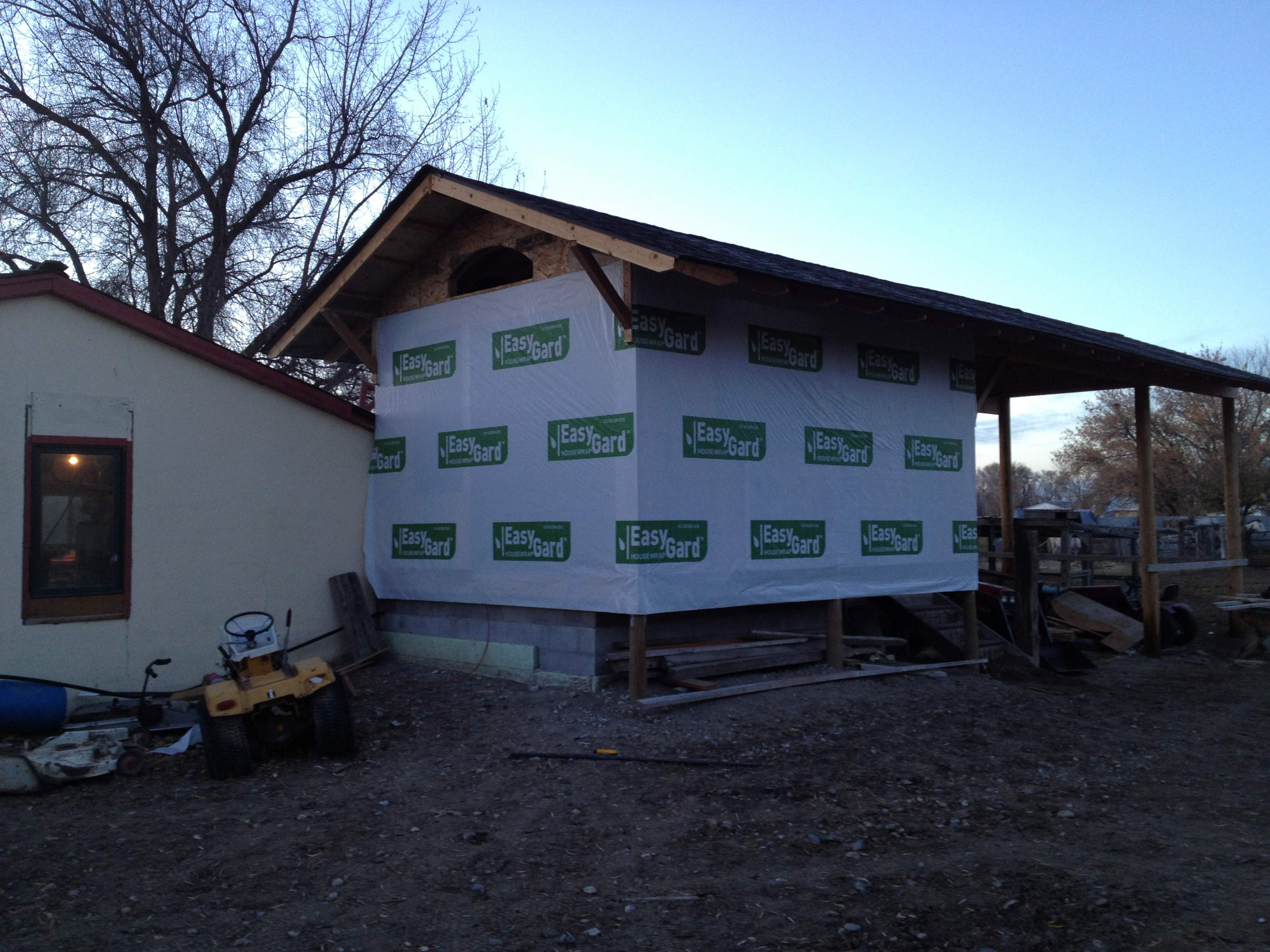

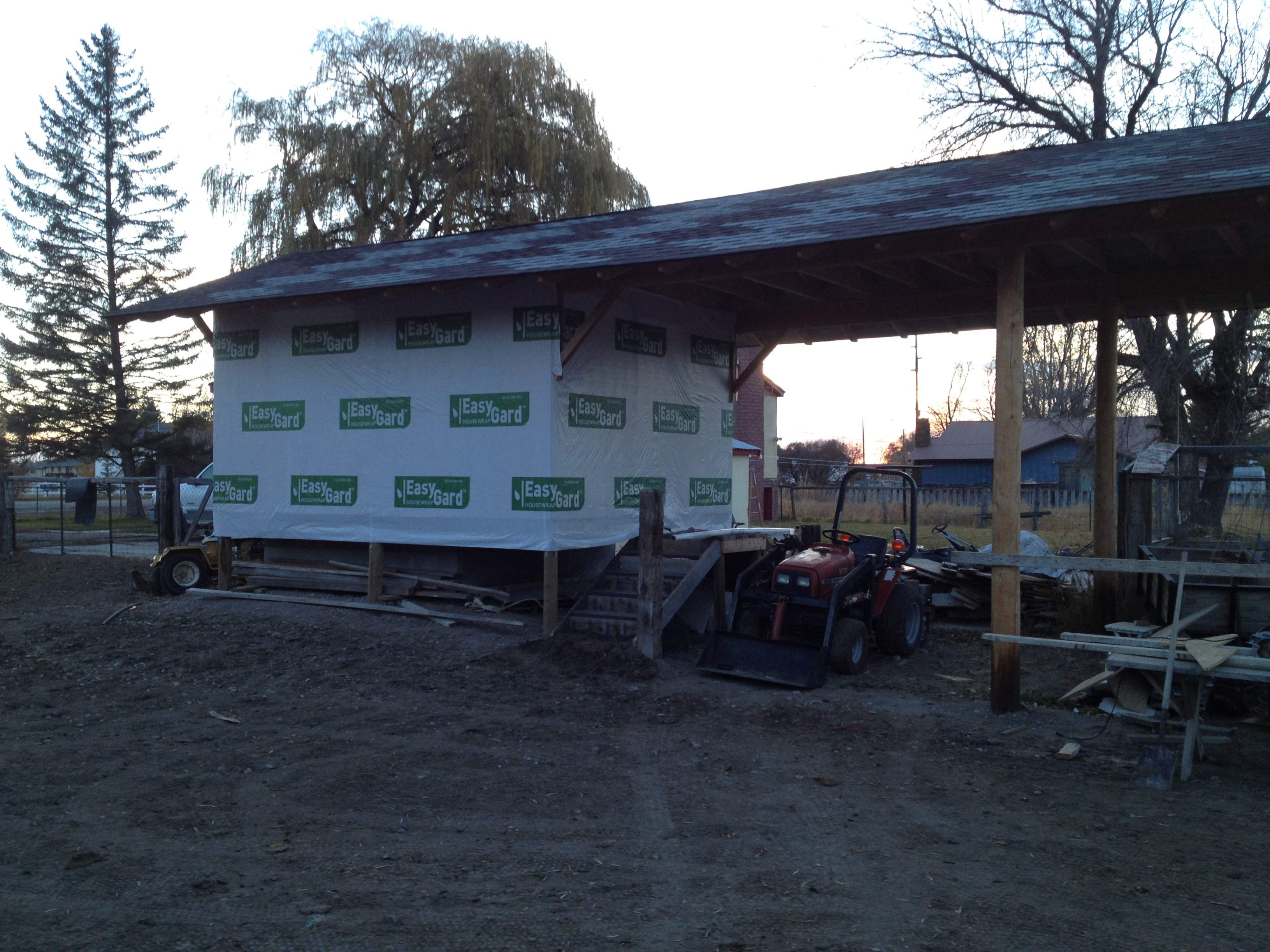

I wrapped the workshop section today. I spent way too much time today trying to figure out how to get the house wrap between the garage and the workshop. I ended up just cutting the house wrap along the roof line of the garage, and I'll put flashing there. Here are a few pictures of today's work. In the first picture you can see the arched window that I framed in earlier this week. The kids were at school most of the day so they only helped a little after they got home.
I ran out of staples for my hammer tacker about the same time I ran out of daylight. I'll get some staples tomorrow so I can finish up the gables. I may even get a window or a door in tomorrow.
