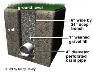

I am assuming you are talking about gravel lined ditches. A gravel filled ditch will soon fill in with sediment and stop draining water. There is nothing wrong with a gentle swale that has vegetation growing in it either. If you are planting grass etc. in the ditch...try to increase the grade to 2% if possible.

About 30 years ago I bought a house on a 1/4 acre lot which had an open drain across the back which drained from other neighbors yards, about 60' long and 15' in from the fence, and an open drain from the house back to that, about 60' long which basically drained the sump pump.
I hand dug and installed a french drain:
I buried plastic perforated drain pipe with a piece of roofing felt covering the top holes. It's still working.
Today I'd use my backhoe.
