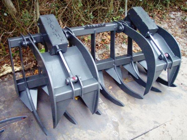

Schneeky, since you are still researching, here is a company that has had good reports here on TByN: www.TheRakeShop.com / Root Rakes Grapples Attachments & Skid Steers
LC.Root_Rake_Grapple_Tractor_Attachment.PB155444-600x450.jpg LC2.Root_Rake_Grapple_Tractor_Attachment.PB155449-300x375.jpg LC.Root_Rake_Grapple_Tractor_Attachment.PB155446-510x375.jpg
   / Root Grapple choice for Mahindra 3016?
#22
Heyyyy. Nice lookin unit. Called and talked with them this morning, super nice and very helpful. Gave a very detailed breakdown of what they make for lighter tractors, exactly what they make it out of and why they do it that way. I was impressed. Cat said they could have one made-to-order in 3-4 days and ready to ship. Pricing was very competitive with the usual suspects.
What'r you guys opinions on grapple width? The older threads seemed to favor the narrower ~48". Sam sez they recommend getting something to match the width of your tractor. What say y'all?
Hat's off to ya Xfax. Gotta do my due diligence, but that may be a winner. :cool: d:^) Schneeks..

Depends on which "other guys" you're referring to. When I say something is competitive I try to make sure I'm comparing apples to apples best I can (which would be a LOT easier if I had a clue what I was talkin about). Design, materials, build quality, and last but not least, customer service, all factor in.
So it boils down to I hafta make as educated a guess as I can from the information I've gathered and what my particular goals are with this piece of gear in my current environment.
As it stands right now it's a 50-60" The Rake Shop root grapple.

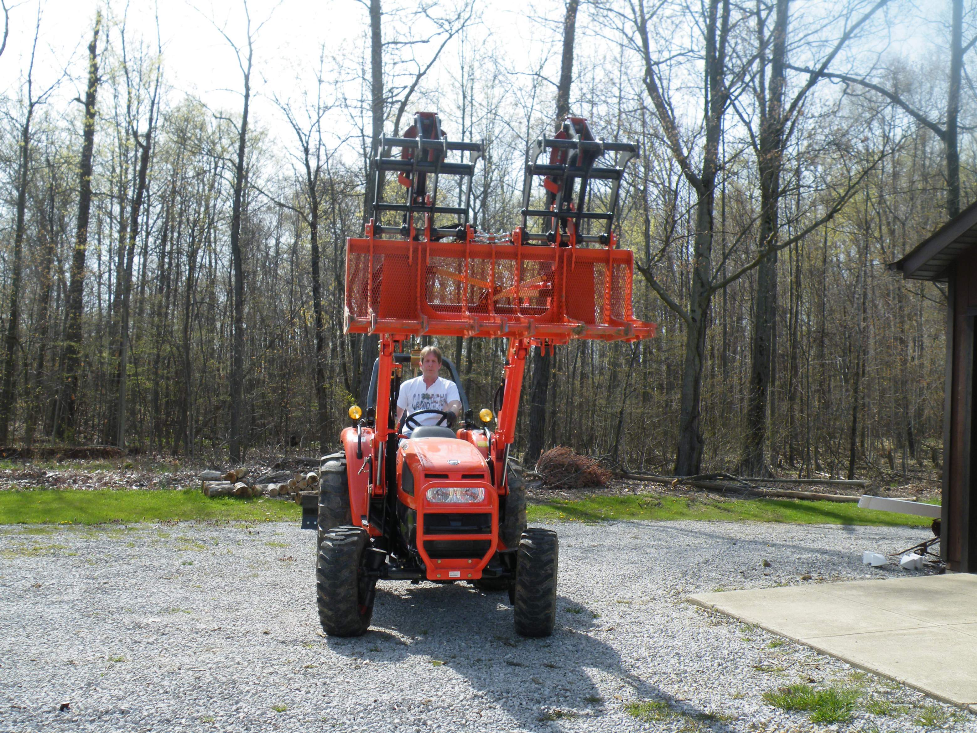

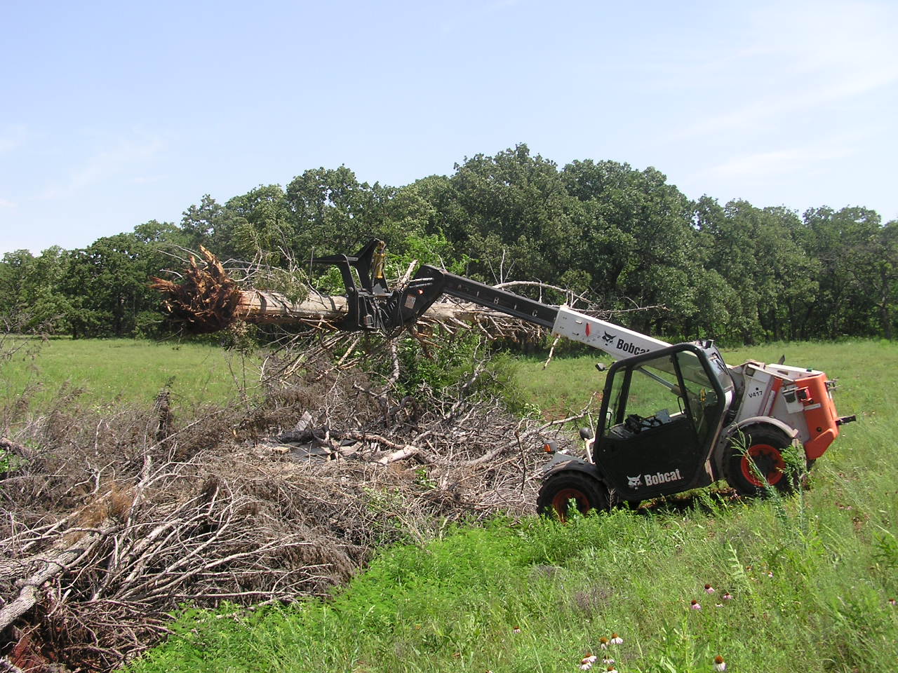

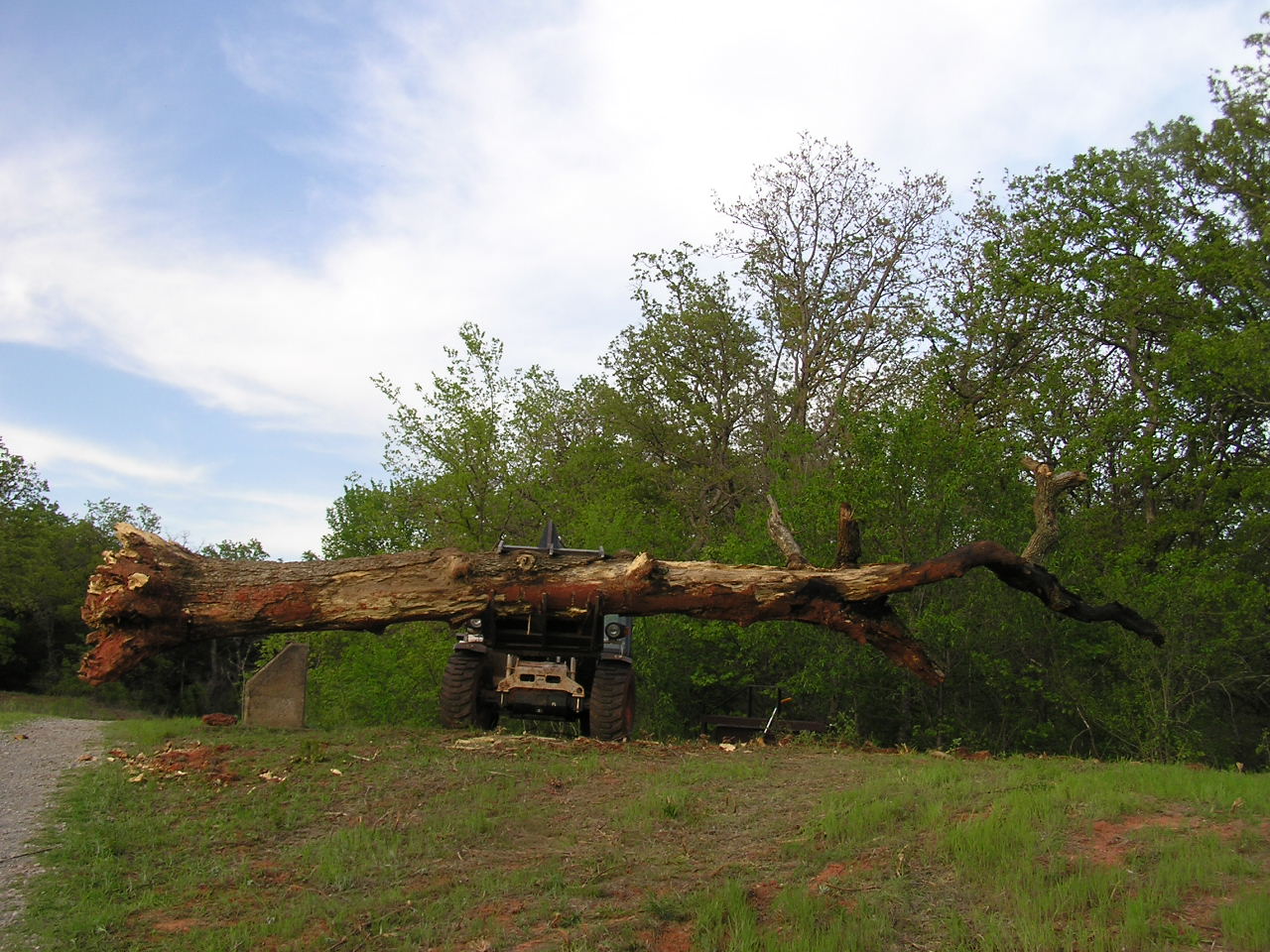

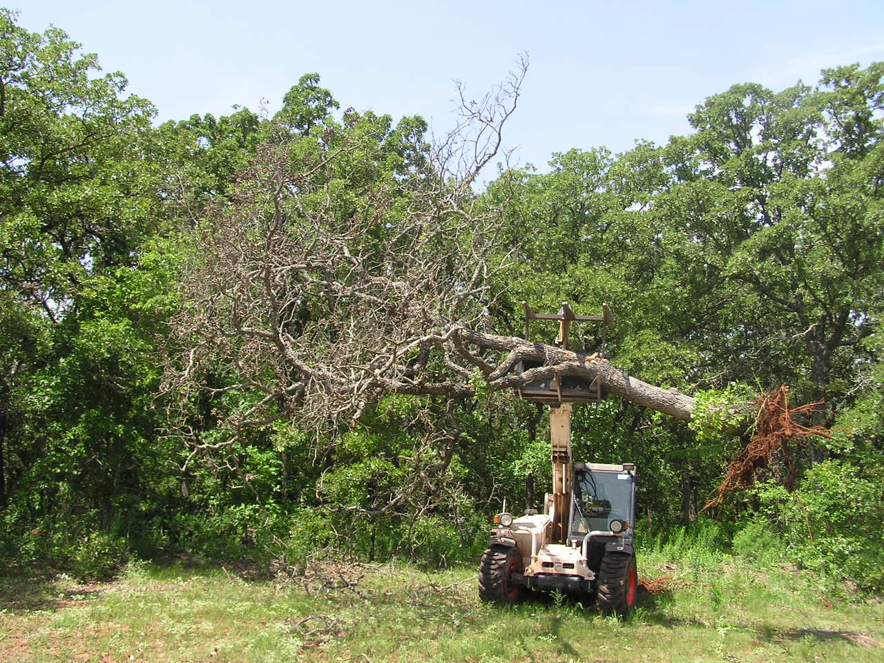

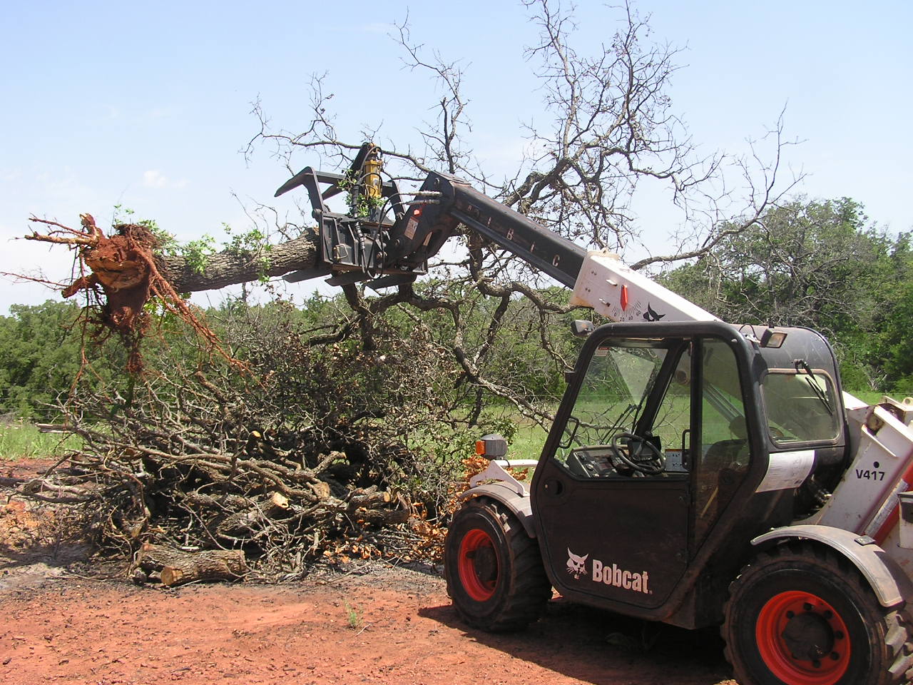

The width depends on what you will be doing with it. Narrow will pick up wide stuff.
This Gorilla Grapple is only 44 inches wide.
This dead tree is over 30 feet wide.
Found the balance point and carried these trees to the pile with the top tines up, not clamped to the trunk.

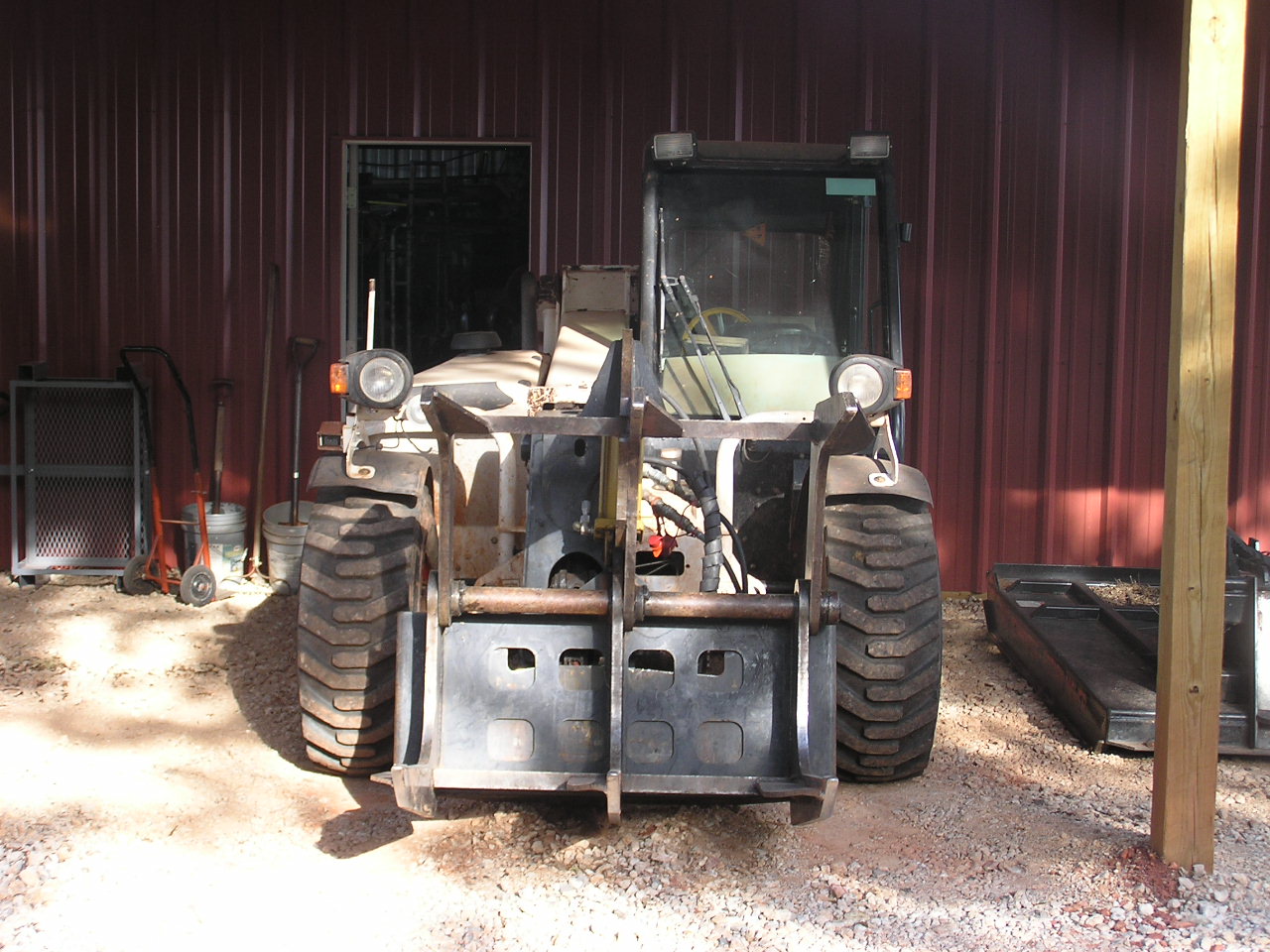

For the vines that you need to remove, wider would be better.
