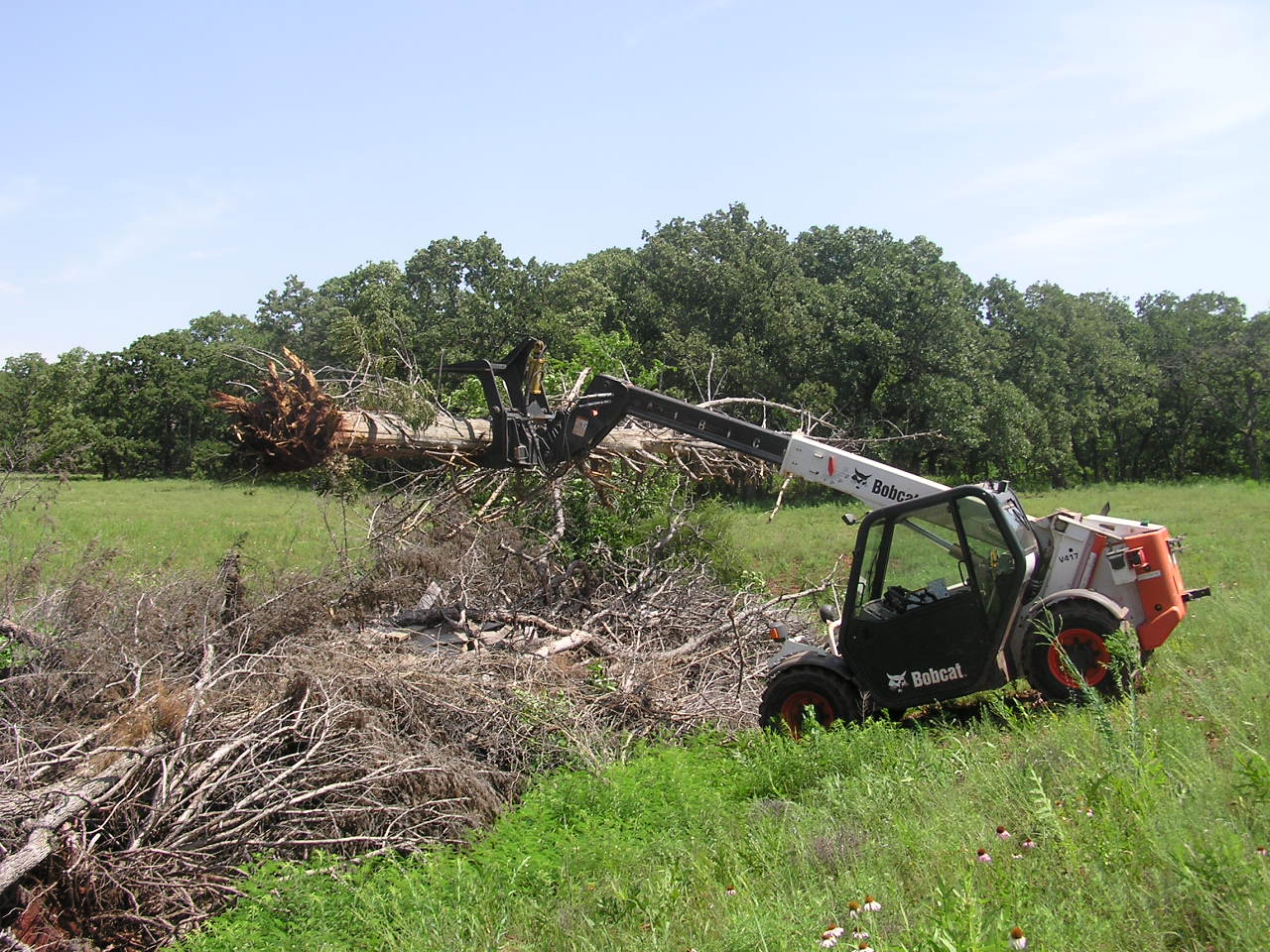

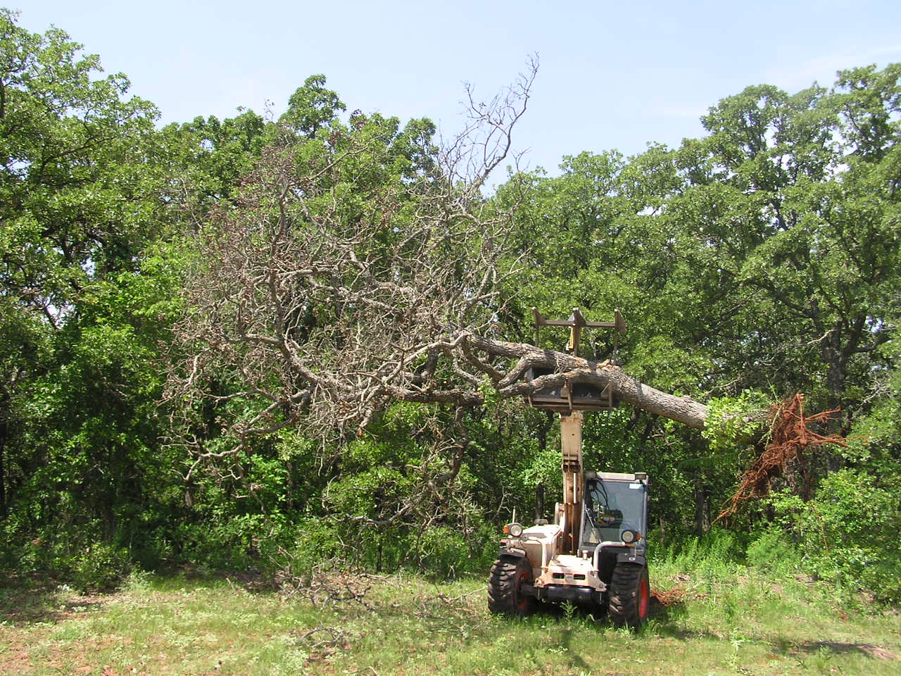

The width depends on what you will be doing with it. Narrow will pick up wide stuff.
This Gorilla Grapple is only 44 inches wide.
This dead tree is over 30 feet wide.
Found the balance point and carried these trees to the pile with the top tines up, not clamped to the trunk.
For the vines that you need to remove, wider would be better.
