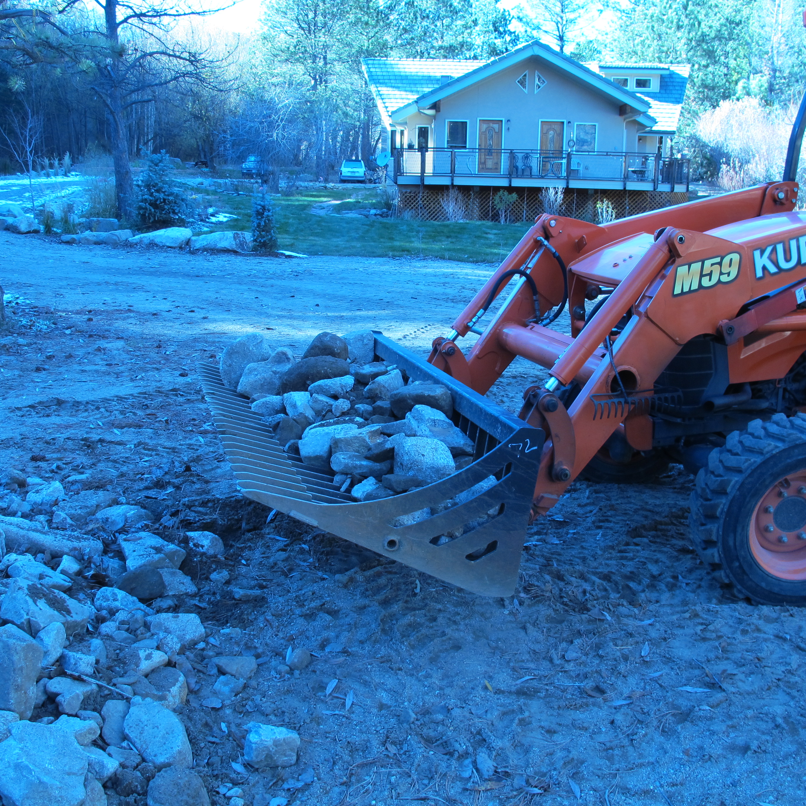

View attachment 641220View attachment 641221 All the land out here started as Government issued 360 acre homesteads. The homestead adjoining my North property cleared many, many fields. There are literally miles of these low rock walls. They are six to eight feet wide and about three feet high. I'm told the neighbor had, at least, two rock sleds and two mule teams. It was also recorded that he had five sons. Fairly obvious what these sons did in their youth.

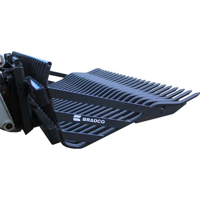

Sandman, it sounds like you have pretty much talked yourself into a grapple, but keep in mind that there are other solutions.
I found the same thing that jjp8182 did, that I got the best results by using the 4 or 5 ripper shanks of the box blade to tear up the ground and expose the rocks and roots. Then followed with a regular rock bucket to pick them up while leaving the dirt behind.
In doing that work, I can't think of any time when a grapple would have been an advantage. It doesn't have the power of pulling a box blade, nor does the grapple have the narrow tines of a rock bucket.
BTW, it's usually better not to go with a real wide bucket. Even for narrow ones, a good rock bucket can cost upwards to $1500/1800 in the width you are thinking. Bradco and Hough make some of the better more expensive good ones with round tines. There are less expensive rock buckets that use narrow flat tines and cost much less and don't work as well. We have one of each and have used them for year. Here's a photo showing us doing some work with one of the less expensive buckets - I think it cost $700.
We've also got the big Bradco bucket with round tines, which has 1" less spacing between tines. Believe it or not, that 1" makes a noticible difference, as does the extra foot that the front of the bucket sticks out. That's because you use a rock bucket by picking up rocks and roots on the front one foot of the bucket and then tilting the bucket up so that the rocks roll to the back and the dirt falls thought. Once you get enough rocks in the bucket that new rocks can't roll back then the bucket is essentially full. Like the one in the photo. It's full. You rarely get it that full & that's why I took the picture. Bouncing the bucket is how you get it that full, but it's hard on the loader & bucket.
BTW, I'd always rent before buying. Otherwise you are just guessing. Some rental yards will deduct the rental fee if you end up buying the implement. Agree on a price first though.
Luck,
rScotty
