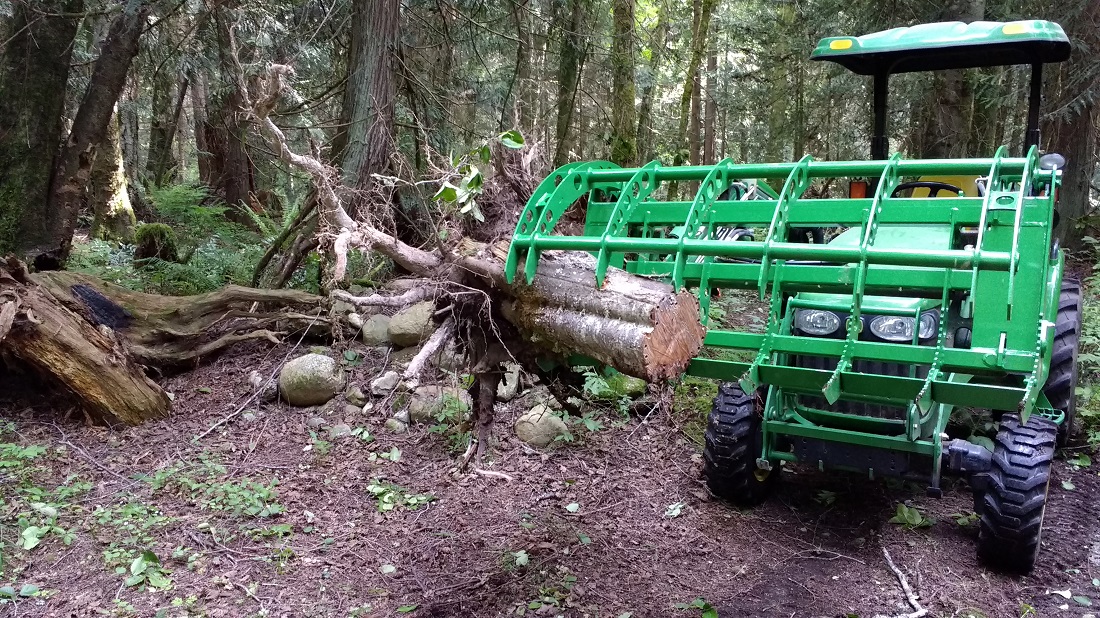

   / Root Grapple vs Root Rake Grapple #9
The rakes have a shorter footprint so if working in tight spots is a concern then that's something to think about as well. It was for me working in the woods.

   / Root Grapple vs Root Rake Grapple #10
I have a root rake style from Anbo. It does everything I asked for, even pick up three logs straight up so that’s not an issue.
   / Root Grapple vs Root Rake Grapple #11
Good point, Eric. Your woods sure serve as a beautiful backdrop! :thumbsup:
