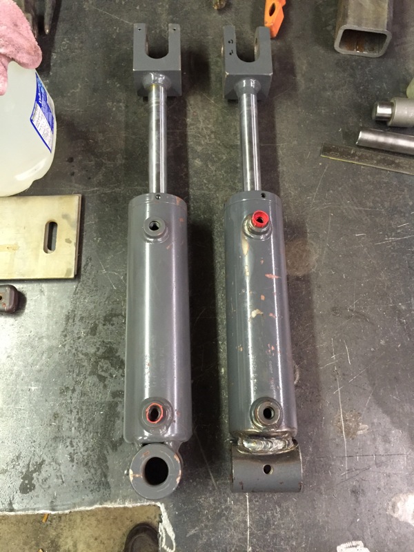

Picture of the cylinders showing the one cylinder after I modified it:
Looks like I might need to beef up the welds a bit.
The new welds don't need to be any larger than the old welds, do they? If not, looks like you've got it covered. :thumbsup:
Not length. If you look closely you'll see they aren't quite as wide (top to bottom) ... there is some of the old weld visible that I didn't grind off ... new weld doesn't cover it.

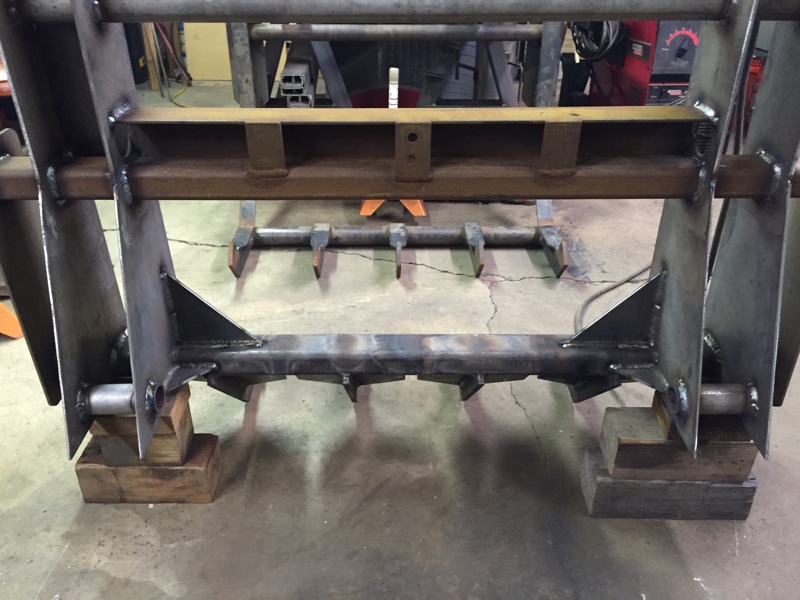

After yesterday:
Item no. 7 on hold ... until I can sort out clearances with the hydraulic cylinders.
Item no. 8 - In progress/half done ... will finish today.

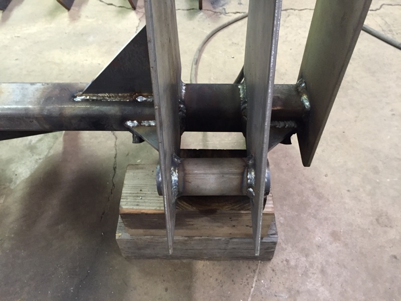

Item no. 9 - Fabbed up two 6" and four 3" gussets out of 1/4" plate and got them all welded in on the lower rake bar and lower portions of the masts/towers.
Item no. 10 and 11 - on hold, until I get the QA plate welded on.
Cut a couple pieces of 10 ga sheet yesterday to be welded inside the masts/towers as hose protection.
Today I will likely stand up the lower jaw, get the two 10 ga sheets for hose protection and the lower two 5" long 2" diameter pipes fully welded in, then get the QA plate tacked/welded on. May need to make up a few more gussets for the QA plate itself ... assuming I have enough area to weld them on.
Also scope out the welds on the hydraulic cylinders and add some more weld if need be.
Might get the upper jaw installed and measurements taken for hoses.
More pics later today.

Long and somewhat frustrating day yesterday ... I hate redoing things ...
I did manage to get the QA plate completely welded on ... which was no mean feat, given the narrow confines and the need to keep a (somewhat) appropriate angle on the MIG gun. That will be handy, in terms of moving the thing around, as it's getting kinda heavy at this point.
There are two places (3" each) on the bottom of the ends of the lower bar that holds the rake teeth that I can't get to with the MIG and will have to be done with stick. U.B. will do that sometime next week, after it warms up a little and stops precipitatin' ...
I monkeyed around with the hydraulic cylinders, trying them in both orientations (ports up, ports down) and considered using a straight fitting or a 45 before finally coming to the conclusion that option no. 3 (cut the pipes) was the only route available to me.
So I went ahead and cut them ...
And then - while thinking about adding some more weld metal to the bushings on the base end of the hydraulic cylinders - the thought occurred to me:
Why not just trim those bushings on the cylinder off, and stick a piece of 1" plate in between the bushing and the end of the cylinder ?
Doing this will move the hydraulic port on the base end further away from the pivot point and allow the grapple to close a little further ... and I don't know that it will effect the maximum opening all that much, given that when the upper jaw is opened to it's maximum (64") currently, I still have some travel left in the cylinders (1/4" to 3/8") before they are completely collapsed.
Will probably cut off one bushing today, tack in some of that 1" plate and check the opening and closing to verify it.

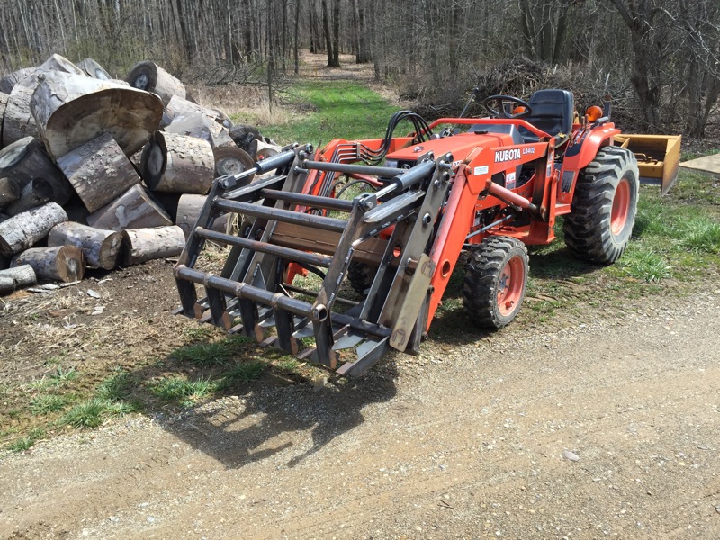

The promise of what's to come ... :D:
   / Root Rake/Grapple For Kubota B2910
#78

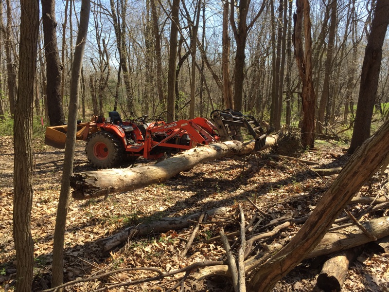

Probably could have gotten away with a couple more degrees of rollback but I was playing it safe:

Takes about 800 psi or so to lift it ...
I have around 2200 to 2300 psi available to the loader, so that's roughly 35% of the loader's capacity.
