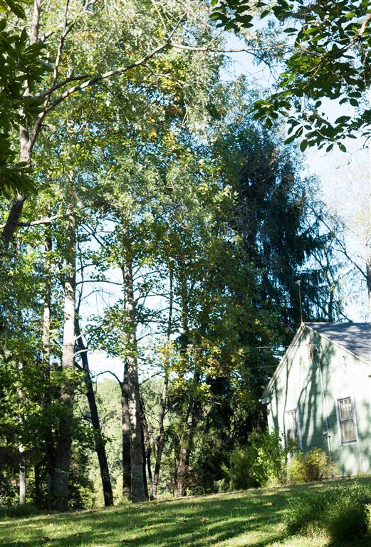

I have a poplar tree about 100' tall too close to the house.
How far up the tree should I go with a rope to pull it back away from the direction of the house?
How do I get the rope that far up the tree without paying somebody to climb the tree?

It's tough to give you some guidance on this without seeing it. obviously, the higher the better, to gain the advantage of leverage. However, with a good 12,000lb rated rope, you'd be surprised how much pull you can get on a tree using only 1/2 the rope rating (6000lbs.) (visualize hanging a single cab 3/4 ton pickup from a rope, it's a lot of weight) Probably just as important is understanding the notch, back-cut and hinge. If you ever cut through the hinge, you just lost all control of the tree. You want to leave the offhand side of the hinge (the side opposite where you DON'T want the tree to fall) thicker so it doesn't go in the wring direction. I'd really need to sketch this out to give you a better understanding.

There's a poplar in the lower left hand corner with a green ribbon on it that has grown with two forks. There is another poplar with one trunk just to the right of it that needs to be cut as well. Maybe not the best picture, but try zooming in. I can make more photos.
