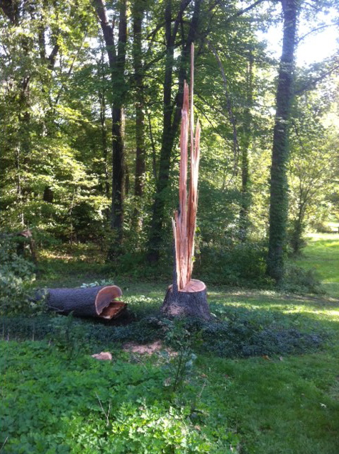

I once knew a guy who had a tree on top of a bank that was severely leaning over a hill down to his beach. He wanted to remove the tree to increase his view. A number of neighbors, including myself, told him to have the tree professionally cut. He being a younger person without life's experiences decided one day to go buy a big new saw to cut the tree. He started cutting the tree without even so much as a back cut. Cutting from the away side of the lean, he got about 2/3rds through the tree before the tree, due to the internal stress of the severe lean, split up the middle and "barber chaired" on him. He evidenty had his head down near the trunk of the tree above the saw when the tree let loose. Decapitated, or close to it, the medics said. I never saw his body, and did not want to. Barber chair is common in some species, particularly in leaners.

It got it's name from the shape of the stump after the tree explodes. See depiction I posted earlier. 15 to 18 trees leaning towers your house is a job for a professional. I would hire it out and I used to cut professionally.

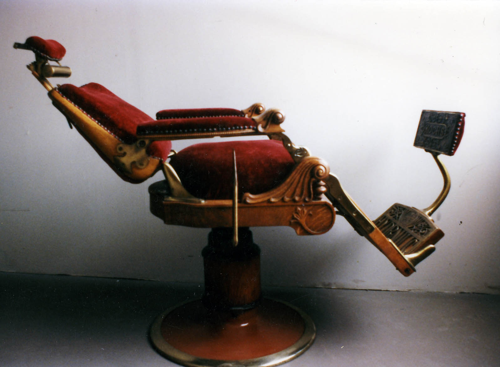

If you remember what happens to your feet on the foot rest of the barber chair when the barber leans your head back - they swing up, and if you look at TomSeller's picture, that is what the tree trunk did....
   / Rope suggestions and help #48
Barber shop chairs, when put into shaving position, tilted the backrest back and down, and the footrest went forward and up.

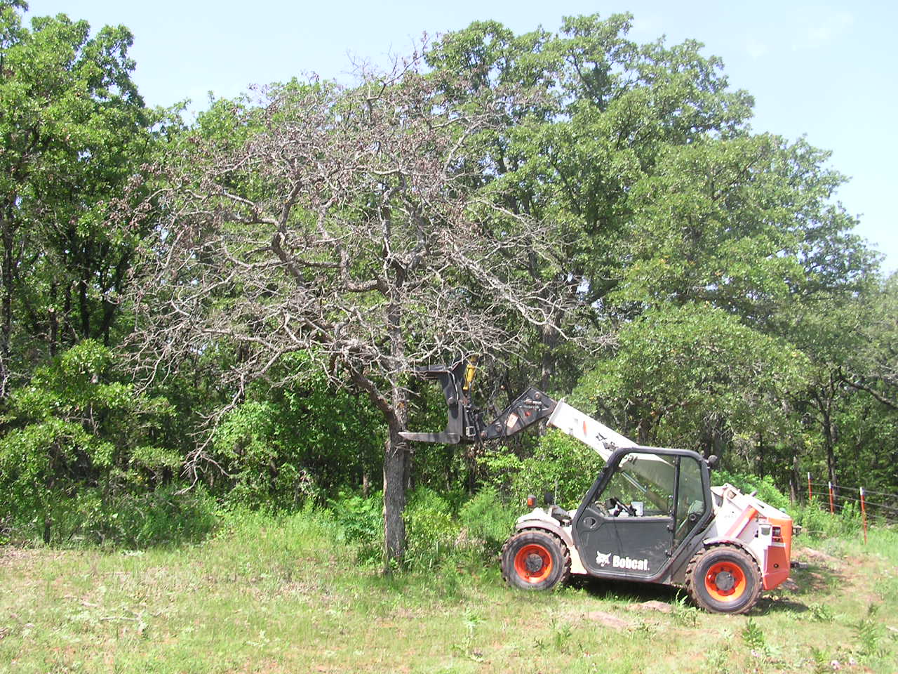

Back to the question of removing 15-18 trees, would you want a professional to use a bucket truck, a guy that climbs the tree or would you bring in a trackloader to push them out? I had one professional to look at them, and he recommended that I call a local logger to push them down and then cut them up for timber. He thought the trees were large enough to get some logs out of them and it would be cheaper than him climbing each tree.
