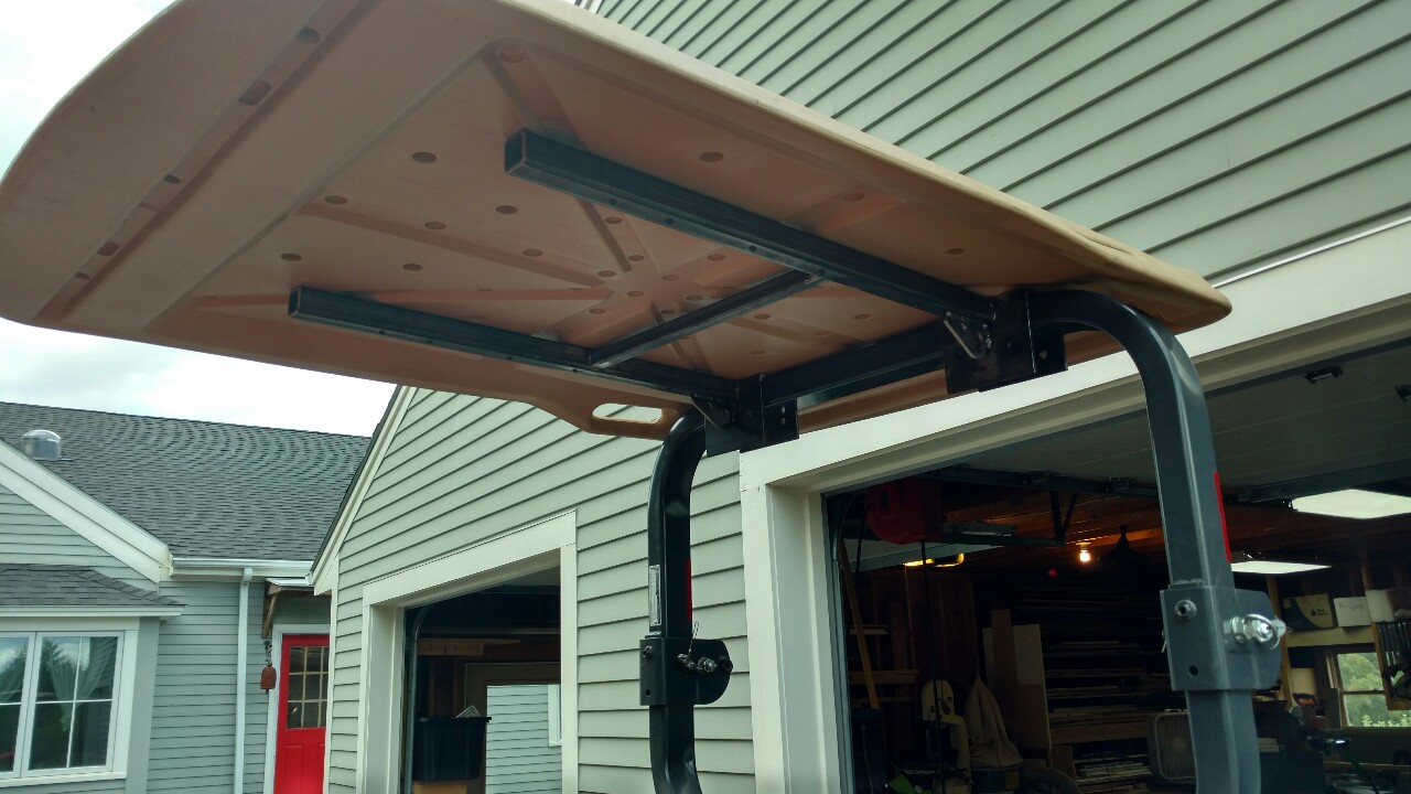

I just installed one of these on my L3800. Perry Corp Canopy
I tried one of the Femco Tufftop's, but it was flimsy and the branches ruined it. For what I paid for the Femco (around $250), I wish I had bought the Perry steel unit in the first place (buy once, cry once). The Femco also had cheap/flimsy brackets and vibrated/shook badly when mowing. I had run around my yard and pasture with my pole saw and trimmed all the major branches, but my top eventually developed a split at the leading edge of the fold that seemed to catch every little twig that brushed past, eventually grabbing one and twisted the cheap frame. I gave up on it and took it off.
I think the Femco is a temporary solution and at $250, you'd be better off finding a golf cart roof and making your own canopy that's more robust. Or, just bite the bullet and spend $400 for the Perry steel or aluminum model (or, fabricate your own from steel sheet, or R-panels). The brackets on the Perry are pretty simple and seem like they'll work well.
Bottom line, if I had time, I'd just build one patterned after the Perry model.
