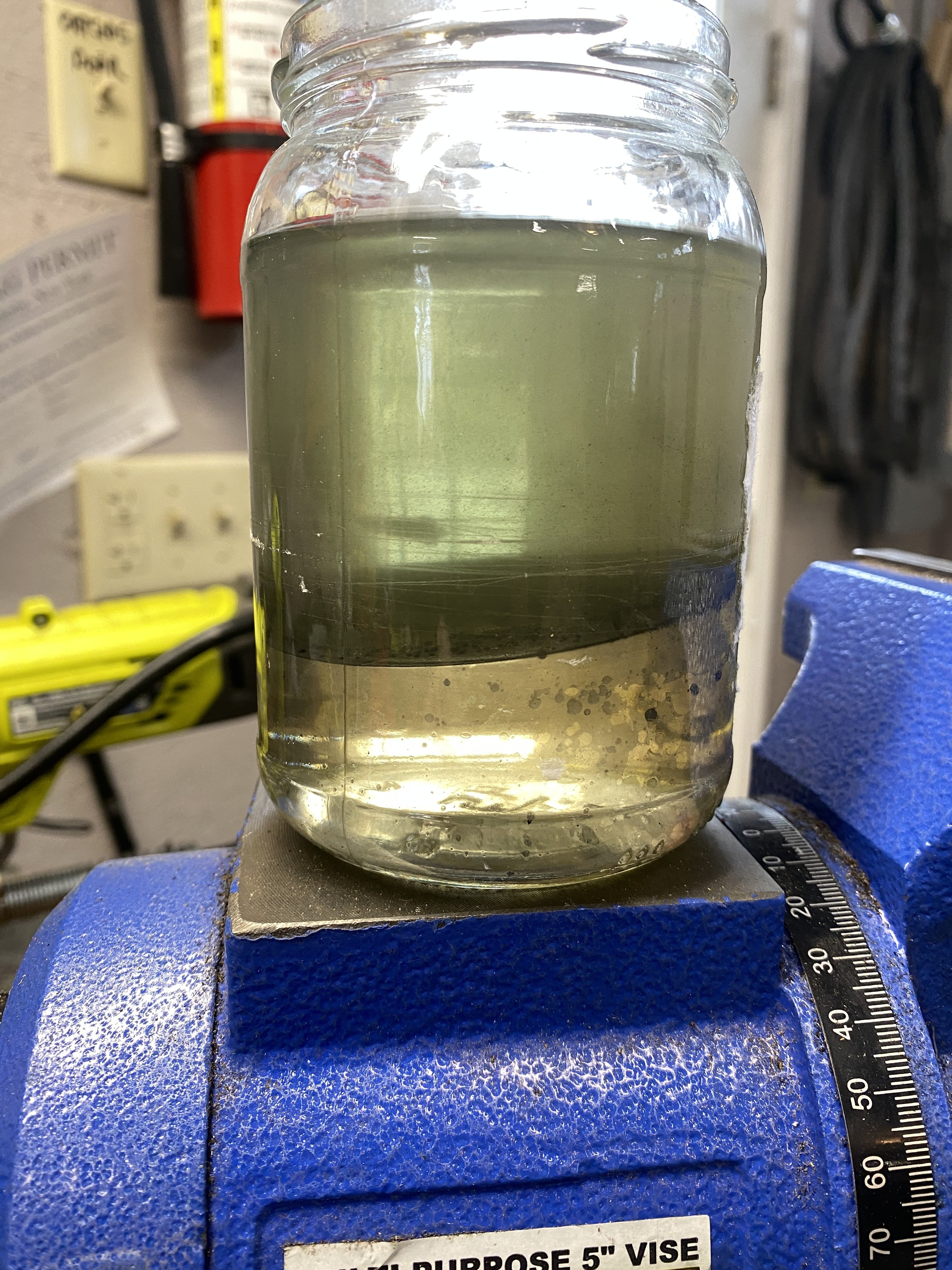

I have big pond built in 1995 (2 acres) with a long story, condensed version, my major spring actually reversed when pond got full after 2 years. So I pumped the water out and brought in an excavator to dig out the spring and pack it with bentonite to seal it. I was not willing to wait another 2 years to find out if the fixed worked, and I had the pump so I ran roughly 700 feet of 2” black plastic water line from a seasonal creek on my property and pumped it full. Victory!..Sort of. The natural head on the remaining springs is about 3’ below the overflow. Each year I “top it off” in the spring. I rigged a 6.5 gallon Northern Tool generator tank so the pump wiii run roughly 50+ hours on fill up. I change the oil every 100 hours using 10-30 syn-blend, with no particular brand loyalty. By my rough calculations I am approaching 6000 hours on a Honda GX 120. It still starts on one pull, but it does feel like it is starting to lose compression and uses a little oil. I dropped a note to Honda as a testimonial, and heard…crickets. My biggest source of problems over the years has been contaminated fuel. for the last 6 years I have been purchasing non ethanol rec-fuel in a Tractor Supply 50gallon tank that I rigged for easy loading into my pickup. I have a water removing filter on the tank. That had solved the problem until this 76 year old goofball somehow left the fill cap off the “day” tank, and it rained. I drained the bottom of the tank and but I would still occasionally have the motor quit on me. I had added some Stabil Marine I had on the shelf to help purge the water. I had tilted the tank so the gravity feed was not the low point and that seemed to solve it. When I broke down my set up this fall, I set up the tank back in my shop so that the feed was the low point and drained fuel into a glass jar. The photo shows what I got. Maybe the Stabil was out of date, but it was definitely not impressive. View attachment 1970596
None of the fuel additives work as advertised. The YT channel Taryl Fixes All did a two year study on I think it was 12 additives with 12 new engines and at the end of the test, the only one that would still start, and had a clean carb bowl was the engine running non-ethanol fuel. All the additives do is absorb water till the additive is saturated. Hard to say if that would make it easier to see the fuel water separation or not or if that would make it easier to siphon out the water? FWIW, I remember back in the late 70's when I managed a Clark Oil gas station. I'd have to 'stick' the underground storage gas tanks weekly with a long measuring stick that I'd smear a substance on, which in contact with water would make the substance red or maybe it was pink. Then the water level would be recorded. Periodically the company would come out and pump out some of the water. And I'm pretty sure this was before ethanol was a common additive. How the water got into the tanks is anyone's guess. Rusty tanks maybe?
Most likely that substance is still available. So you'd be able to stick your 50 gallon tank, record the water level, then pump most of the water out since water is heavier than the fuel so will be on the bottom of the tank.
Condensation. You'd be amazed at how much condensation can form inside a large tank. All these tanks are vented and that allows moist air in.
One of the reasons that manufacturers tell you to keep a gas tank as full as possible as much as possible. That reduces the amount of condensation-producing air in the tank.
according to a Mercury Marine rep some years back, he was told by Stabil people that all it does is form a layer on the top surface of the fuel to block absorption of water vapor and oxygen. If liquid water was falling from the top of the tank (condensation, etc) Stabil wouldn't help that problem.
