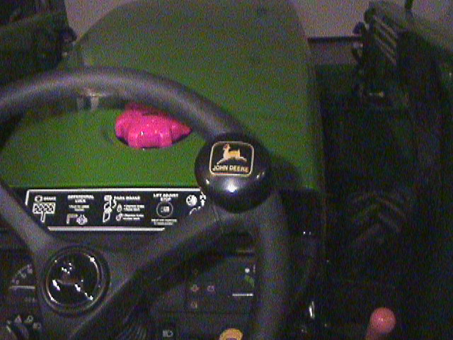

If you decide to add switches to the dash as I did, be careful. I thought I would take the dash off the tractor to work on it at my work bench. I spent hours trying to pull the steering wheel off per the servcie manual. I was elated that it finally came off with a gear puller and a bunch of clamps, only to find that the molded metal taper stayed on the shaft and did come off with the steering wheel. I think the new wheel was about ~$20 and apparently the dealers can't get them off in one piece either. So keep this in mind if you decide to remove your wheel.
I did use the old steering wheel as practice for drill a hole at the rim/spoke intersection for a spinner. The wheel is all plastic our there and is easily counter sunk with wood working bits. So I installed a spinner without that nasty clamp for the rim. It goes right through the wheel and looks like the factory installed it. Here's a picture.

A bottom view of the spinner on the wheel. I used a butterfly bit to create a flat spot on the bottom of the wheel and before you drill completely through the wheel, I made another flat spot on the top side, but only large enough for a spacer to raise the spinner high enough to clear the rim.
The hardest part of the install is getting the rubber cover of and then back on. After much trial and error, I found nearly boiling water soften the rubber enought to remove it from the new spinner. I cut/grind off the mounting hardware and use my own carriage bolt. I also recommend popping off one of the bearings and placing the proper length spacer between the bearings so that they are not overloaded when you torque up the assembly. Heating the rubber again allows it to be reinstalled and low seating on a heat gun helps srink the material back up tight.
