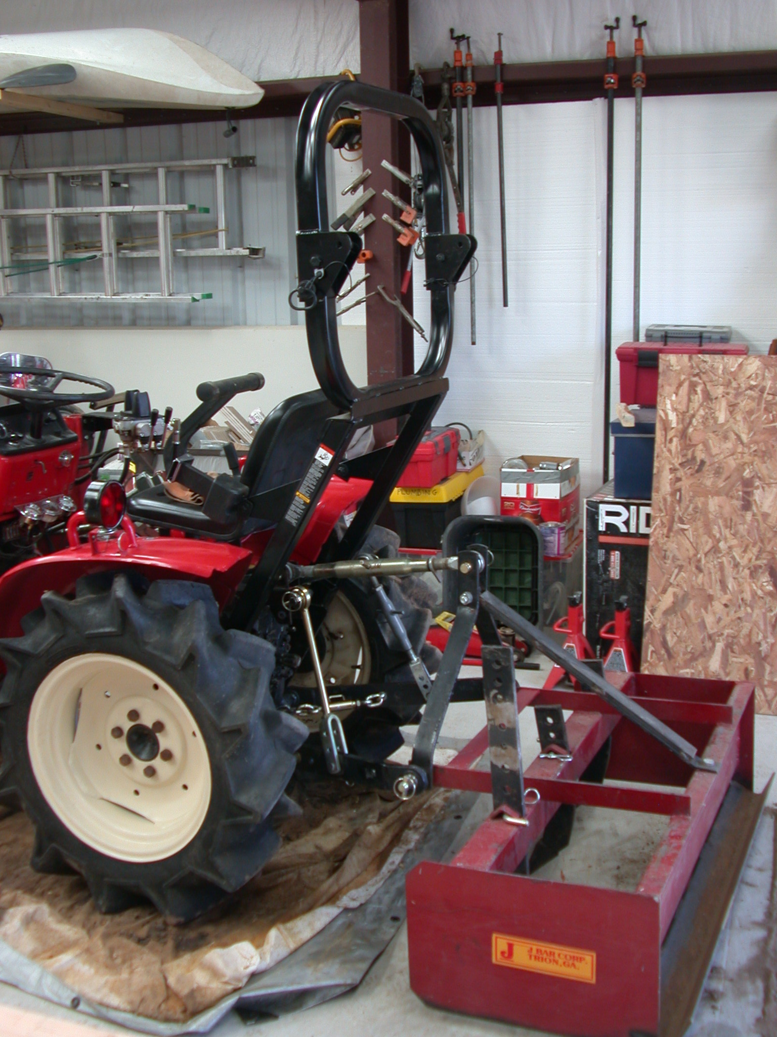

Thought I'd post a picture of my newly installed ROPS on my 1510D.
As I told Wayne, it only took me an hour, start to finish. Pretty simple, even for a non mechanic such as myself. I didn't remove the rear tires, although it would have been easier to torque down the front bolts.

Lawrence, could i talk you into posting more pics of your install..... especially with no implement on the back? I'm looking to see if that ROPS will bolt to my 186D.

Well, looks pretty nice. I have a question tho-- I expanded your pic, and the outside weld of the L bracket to the tubular bar only has about 5 welds, what appears to be one inch long, some inches or whatever apart. Is this OK? I looked at this and think that on my 169 with a solid bar, and welds all around the surface connections, this doesn't look nearly the same, as far as impact strength would be concerned. . . What kind of test was this exacted through? There are also torsional tests which I would think it went thru. Do you know?
In a forested region, with unforeseen rocks on a hill, I don't know if I'd use that ROPS. JIMO...
   / ROPS for 1510 and F/FX18 #9
It's OSHA approved, it better be ok! It was tested on a 1510.

The ROPS for all models were put through and passed whatever tests are required to meet OSHA standard 1928.52, which is the applicable standard. They were designed by people with engineering degrees and built and certified by the same company that provided ROPS for the domestically sold Yanmars. If you wouldn't use that ROPS, what ROPS would you use? Where is there one on the market for these tractors that inspires greater confidence for you?
....I think you'll find that evenly spaced welds (or stitch welding) is an industry standard. It is done to permanently join the metal without overheating. Continuous welds often produce distortion and molecular weakness on thinner, stronger alloys.

OK, thanks for the clarification. And, no i haven't done any other study on these safety devices so I was asking just out of curiosity..
