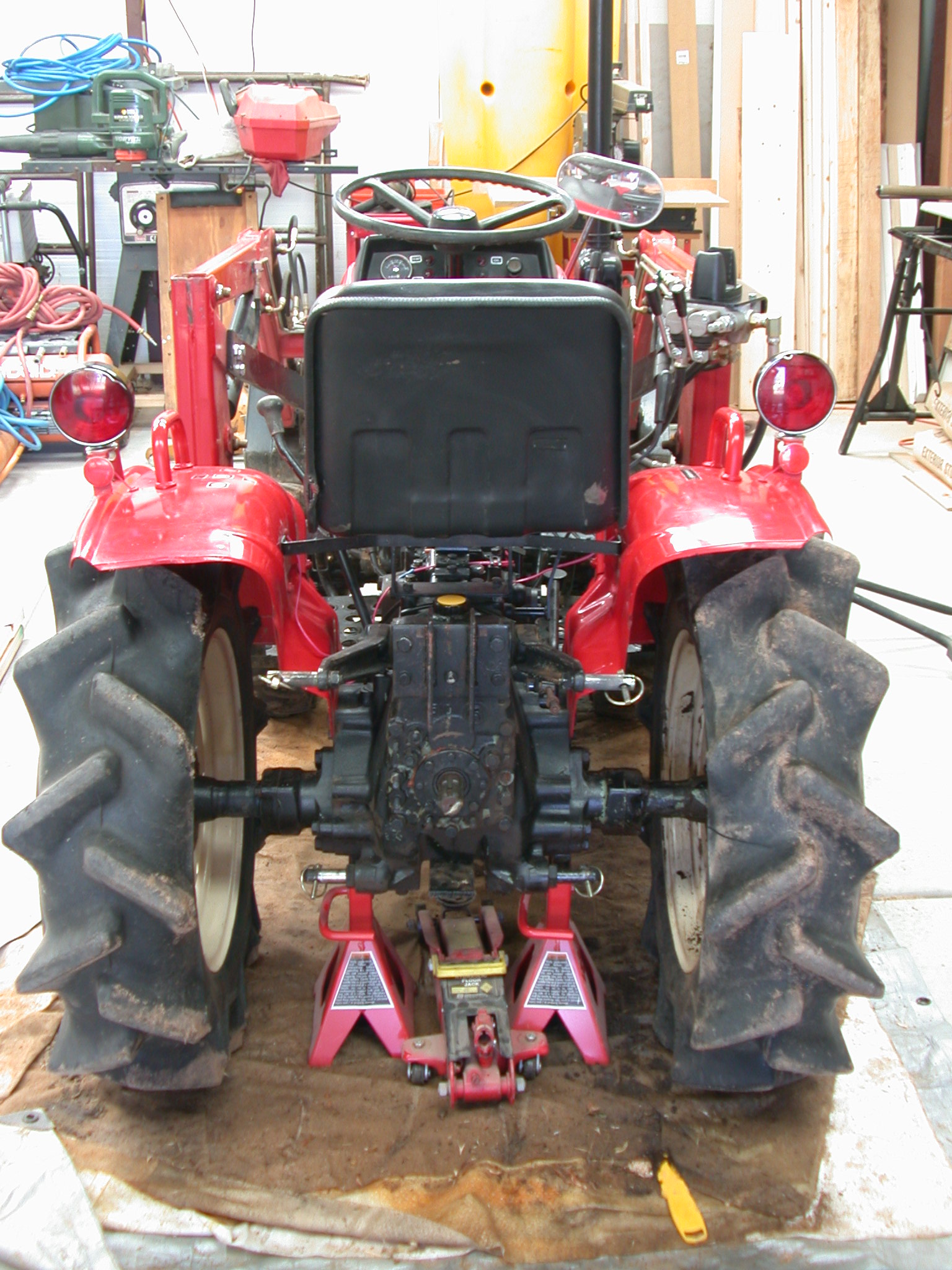

Ductape said:
Lawrence, could i talk you into posting more pics of your install..... especially with no implement on the back? I'm looking to see if that ROPS will bolt to my 186D.
Here's a pic of the tractor pre install. You might ask Wayne if it will work on your 186D.
   / ROPS for 1510 and F/FX18 #14
Lawrence, thanks. I think i'm on my own to find out if the 1510D and my 186D share a rearend casting. I know alot is interchangeable between the two, including FEL mounts. One would think it would be easy enough to figure out by checking part numbers on the rearend, PTO area, etc. I sure would like to get a ROPS on my tractor !
Scott
#15
It is NOT listed by the manufacturer as approved for a YM186. I have inquired.
