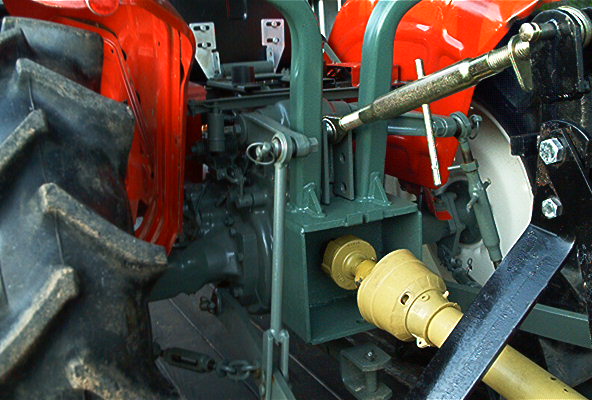

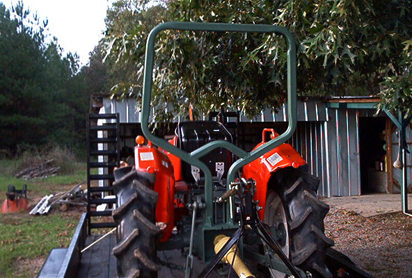

I see that you've had many different replies. Good luck on building one. I got luckey at a flea market and saw a roll-over bar. It looked like it was for a Kubota. It was orange anyway. I bought it for $15.00 and brought it home to my welder and we had a party. I made a box at the bottom of the ROP and cut a hole for the PTO and drilled four hole for the bolts around the PTO. Attached is my results. /forums/images/graemlins/crazy.gif

   / ROPS for 2210D #23
JMF,
Nice job on your ROPS. So, the box around the PTO bolts to the frame? It must have some flanges on it. any chance of a close up near the PTO? thanks, bw

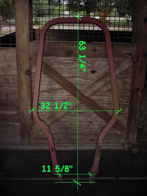

Vongiese:
Took the trusty tape out and this is what I came up with. Now while I was out there I looked at the tag on it and it had this info on it maybe there still in business and it looked as if Yanmar had them make ROPS for there American sales tractors, worth a try anyway

Who knows maybe they will make one for your tractor or anybody else out there looking to get a ROPS built maybe a place to start....let me know how it turns out

   / ROPS for 2210D #25
When I got it there was a box around the bottom of ROPS and I added a piece of flat 1/4 plate to make a back. Then drill 4 hole to match the bolts on the PTO housing and used cutting torch to cut out for PTO shaft. There is no other support other than the 4 bolts. I belive they are about 1/2. But there is one safety feature, its surrounds the PTO staft. So if the bolts broke, you would have to break the PTO shaft before it came off. /forums/images/graemlins/smile.gif

Thanks for all the info guys /forums/images/graemlins/grin.gif- I'll have to look at some salvage yards pennwalk - there's one I've been meaning to go to South of me about 40 miles.
jmf7112001 - nice photos - what model tractor is that?

2010 Model /forums/images/graemlins/smile.gif
