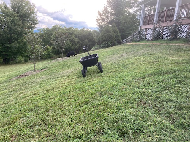

Here is a picture of the worst slope, at the top of the hill where the house sits. It does not look as steep here as what it does in person. What percent slope, can anyone tell? The worst part of it is the swath right after it falls off from the house, in line with those two evergreens.
Except for that little piece maybe, I used to mow across a hill like this on my John Deere 970, 33 hp. 4WD with weights on the front and filled rear tires. In my came-with-house JD lawn tractor, I am afraid to mow a lot of it going across and have to run up and down. Climbing is interesting.
Not sure this is a BX or a B hill.
To follow up on my old post, today I dragged out this cart to show the slope but I also put my iPhone on it and used the Level function to determine this is an 18% slope. By now, I've been mowing it steadily for four years. I alternative going across it and running up and down.
Have had no issues but don't feel as comfortable on it on my B2601 tractor. Odd since I used to mow a worse hill with my JD 970, but I am older and that tractor had a wider stance and was heavier. I mow this hill with a 27 yoa JD rider with wheel weights and hiking cushions over the rear fenders made by our place's previous owner. I do hike now for extra safety but feel I am too slow to get clear if it did start to overturn. At the far side of this slope, just to the left of those small evergreens, the slope briefly seems to fall away sharper, just a small spot, but that's all it takes.
The problem with only running up and down is that my 2WD rider starts to freewheel and flies super fast down hill. I use my brake but that can lock the wheels. Maybe I should try mowing at an angle? Basically going up and down but more 45%?
