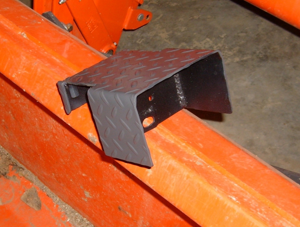

I made a set of mounts for my lights. I used 1/8" diamond plate steel and a system where it clamps to the ROPS (so no holes to mount them). I was going to put some expanded steel in front of them but haven't. I can plow right through branches without fear. I don't have a picture of them on my tractor but here's the mounting bracket. I made 3 of them, two facing forward and one facing the rear. I used the power for the rear work light so I put the switch for them by the seat.
   / ROPS Mounted Flood Lights on Kubota BX #19
Crazyal,
Would you mind posting a pic of the bottom side of the light cover? Specifically, how it clamps to the tractor. These would be beneficial because of the brush/dense woods on my property as well. Thanks.
