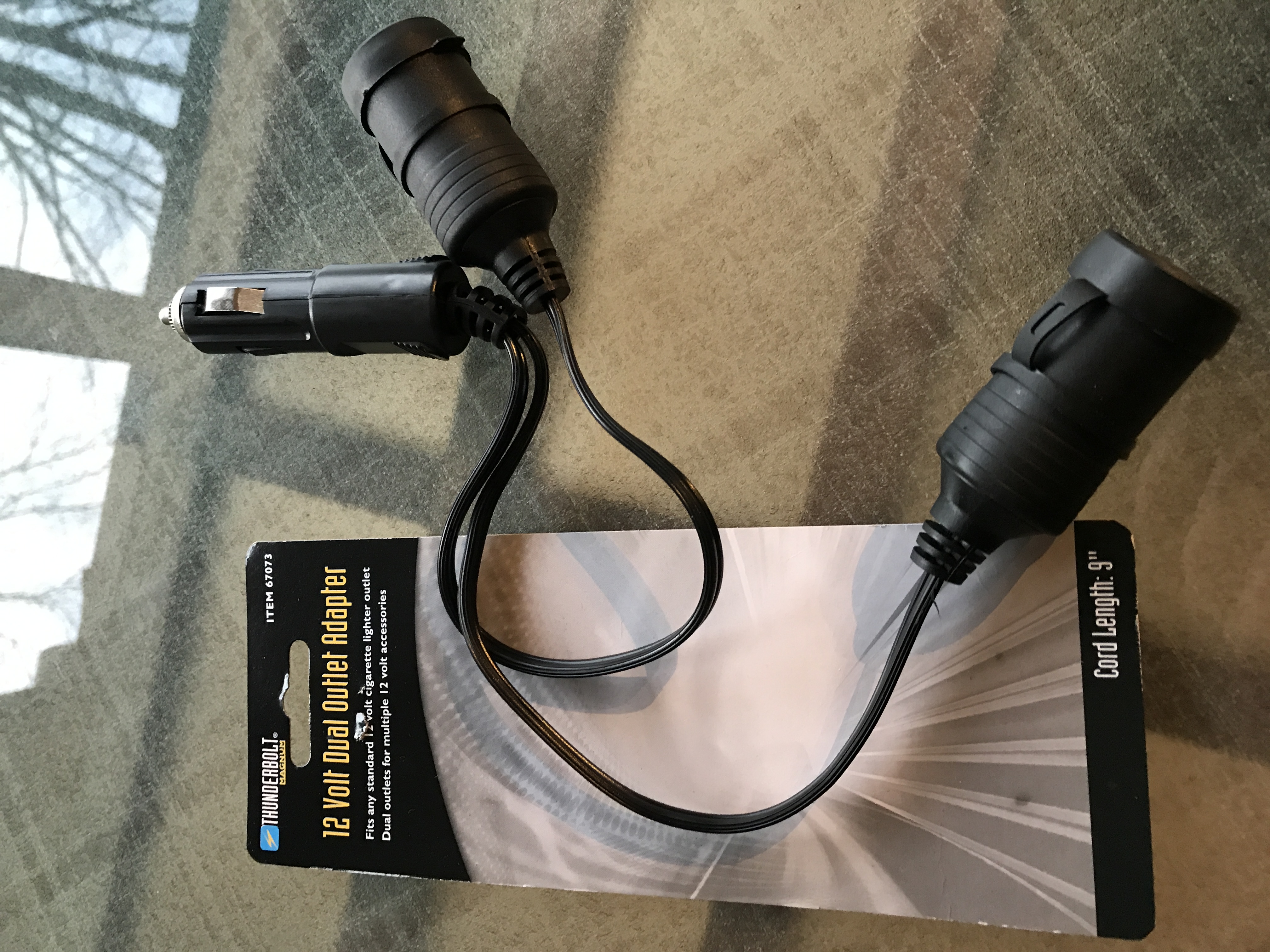

I bought a cheap 12V splitter at HF, chopped off those receptacles, and wired up the lights so I can plug everything into the 12V outlet on my BX. I can take everything off and have it in a box within less than a minute if I want to mow under trees or whatever. Here's a pic of the splitter. I think it was probably 5 bucks or less at HF.

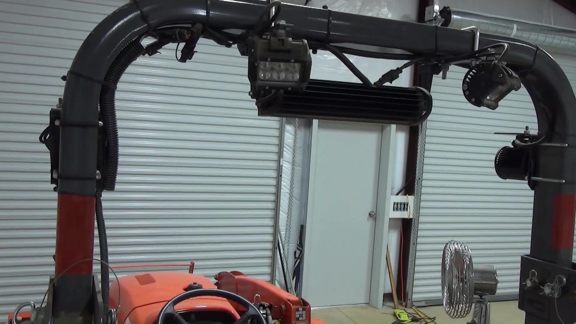

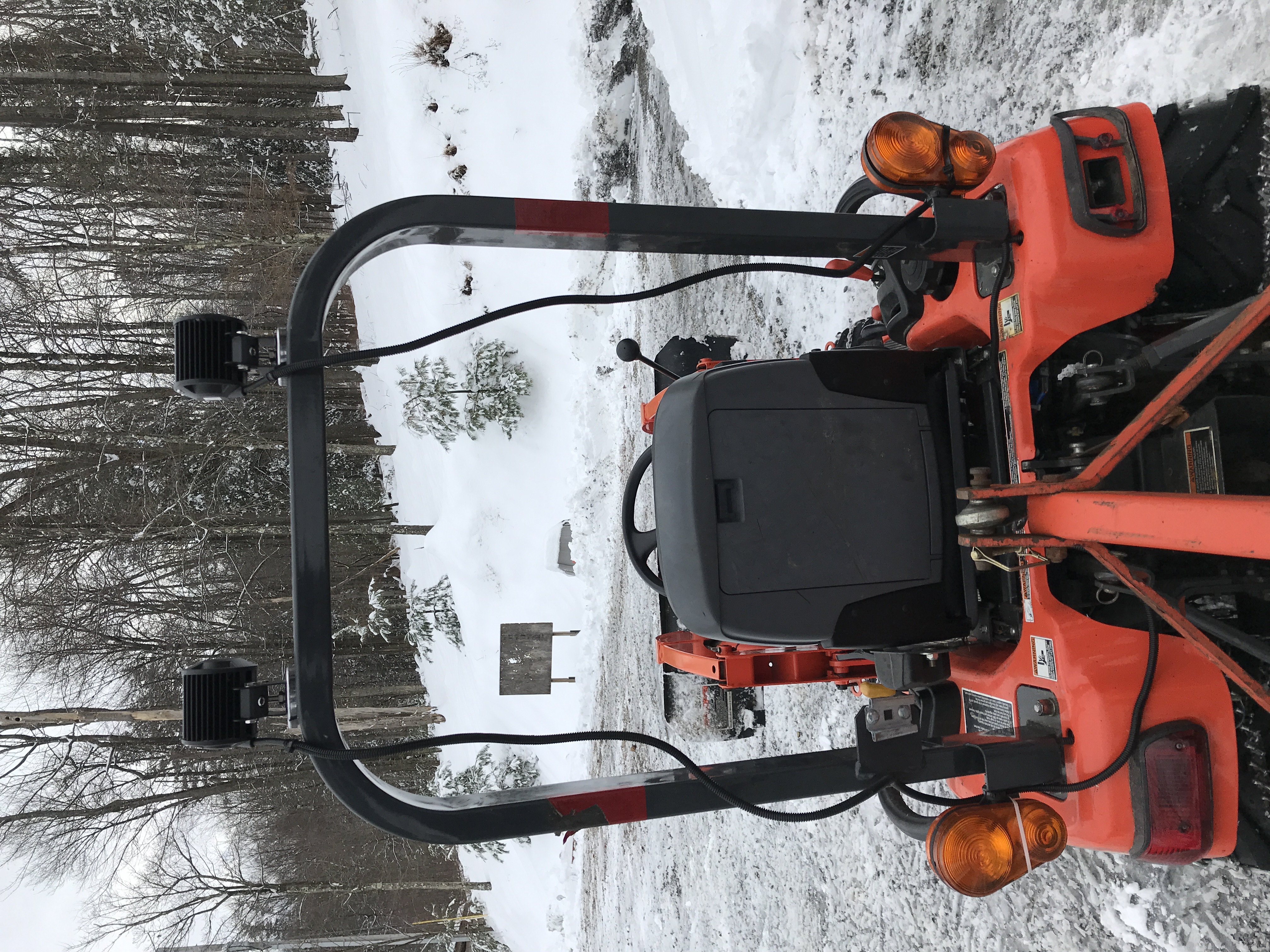

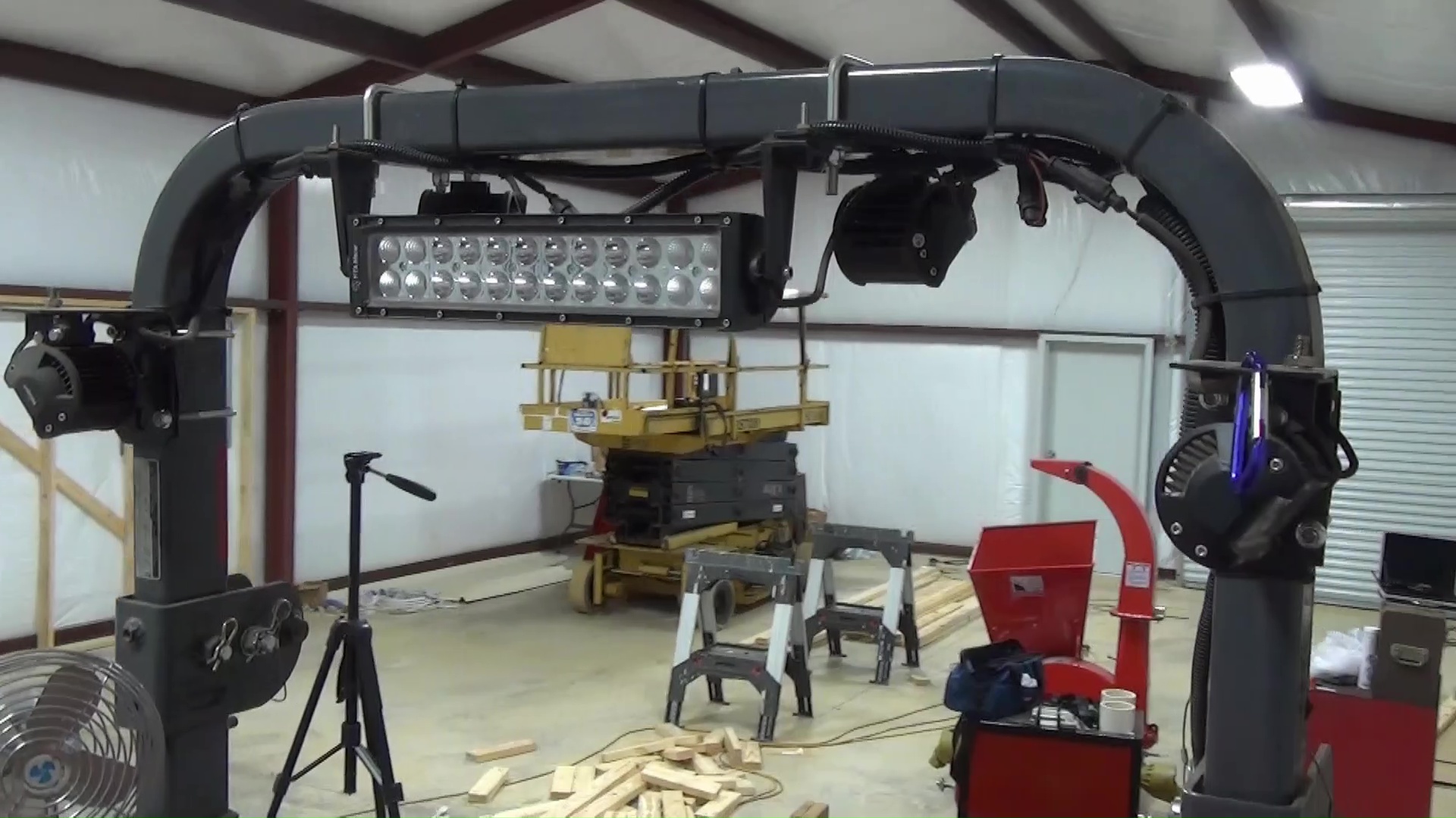

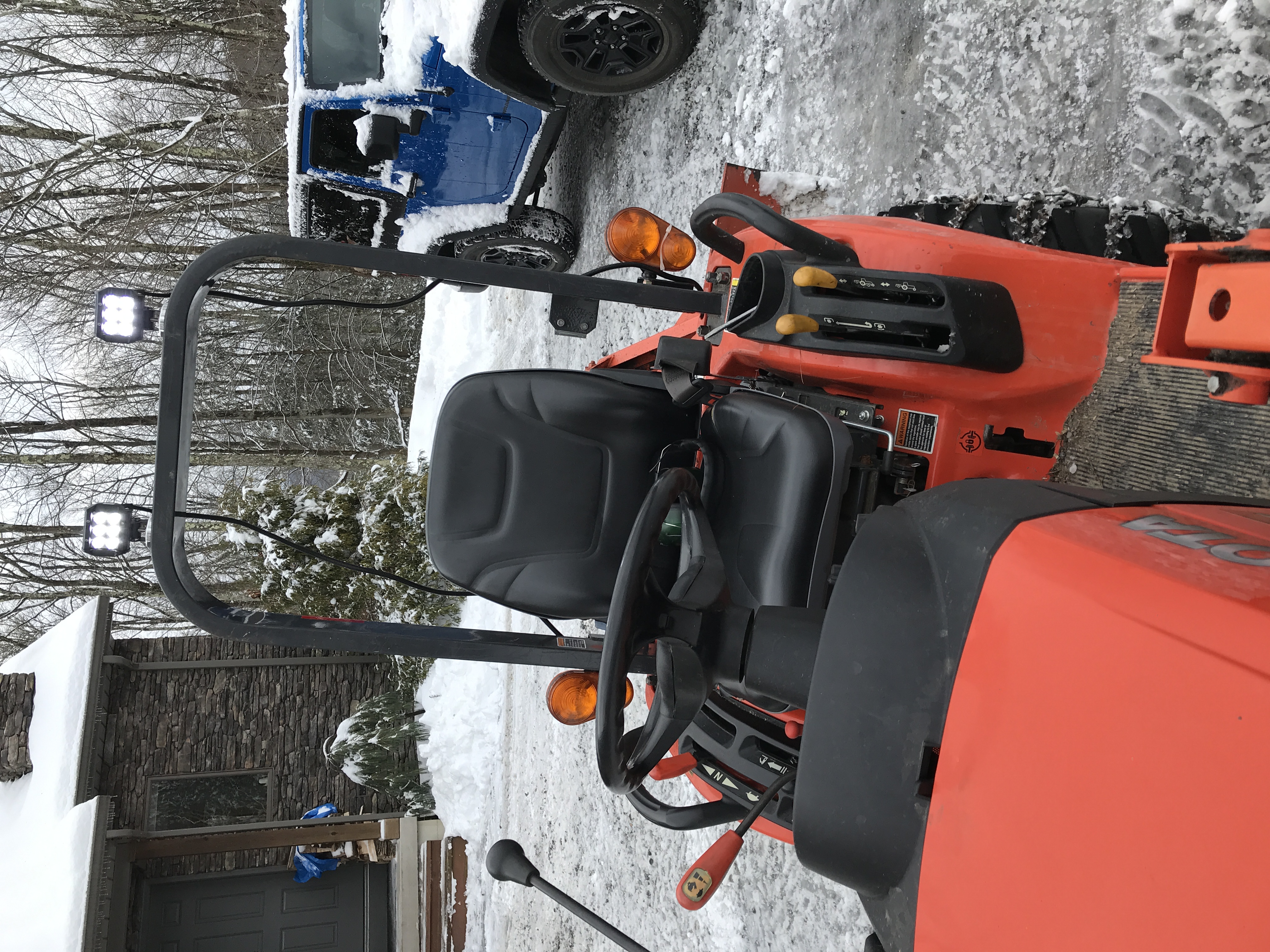

I have to agree with you! I used four of these on my tractor. They have been great so far. Two on the back for rear work lights and two on the sides for side lighting, plus a 14" light bar facing forward. This combination gives me a 360 degree view when working on the tractor at night. It works really well.
Here's a couple of pics:
And here a video on how I installed them:
Having the 360 view turns night into day.
