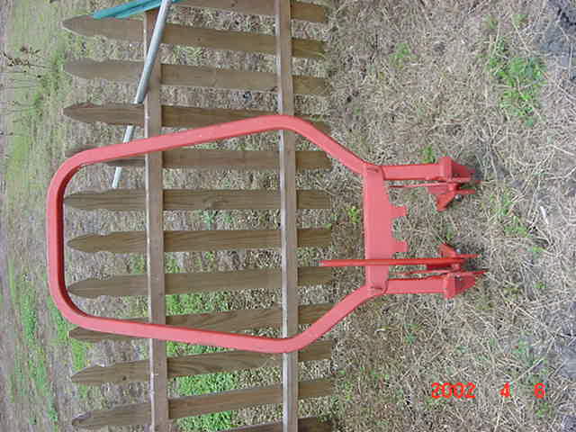

I saw a JD 770 today with a ROPs installed and it doesn't look like it would fit a yanmar. The rops is bolted to the rear of the tractor near the pto with some kind of plate. To make the JD rops fit any Yanmar, fabrication of adaptor plates would probably be involved.

clif,
That's exactly the bolting location and set-up I wish to use and that's where the dealer said I should bolt the roll bar on my F model. The roll bar needs to have a plate on the end that attaches to 3 holes on the sides of the pto housing. The middle hole is offset to form a small triagular hole pattern.
Can you get a picture of that 770 mounting location up on the board?
Hmm? Maybe I can get a picture up of the back of the F16D and you can tell me if that's what the 770 rops mounting set-up looked like.
   / ROPS Pictures/specs #30
Here is a pic of a ROPS I have for a 186D.
