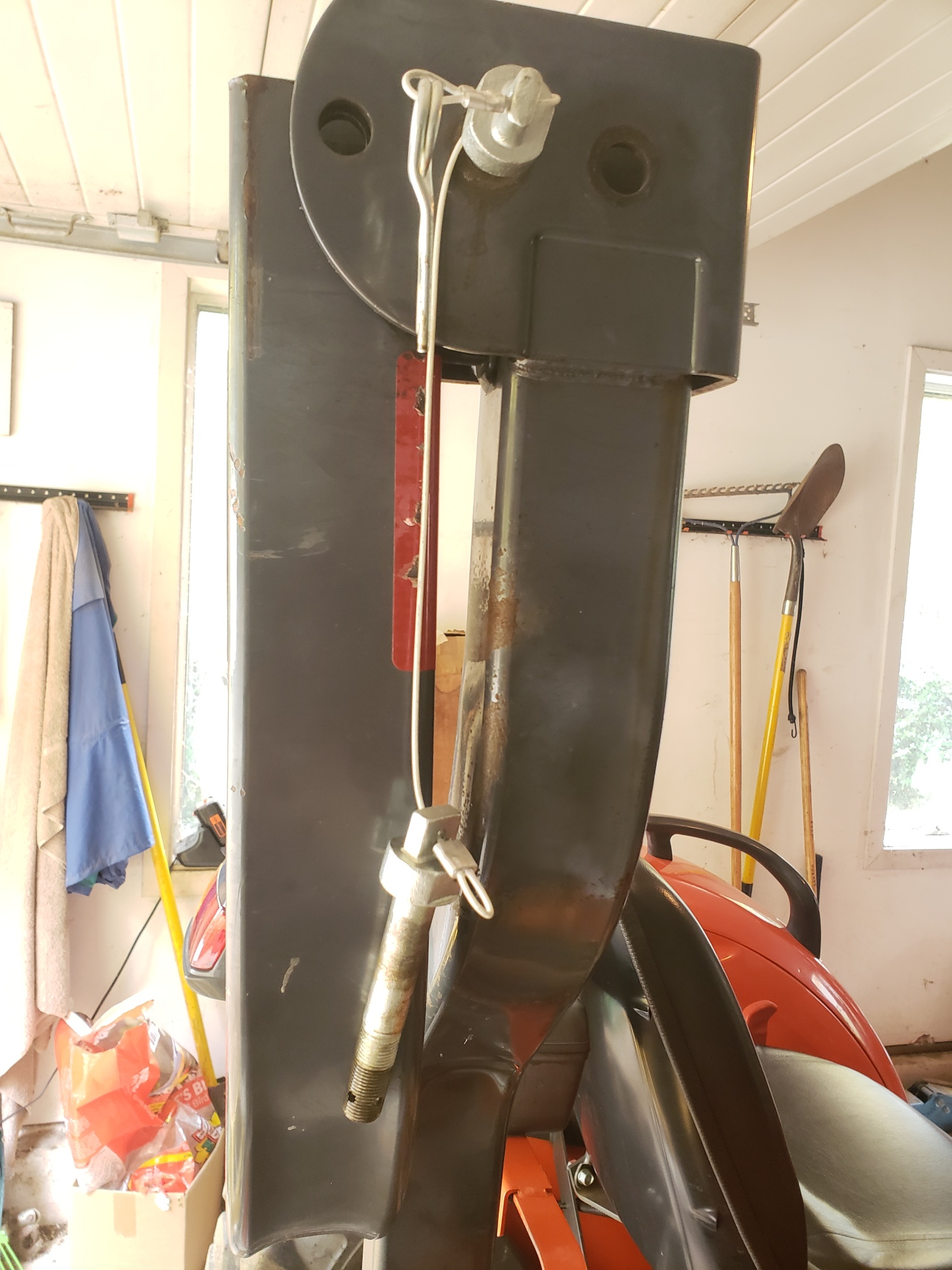

As I keep my 'new to me' L3800 in a garage I am constantly raising & lowering the ROPS (1" too tall for the door, ask how I know). The hardware was rusty when I picked up the machine so I ordered new from Messicks. I have attached an image of what they sent.
There has to be a better / faster way. There is no handle. I am thinking of cutting the keeper cable and welding a handle to the bolt that screws into one of the 2 welded nuts. It does seem backwards to me that the pivot bolt just slides through and is pinned, not threaded.
Did I miss something obvious?

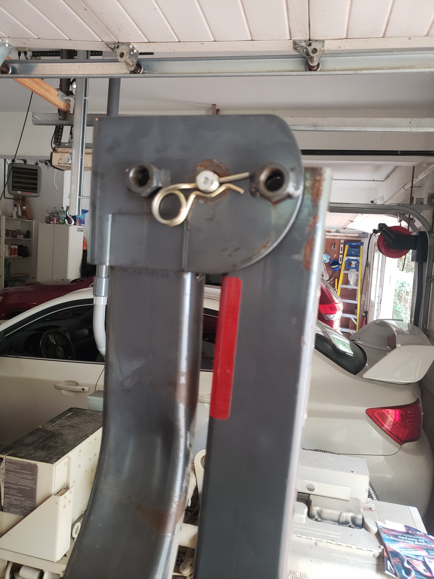

Does inside (no visible in pic) only have welded on nut for locking pin and no nut for pivot? Did I understand it correctly?
If it were me I would weld a loop or bar across the locking pin to spin in or out of nut and provide a better swivel arrangement for lanyard... Think I would replace pivot pin with grade 8 bolt and use nylock nut ...

sorry I should have included this pix of the welded nuts

That is not what is on my L3200, which is the same tractor except for the engine. Mine has a loop you can grab onto for a handle. I found that I needed to chase the threads in the ROPS with a tap before the screw could easily go in/out. Even brand new it was already rusted and sticky. I forget the thread size, but it's metric. I know it's been posted here on TBN before.

Still think I would replace pivot pin with Grade 8 bolt and nylock nut.... Not sure about the situation with the locking "bolt" other than make sure it threads freely, maybe weld on a lever so it does not require a wrench and be sure its "R" pin is inserted and on a tether so it does not get lost, a lost pin might tend to no get replaced.......

If the heads had some kind of handle this would be a non issue. Even a 1/4" X 3" rod welded onto the bolt head would have worked.

The 9/16" X 4" clevis pins referenced are a simple solution. Other tractor brands use smooth pins as ROPS hinge. Kubota is one of the few to use threaded bolts in an unusual size, encouraging purchase from Kubota at a very high price.
Measure to be sure 9/16" X 4" pin dimensions are appropriate for your L3800, though I am pretty sure all Kubota ROPS hinge bolts are the same.
Owner frustration with threaded ROPS hinge bolt appears here regularly if not frequently.
The ROPS alignment fittings mentioned in the reference are standard on Kubota Grand L tractors, absent on economy models.
"On the front of the ROPS there is a welded on nut on each side, there so one can insert a bolt as a stop, to line up the ROPS pin holes perfectly."

I ordered the pins last night - and unlike the usual for me I actually measured the ROPS to be sure. There must be some reason for the way Kubota did this but it's beyond me why :)

I think I would weld a rod to the end of the special bolt to make it easy to loosen and tighten. Put a "Z" bend in the rod so your hand clears the pivot pin. I see no need to cut the lanyard cable. I also see no need to replace the hinge pin with a bolt and nylon locking nut.

Before I went to clevis pins, I tapped an expansion/pressure/spring pin into the hole on each Kubota factory bolt for finger leverage. Worked OK.
Some days tractor vibration made the Kubota threaded pins so tight hand pressure was unable to loosen them and I needed a wrench.

I'd imagine its to prevent rattles, they just combined the bolt and pin together so you can tighten it down.
The B series use pins with clips for the lock pins but have a nut welded to the front for a bolt (or the factory threaded knob) to push against the pivot point and keep it from rattling.
