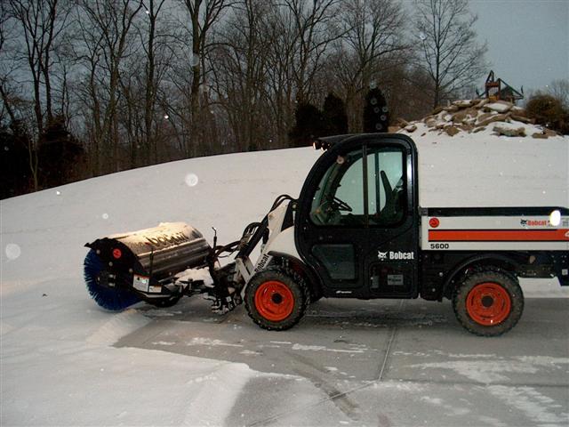

Hi Dylan
I've used the 68" Bobcat angle broom the last 4 winters to remove snow from a half mile long blacktop driveway. We typically get 3-4 inches per snowfall, so it's the ideal tool for that amount. The odd time we get 8+ inches I'll break out the bucket.
My broom has the poly bristles and they are still going strong...
See the attached images.

Four years! Wow, you must have accumulated some hours by now. thanks for the input.
