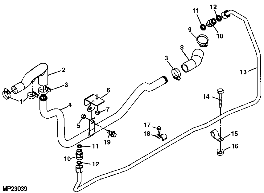

I would check te rubber "manifold" on the hydraulic pump. The suction line hooks up to this manifold. I have seen some of these develop a crack that will suck air. It is high enough that oil won't run out when not running. It is #2 in the diagram. Also check hose #8 for tight clamps.
Agreed. Fluid will look "foamy" while the machine is running.
This is definitely a part of the problem. The part is rubber, not plastic as I had guessed, and it is collapsing. I don't know why I didn't see that before. Thanks for the suggestion.
