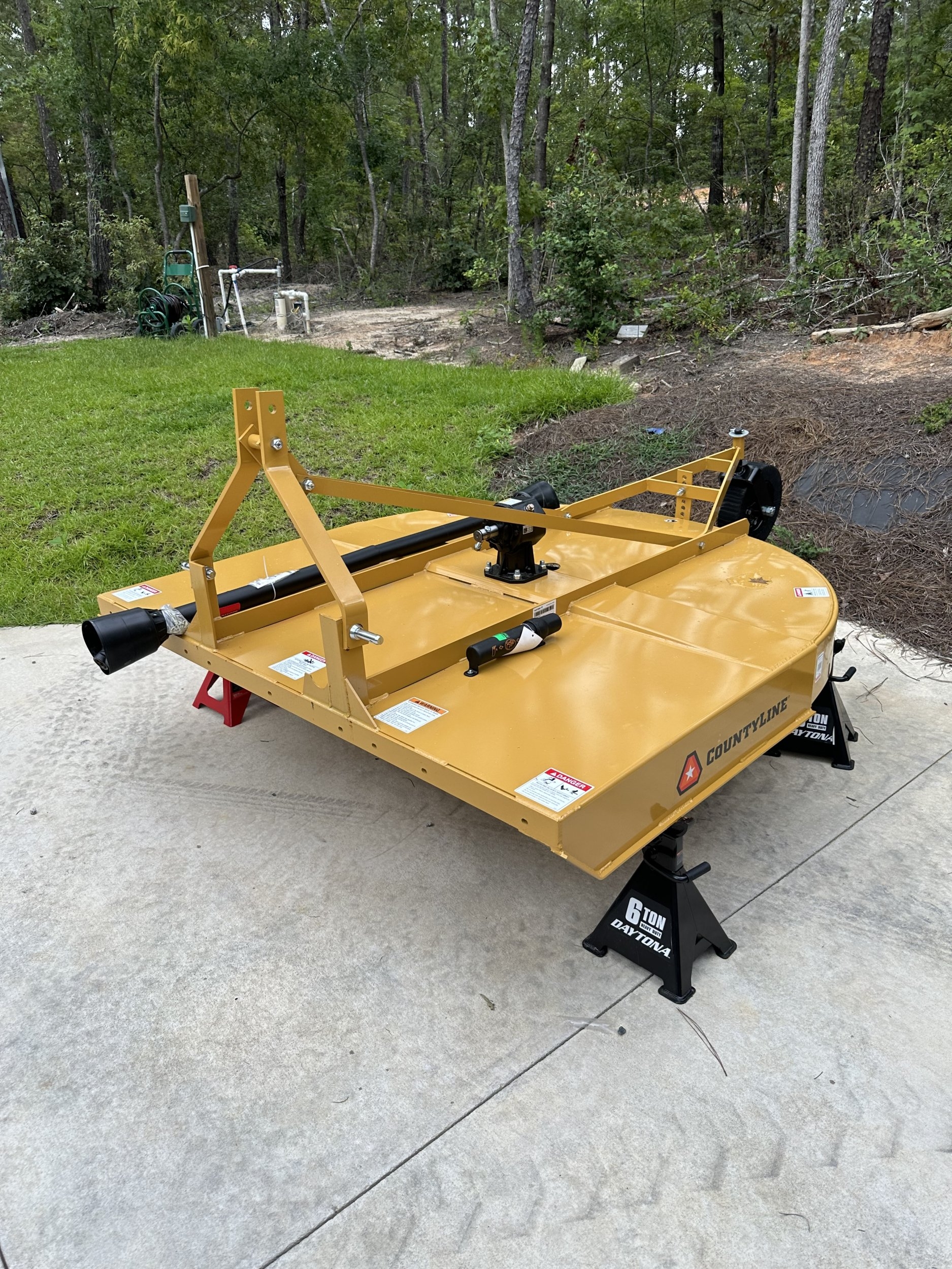

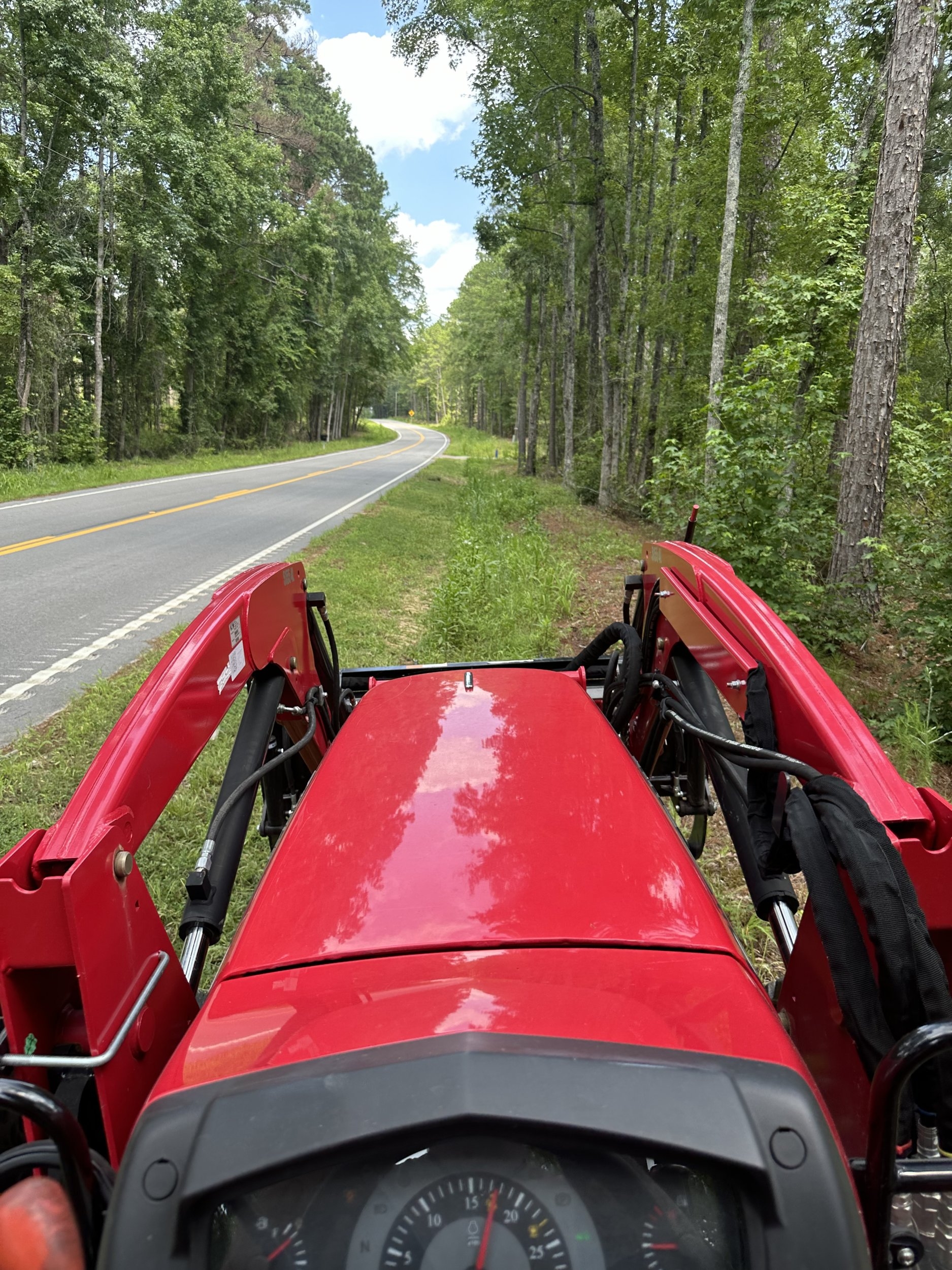

Well, I got the County Line (TSC) 6' Rotary Cutter all hooked up and made my first mow this weekend.
This is the first time I've used the PTO on my tractor, and it worked like a champ. The County Line cutter was perfectly balanced and ran super smoothly. I could not believe how "quiet" it was when I engaged the blades.
I was able to start slow, mowed my ditches / roadside frontage, then oved into some interior stuff. Forwards and Backwards, it worked well.
I kept my RPM's around 2000 to 2100, and it worked flawelessly.
I did break the sheer pin, when I hit a dirt clump that I did not see. Changed it out, and back at it I went.
I have the front / rear chain guards on order from Tarter Parts, once I get them installed, I will show pics.
So far, so good! I'm gonna get a lot of use out of this thing!
Front and Rear chain guards are ordered. This is the 200 series from Tarter, sold to TSC as County Line.
I found that 1800 to 2000 rpm on the tach, is almost perfect for the CL Rotary Cutter on my tractor. I have a Mahindra 5155 with 47 PTO HP at 2300 rpm... the gear box on the CL Rotary Cutter is a 45 hp gear box, so I figure 1800-2000 is about the sweet spot.
Gives a very nice, even cut... So far, I like it. My next add is a Hydraulic Top Link... that is coming SOON!

nice set up. do take caution mowing on your highway corridor, esp given the nature of multi tasking, poorly skilled drivers these days.
plus, always good to check the factory fill gearbox, often they are just minimally filled, regards

Mine came completely empty... but there were stickers on it, saying...
"You MUST fill gear box before use"... I used Lucas gear oil, took a full quart to get it all topped off. I will change out the gear oil after about five hours of use, just to get the break in oil out. Cheap insurance. I was amazed how quiet it ran, and how smooth.. the blades were balanced very well.

The real question is...at what engine RPM is your PTO turning 540 rpm?
