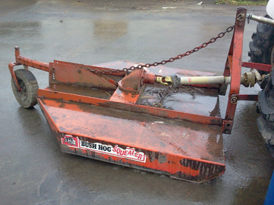

Sorry, Soundguy... the LandPride design is just plain weak. I had an old Bush Hog LIGHT DUTY model with a mono-Uchannel tailwheel mount and good welds with never a problem. In addition, the fork design is super weak--just a single flat bar bent in two places. I've broken/bent several of them, and I'm not that hard on stuff. If you go with LandPride and cut anything other than flat, clean land, you're going to have to do some reinforcing yourself and have some spares on hand, or you're not going to be in the field for very long.

Well, what can I say....? My land has old, harvested/deadfall trees, hidden by underbrush and saplings. If you're backing into this (even carefully--not bulldozing), you're eventually going to hit a trunk or a stump and put the tailwheel under stress. Every design on the market has its strengths and weaknesses. The LandPride machine has a good quality, heavy-gauge deck and good reinforcing. The hitch mounts are very strong and robust. The tailwheel mount, however, is weak. If a forum member is going to do some of the same work as I do, they might profit from making the tailwheel design a consideration, or planning to add some reinforcement, and adding a little slack to the sway chains to give some warning. Compare the difference between the LandPride design (right) and the older Bush Hog design, which I previously had.

i look at it like this. if backing my tractor an implement into a solid object.. I want the cheapest thing to break.. tail wheel mount is EZ to fix or make new... ( BTDT ) didn't take long.. nor was it hard... I don't want my 3pt pins on my trumpets to break off.. and I don't want my aframe to fold as they are harder to make right. and i don't want the deck to buckle.. some of the more economy units are just folded sheet metal anyway.

There is no question that the LP tailwheel design is less stout than many of the others. Is it strong enough? That depends on the property and the operator, I guess, but the LP could be signifigantly reinforced without adding too much weight. And out back that far, weight would be a consideration for me. A couple of triangular gussets between the arms, with a few holes to lighten the load should do it fine.
