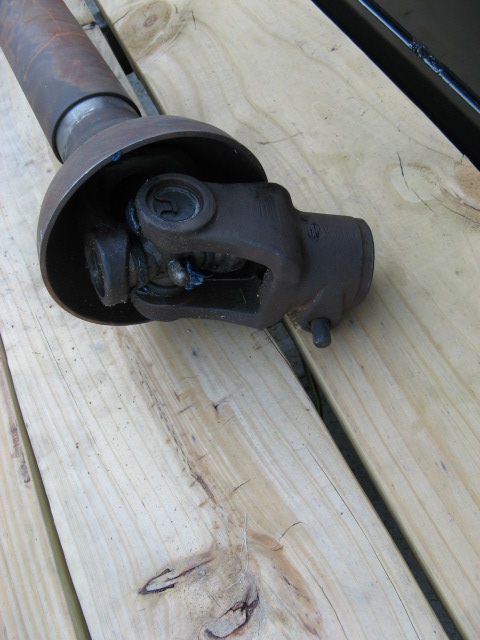

TO THE OP: Please post a photo of your bush hog PTO shaft with particular attention at the end where it attaches to the bush hog gear box. That is where the shear pin will be located.

This is a photo of just one end, but both ends of the shaft are identical:
In fact, I am not sure which end is supposed to be the tractor end, and which end is the cutter end. The cutter gearbox has a splined input shaft identical to the PTO output shaft of the tractor. The cutter gear box input shaft is not smooth.
Neither end yoke on the shaft is set-up for a shear bolt, in the manner that this yoke is:
1486037 6 Lc6 Shear Pin Flange Yoke

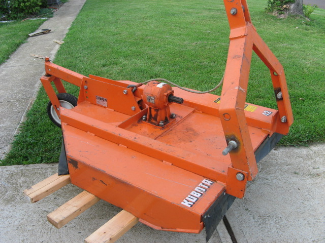

Not a good close-up, but this is the cutter. One can barely see the splined input shaft. Definetly no slip clutch or shear pin @ the cutter gearbox. And nothing on the driveshaft itelf.
The guy was simply running it without any overload protection. But, I don't think it was run very much. The tractor that it was used with developed a bad case of black sludge in the fuel system.
In my opinion those cutters that have the 1 3/8 splined input shaft are setup for a slip clutch. Some one has removed the slip clutch and just put a 1 3/8 to 1 3/8 shaft on it so you have no protection at this time. You need to buy a slip clutch and fit it to the cutter.

That scenario would make sense: the cutter was purchased new by someone who used it very little, and it sat for several years before a second person bought the tractor & cutter. I am the third owner of the cutter, but the tractor had already been traded-off by the second owner (who could never get all the algae cleaned out of the fuel system.) I would bet it is likely that the slip clutch was on the tractor, and went with the tractor. I say this because i also bought a 5ft angle blade that had been part of this package, and the blade came with the top link from the original tractor, so I imagine that parts and pieces were not staying where they needed to stay. That would all make sense.
   / Rotary cutter / "position control" #20
"...In my opinion those cutters that have the 1 3/8 splined input shaft are setup for a slip clutch. Some one has removed the slip clutch and just put a 1 3/8 to 1 3/8 shaft on it so you have no protection at this time. You need to buy a slip clutch and fit it to the cutter...."
Normally the slip clutch stays with the rotary cutter,/PTO shaft. the slip clutch usually has half of a PTO yoke on one end and a 1 3/8 splined female fitting on the other. But for some reason, they removed the slip clutch and found an old PTO shaft with 1 3/8 on both ends and put it on, or something similar. In any case you don't have any protection. so if you hit something immovable, something is going to break. It could be PTO components in your tractor.
