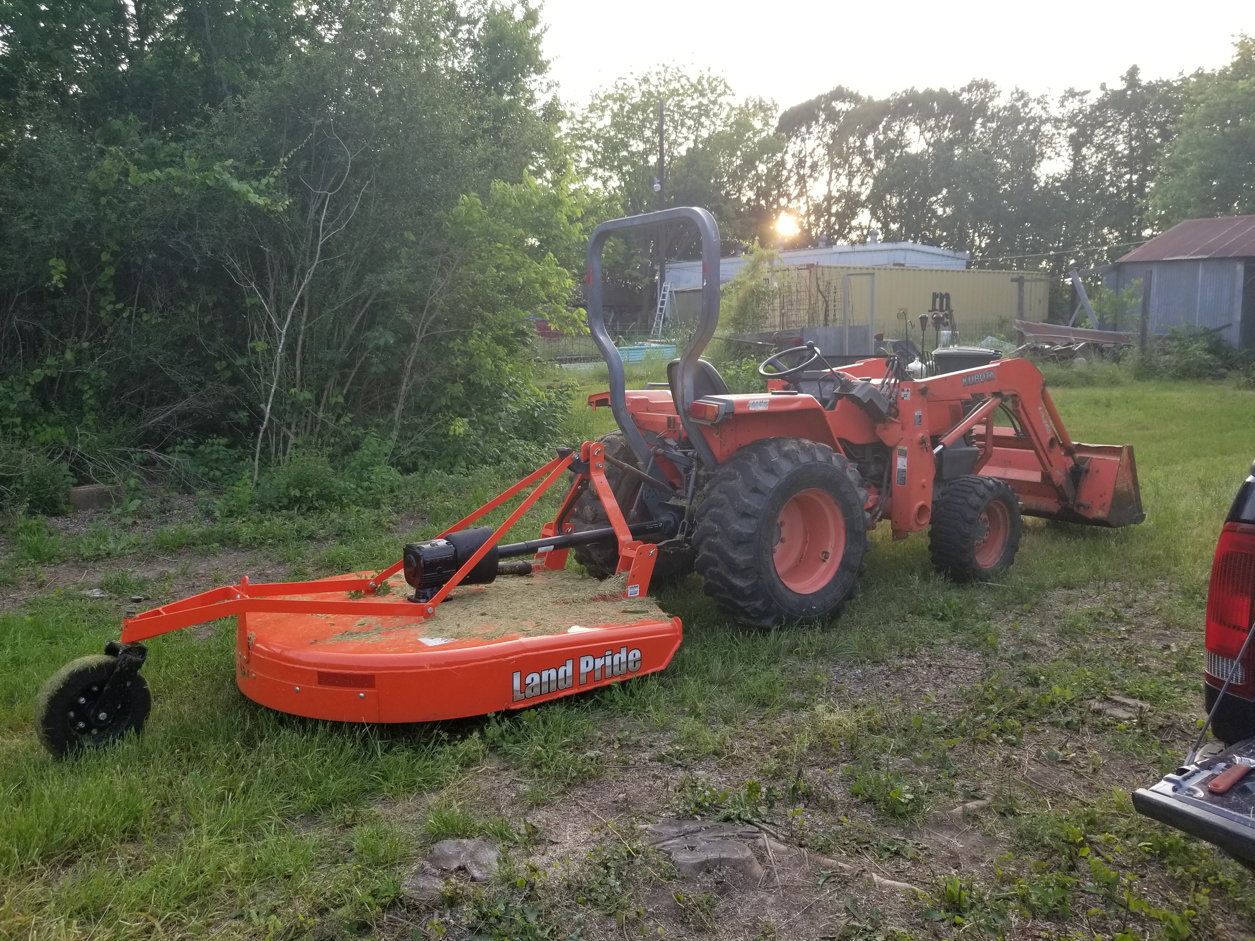

I picked up the shredder today, and am thus far pleased with the decision to go 5' vs 6'.
I found that with the high grass, I could max out at 2 HI (could get away with 3 HI maybe, but the land isn't straight enough). When I did go up to 3 HI I found it was fairly easy to bog down.
I didn't really understand what "bogging down" with a tractor was all about beforehand, until I actually experienced it. Ig basically acted like it went past a point in which it could cut, and the clippings must have built up, as all of a sudden the RPMs would just start dropping until I slowed down, it felt very odd.
My conclusion is indeed that the 6' would have "worked" for some definition of work. With the gear driven L3400, I would recommend you do your best to do a try run. I had no personal reference to know how the combo would have worked.
Jeff9366' post was spot on, I don't think I would have been pleased to have to max this thing out to maybe cut its full width. At least I can go fast with even the initial cut.
I'm glad for the 10ga deck, compared to some other models.

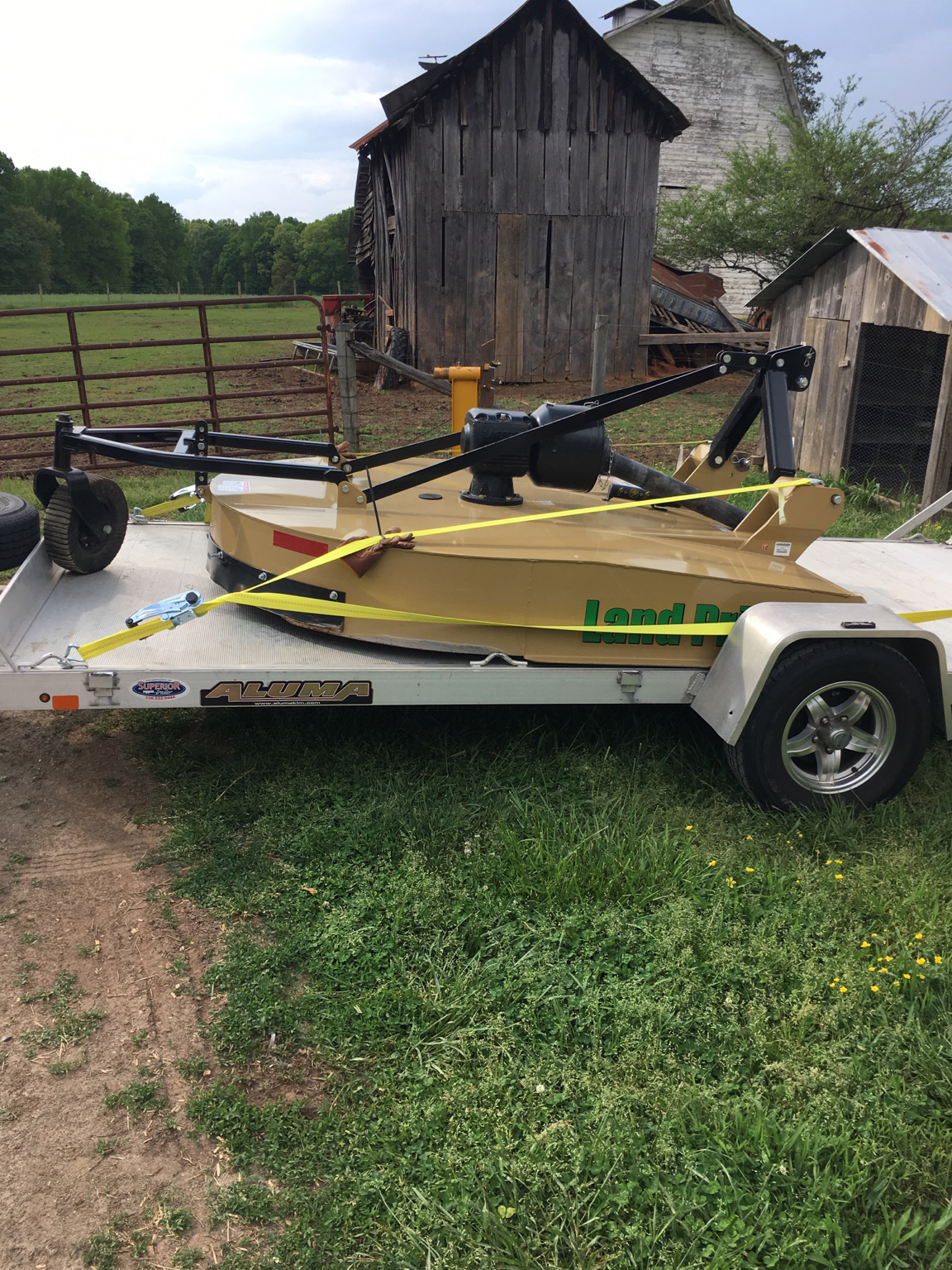

This is a mans shredder. Just picked it up this week. Cuts up to 4" material. . I would call it a heavy duty shredder. Lol
Nice cutter sawtooth. Did you get that unit off Craigslist? It's almost impossible to find a cutter like that used. To say you did good is the understatement of the year.
I spent more time looking at your trailer than the cutter. Can you give me the specs of it?
Nice cutter. I have a 15 year old BH squealer 72" and I think it's similar build to your land pride. 10ga deck etc. it's been great and I would call them a med-light design as they make a lighter version as do a lot of companies. I cut some 2" material and have for years. Key is to go slow and only cut one at a time. Also to your question on a earlier post I will add that buying too much gearbox has its downside. Reason being is they are harder to turn as they are less efficient in transferring energy through them. On a positive note they can reduce more of the impact energy from transferring back to your tractor pto during high energy impacts etc.
