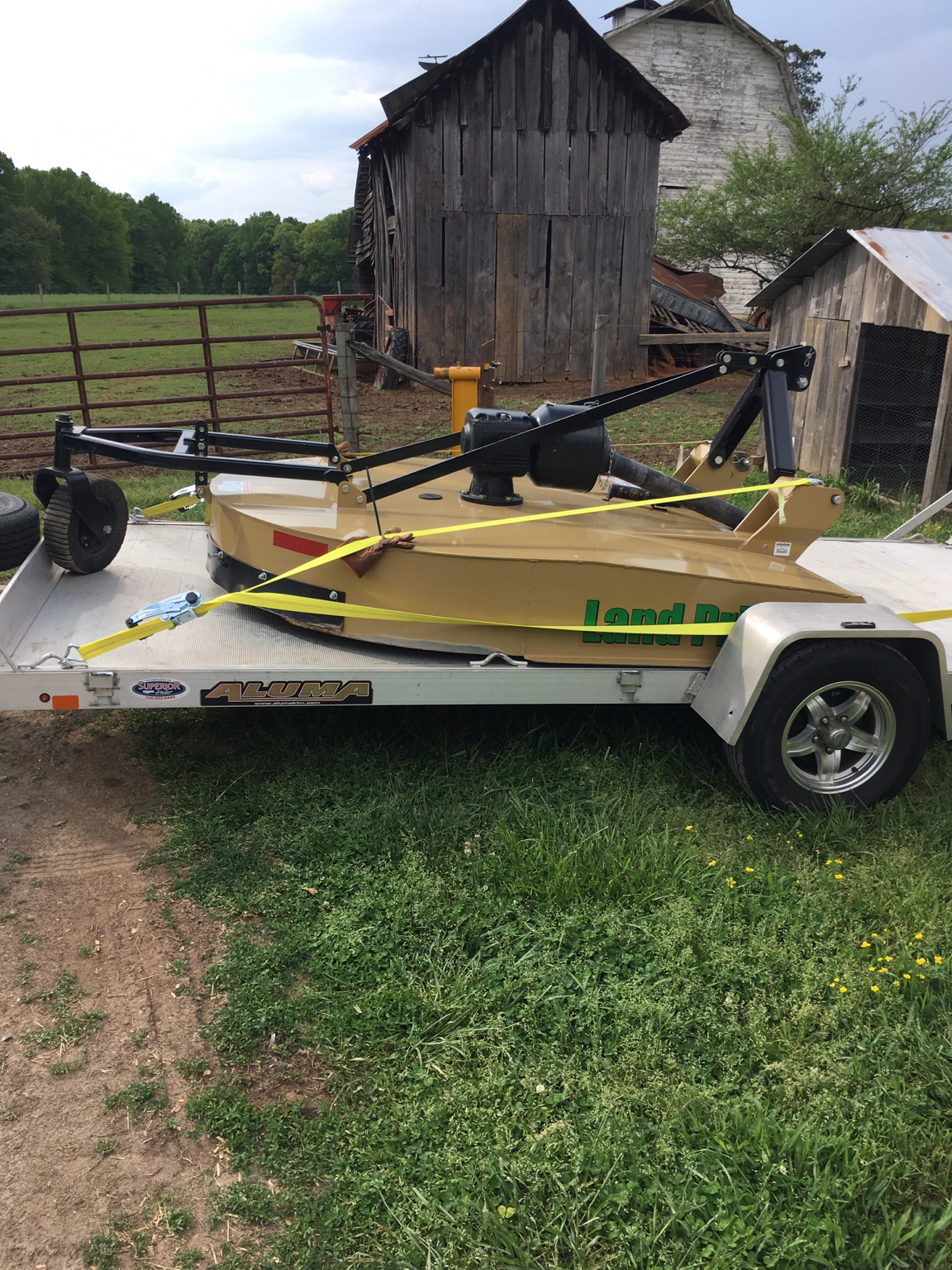

I got a decent deal on the land pride rcf2060, and decided I'd rather cut 5' well, than 6' poorly. It also has 10ga metal on the deck, which was heavier than my father in law's shredder.

This is a mans shredder. Just picked it up this week. Cuts up to 4" material. . I would call it a heavy duty shredder. Lol

Good question and one I can't answer yet. I'll be using a 1983 Ford 5610 MWFD cab tractor with loader. Not sure I will see anything that big but will make contact with a lot of 2 and 3 inch material and possibly some 4". Main reason I bought it is its barely used and I picked it up for half price of new one. I couldn't believe how heavy just the driveshaft is. It's a cat 5 shaft. The gearbox is absolutely a monster. Hope I have enough horsepower to turn it. Lol.

Is that a 6' cutter sawtooth? Your 5610 will do fine. That's a mans cutter right there! I'm guessing it's an RCF3572? Or 3672?

Yep rcf3572. Never had land Pride equipment before but it looks to be made well
