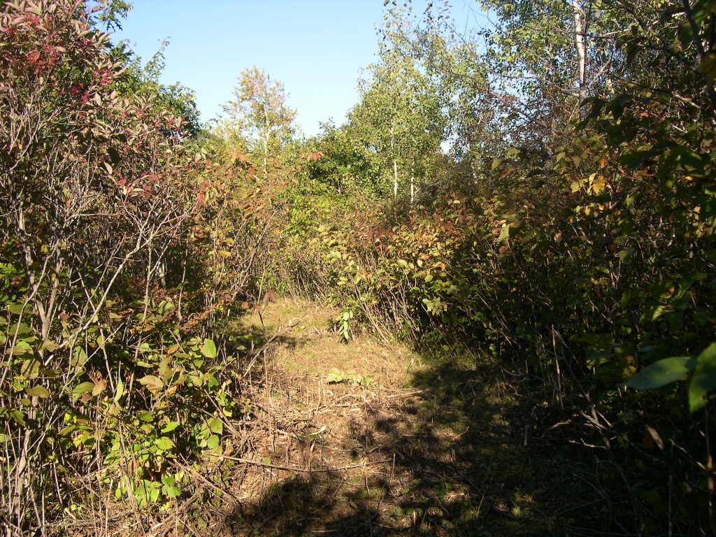

I've been looking at and have started to price out rotary cutters and wanted to see what all of you have to say. I have just purchased a new home with 35 acres and theres a old field on it about 8 acres . Its starting to get brush and small pines growing in it. Id like to mow it and the trails on the property eventually hay that field but thats a project for later anyways. So I have a 2007 john Deere 110tlb it has 43 hp and ive been trying to decide if I want to get a 5 foot or 6 foot cutter. Also Ive been asking the john Deere dealer about the frontier cutters john deere sells but they haven't gotten back to me yet the other cutter ive been looking at is king cutter brand. The local Runnings store sells them i'm just worried that they are as well built. So if anyone wants to recommend size or opinions on brands that would be great thanks much.
