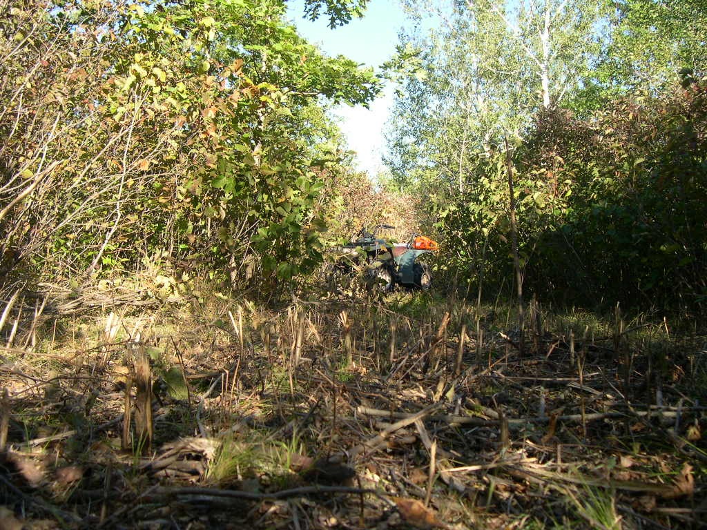

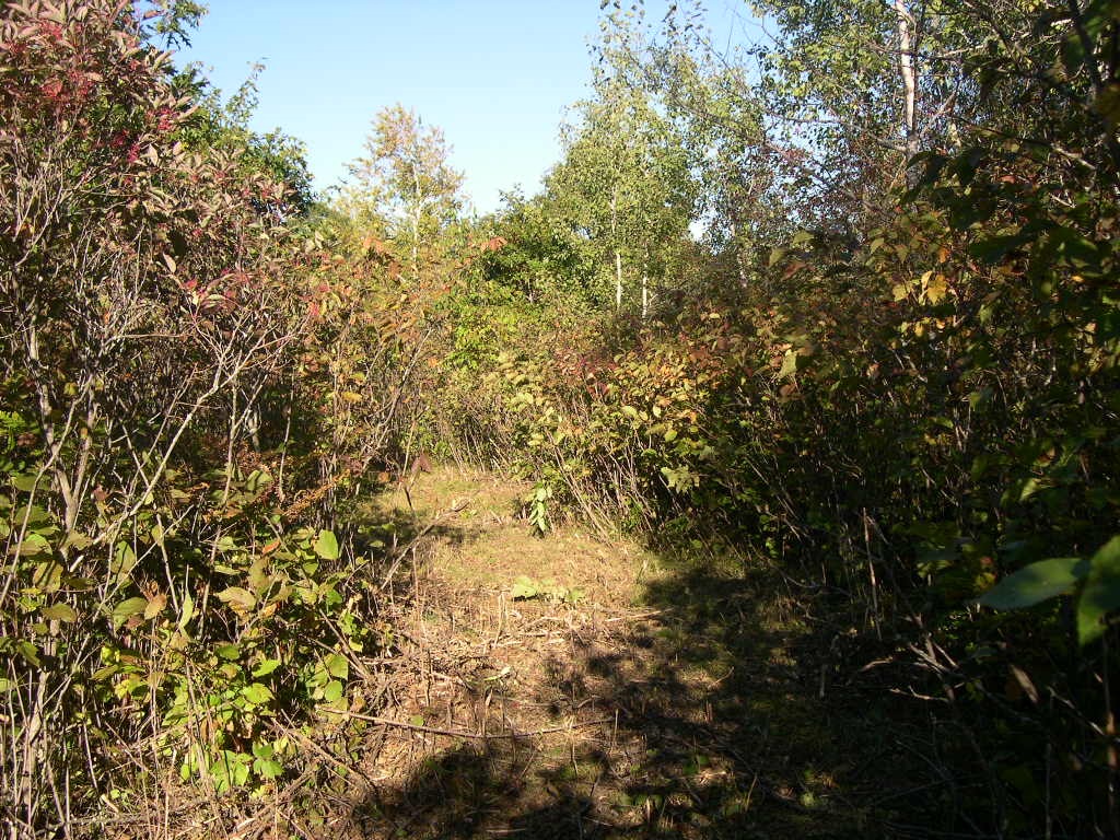

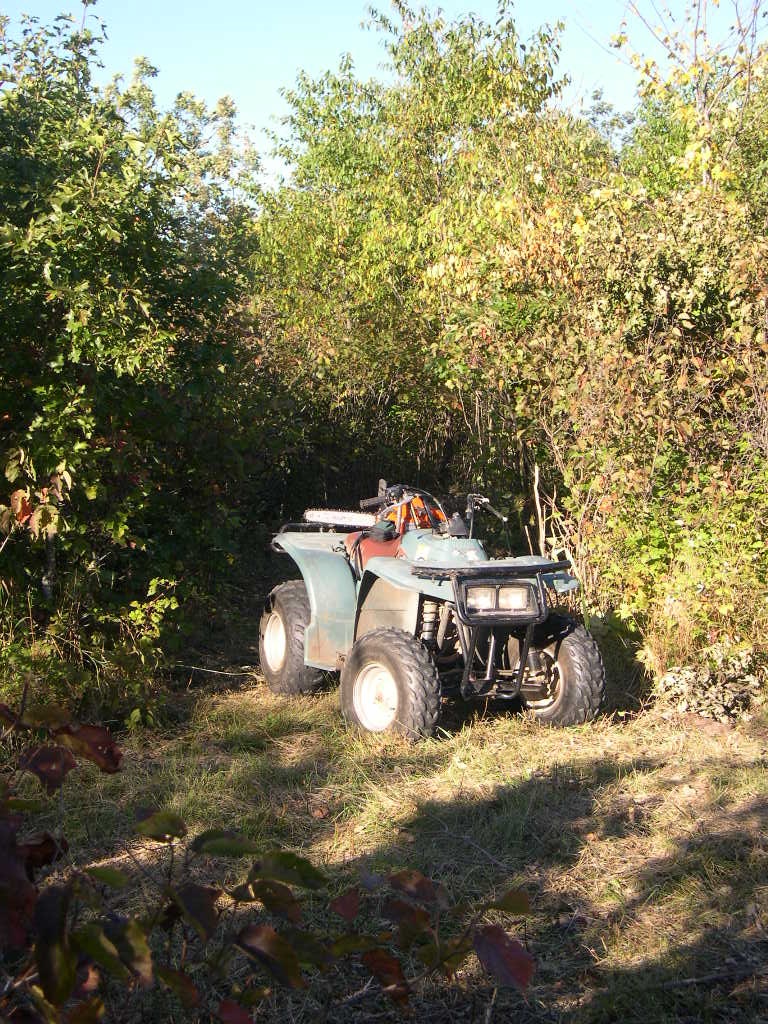

I cut heavy brush with a 15hp tractor and a 4' Kingkutter to make trails. After that, it was a matter of cutting light brush and tall grass to maintain trails. If you're always cutting heavy brush, you are not maintaining/cutting frequently enough.
Again, I had zero issues with the Kingkutter. Obviously, I took t slow when cutting a trail for the first time. It just takes a little common sense - you just have to listen to your mower. Some people just do everything wide open and break equipment.
If the OP has the $$ to buy better, I think that's great. If not, buy what you can afford, be responsible when you operate, and get a lot done.
