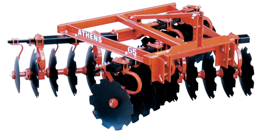

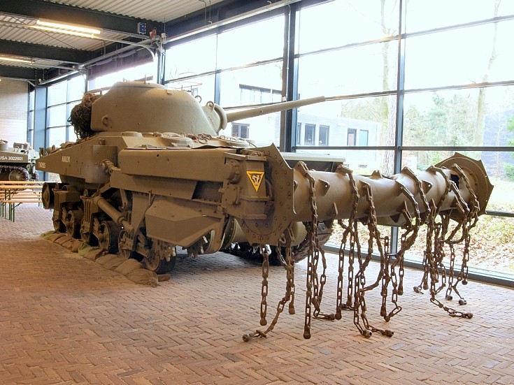

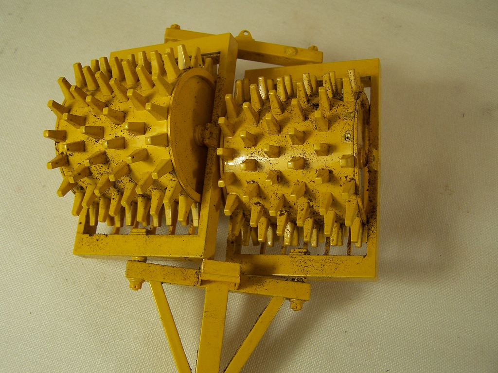

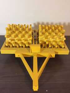

Just some more options.
The first one should be interesting! The last one most easily tried. The in between ones come in different sises. Pulling uphill may be an issue with the last three.
   / rotating spiked ice breaker #12
Dude! I'd love to see a video of that first one in action!
   / rotating spiked ice breaker #13
The first one should pull the second and third ones uphill, no problem!

Egon those middle two are kind of what I had in mind but just less spikes and with weight above them. The two "wheels" would be spaced further apart to about the tread width of a car.

Looking at that second pic, how about a 45 gallon drum filled with cement, and then driving rebar spikes into the sides before it dries. Should be plenty heavy or a two foot diameter pipe instead.
   / rotating spiked ice breaker #17
Great idea- relatively cheap and fairly easy.
