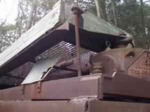

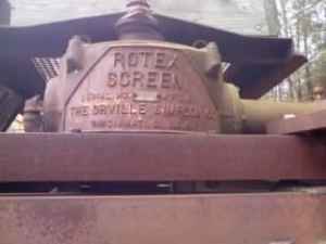

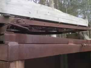

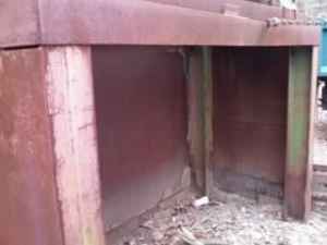

Looking for some guidance, found a guy who has a (very) used Rotex Screener for sale for $3,000.00. It has a 3/4 screen, is 9' long. 3-1/2' deep and about 7' tall (way to tall for my B3030), but I can cut 2' off the bottom to make it usable.
The only thing missing is a horizontal shaft, gas engine with a pulley. The seller bought it and never used it, he says an 8 - 12 HP motor will do the trick.
Anybody have any experience with these things and is $3,000.00 a fair price??
Thanks, Bigman
   / Rotex Screener #2
Could you buy some 1" rebar and make your own screen and suspend it on some automotive coil springs and rock it with a rod connected to a riding mower wheel or car "steam locomotive style?
Or is the thing worth $3000 in scrap steel? You said it is very used, but what is there to wear out on it (besides the engine which is no longer with us)?
   / Rotex Screener #3
I'm having a hard time picturing what this looks like... got pics? Is it a flat table or one of those 'rotating tunnels'?
   / Rotex Screener
I did not take pictures, it was raining heavily when I looked at it, so I copied his pictures. It's a big rectangle, with the 9' side open so you can scoop up your material, the screen is about 7' long by 3' wide and is tilted, The rotex drive actually shakes the screen side to side, the 3/4 material drops thru the screen to be scooped up, the larger material is shaken down the length of the box where it drops of the 3' wide end to be carted away. It's actually pretty neat, the bottom is rusted/rotted, but I would cut that off anyways to drop the height down to about 6' so I can load it with my B3030. I do not have the time/skill to build one myself, but it would be a large improvement over the one I made out of 2x3's that I have to stop and clear off constantly. I will post pictures of the one I made in another post.

Those pictures are hard to see the entire machine. I have a few questions, what type of frame is it on? is it on wheels? is the only thing missing is the drive motor?
Cutting the bottom off to shorten it is a bad idea as this will limit your thru put i.e. you will have to move the processed material more often, a better idea would be to not shorten it, but build a ramp up to it so you can reach it with your loader. I don't know how much material you have to screen,if it isn't that much it would be much cheaper to rent a screen for a weekend to do it with. Just my 2 cents..
   / Rotex Screener #6
It looks like a flat, or nearly flat shaker table. The gearbox assembly that says Rotex on it appears to have an eccentric attach point on the top that provides the shaking motion to the table. I would think that the screen should have some sort of angle to it so the greater than 3/4" separated material would move to one end and fall off the shaker.
Looks pretty well used. I know for a $3K budget, I could build one heck of a nice separtator...
