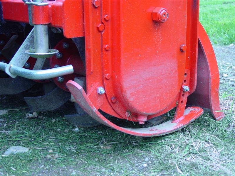

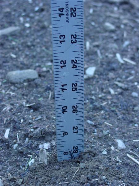

I really think Garabo had his 3PH set up incorrectly and/or his drivelines were still too long to allow for a full range of 3PH motion. I took some pictures related to my CCM
M-160 (58") tiller. Picture# 1- I easily tilled ~8" in depth.
Picture # 2- shows the lower skid plate and the gearbox cover oil drainplug. Jay
Now this is the first plausible reason for it not lowering that i have seen - may not be the reason, but it could prevent the tiller from lowering because the PTO shaft is too long.
