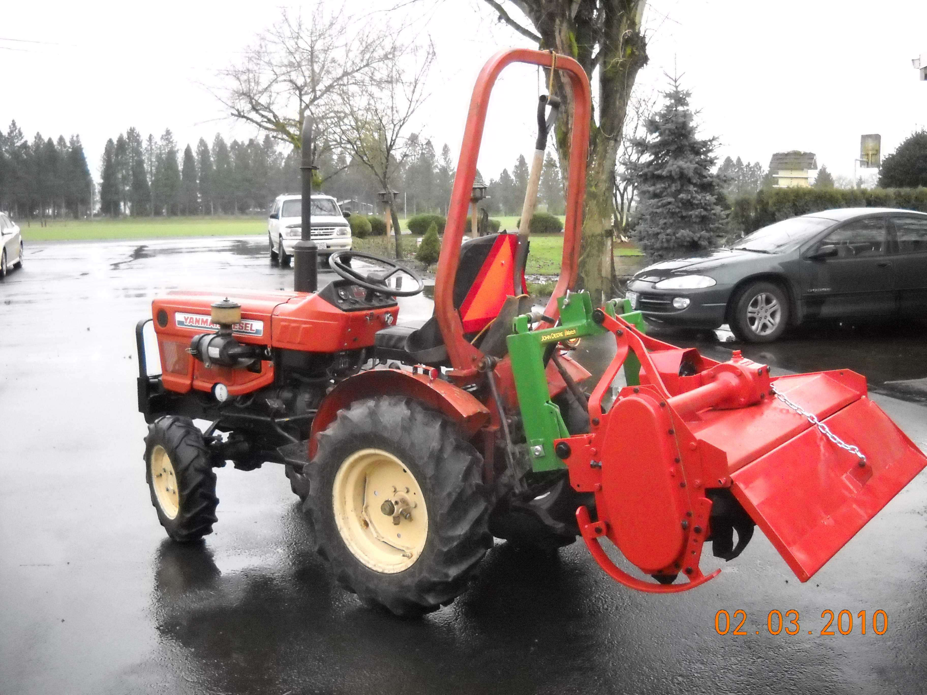

I only payed $150 to compleatly restore my Agric Tiller. I guess I was at the right place at the right time. I got it for free from my neighbor after it was in a barn fire. Hooked it up to my little yanmar and it works great. From the sounds of it on here, the KingKutter is the way to go. They definatly make durrable implements that will take a beating. In my case, I get to expand our garden tomarrow so i can get the tractor in there. My step Dad is gonna love using the tractor over the walk behind tiller he bought last year. Good luck with your purchase.

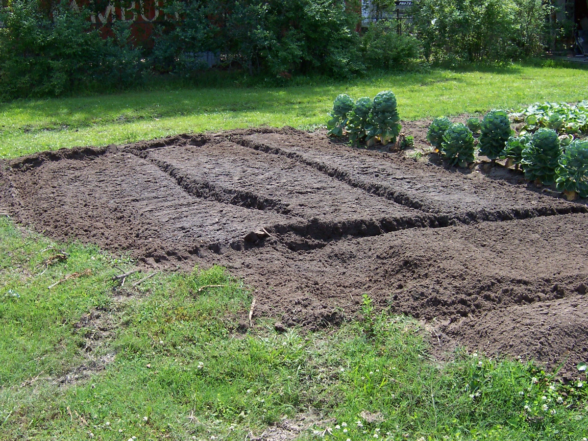

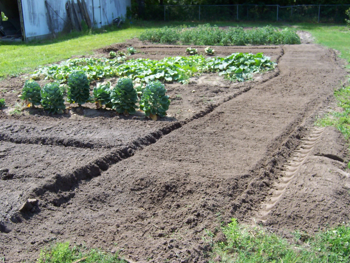

I found a used Caroni 4'er last spring for $600. and it was worth every penny! Knowing now how great the tractor tillers work now, I would pay the money for a new one if I had to.
This tiller chews up the soil so well that it looks almost like saw dust. It makes my walk behind look like a toy. The pic is from last spring, you can see how fine the soil is and I don't run it at full PTO speed.
I'm also tilling a small plot for a friend up the road, you might try to swap out tilling for friends and neighbors to justify one.
