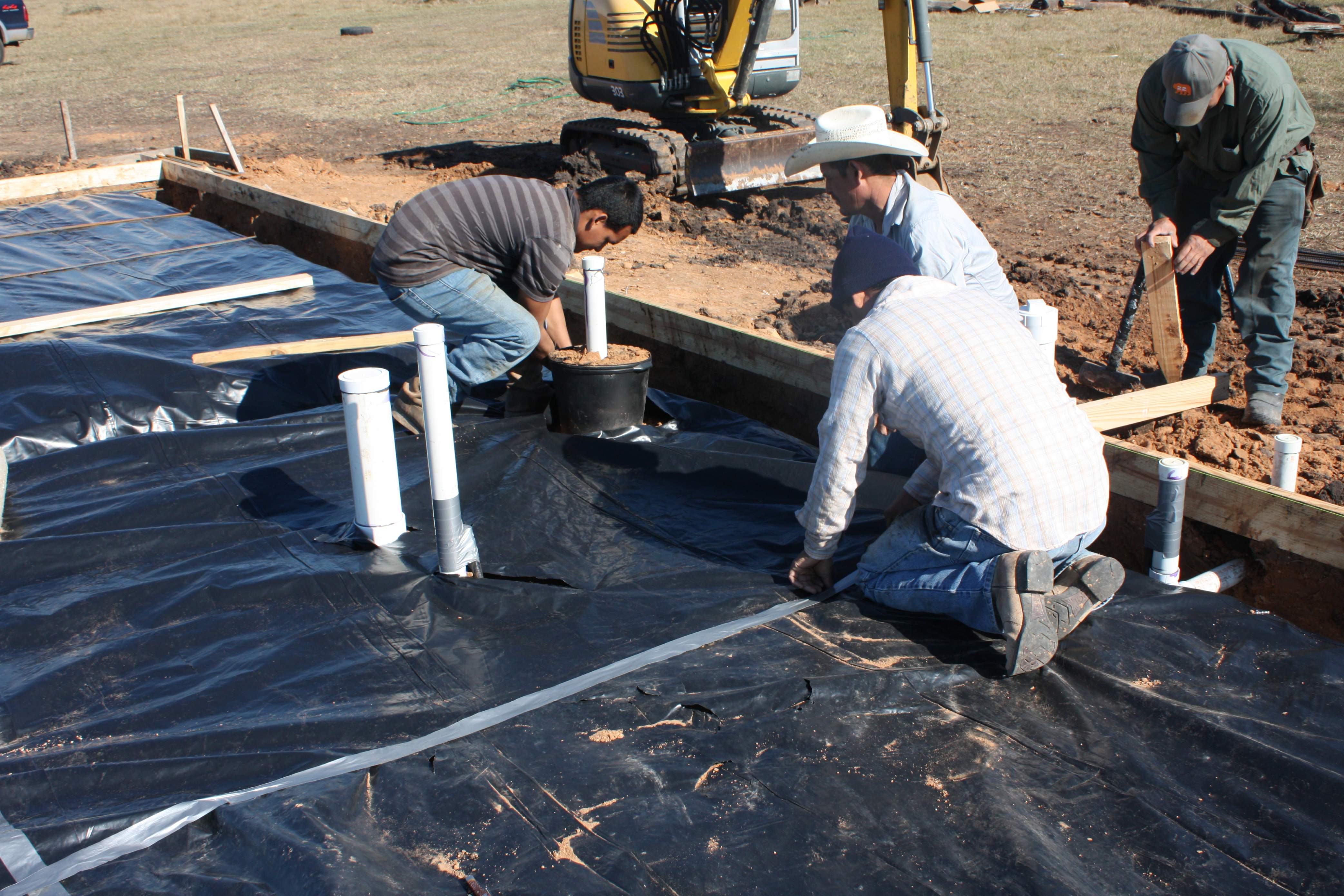

Question: Is it ok to do zero work for a lavatory - then tie the lavatory in after concrete - by doing all work in the stub wall?
Kitchen - one stub for drain, one elbow, one pipe for waste. They said they would do the cleanout above ground. I had I had them do a cleanout on the exterior - it is what we originally discussed.
Bathroom -
- Waste: There is one pipe for waste - it has a cleanout on the exterior of pad.
- Shower: Drain is in the right location - measurement allowed for concrete lip, column/girts, then a stub wall - I believe it will work. They boxed the stub so we/they could move an inch or two after concrete (if need be). We're doing a fiberglass enclosure. They did one additional pipe for the vent.
- Toilet: Drain is in the right location. They used 4" pipe - they claim the flange will fit inside. They tied the vent pipe to the other vent pipe.
- Lavatory: They dug the trench. They told me they would pipe it. I walked away to talk about schedule for concrete and then I took a business call - I came back and their truck was loaded and the dirt was flat ready for the vapor barrier. They literally filled the trench back in. I asked what they were doing. They said it was perfectly legal and would pass code. They claim they can tie in the lavatory above ground using an "arm" or something like that... they say they will tie in to the vent pipe inside the stub wall. They left. I called the Owner of Plumbing Company while the concrete crew packed it down, put down the vapor barrier, did the rebar. I was trying to be diplomatic so I dont jeopardize any relationships - he said it wasn't a big deal. They do it that way all the time. He said the same thing as the crew; legal, will pass code, can fix later.
Please let me know if I need to lift the rebar and put the drain pipe in? It is what we discussed. It was evidently gonna be a pipe - there was a dang trench there when the owner was still there - I even have pictures. Anyone? Again - don't slam me. I know I waited too long. I don't need the abuse - not today. ;) Not in the mood! :mad:

It is not unusual to tie a sink drain into the vent pipe and do it all inside the wall above grade. I didn't see anything that sounded way out of line to me. Your good.
MarkV
   / Rough plumbing - under metal building HELP! :-) #26
As MarkV stated, totally legal and also provides a wet vent, when draining the lavatory the base of stack will get washed.
4" stub up for toilet, good thing as he stated a 4"x3" closet flange will fit like a glove inside the 4". It keeps the pipe solid rather than wrapping a 3" to accommodate the flange.
Not knowing your exact floor plan, I would think that is a 2 vent job, 1 for kit sink and 1 for bathroom group.

As MarkV said, you're good. Sink doesn't need a direct line and has it's own p trap so tying in to the vent stack is fine. Done that way in houses frequently. Presuming the "vent stack" at some point ties into the main 4 inch drain line which then goes out to the septic tank?

I need to stop thinking about it. I know better! I know things will usually work out. I think I'll start doing my research now on how it will be best to finish up the above grade work. I'd like to do some of the work if possible. Thank you again!
Here are a couple pics.
