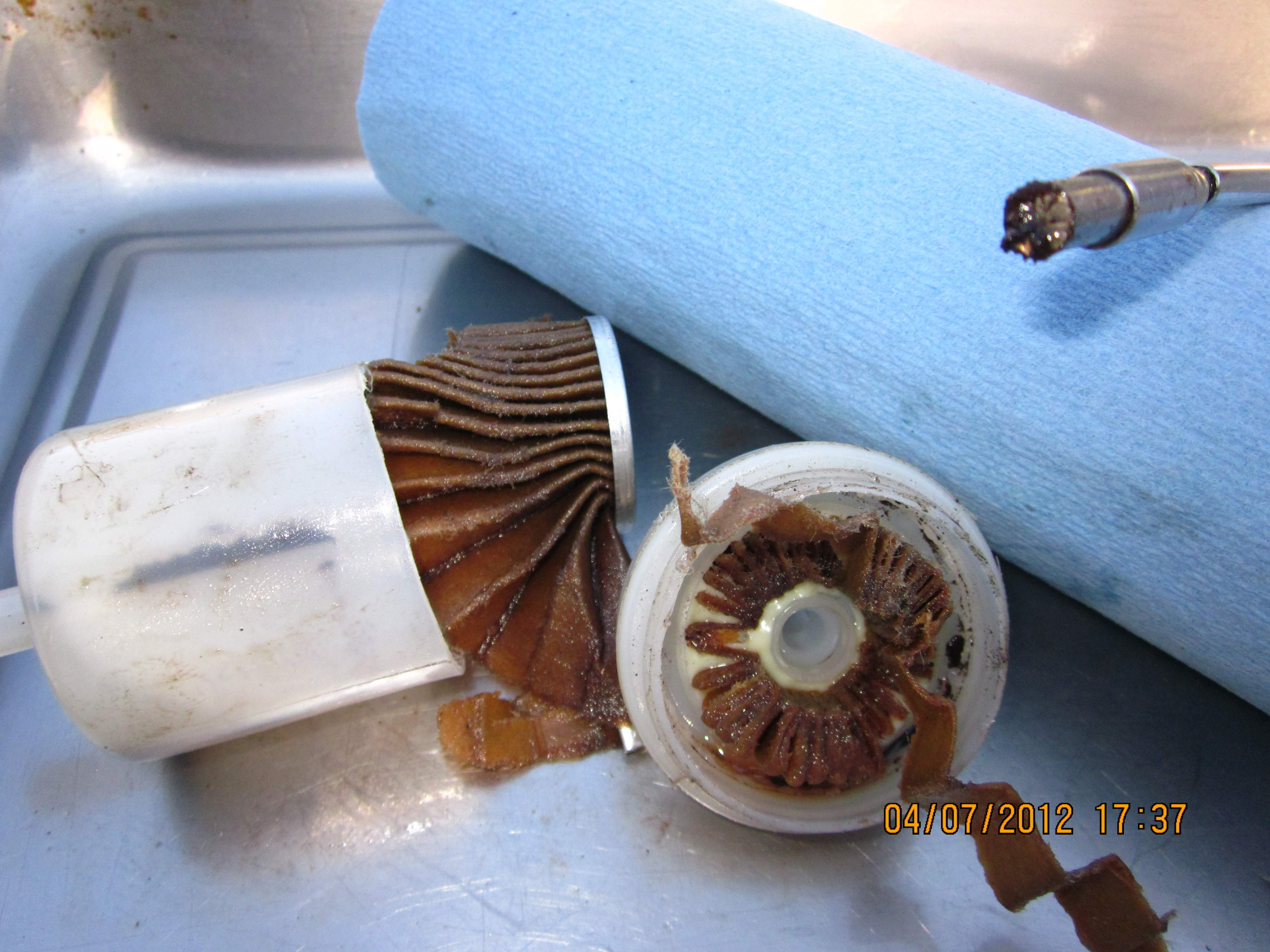

I have essentially the same problem as the OP. 2006(?) BX1850D stored under cover. Always fueled with Mobil from a local station. Symptoms: running ok then RPM's drop; sometimes just a bit, sometimes until I'm sure its going to stall and quickly disengage the PTO and let up on the wheel pedal. In every case it doesn't actually stall but after a few seconds is (apparently) back to normal. I was getting the work done but always nervous it was going to die and I would have to tow it back to the barn.
After reading the excellent info from the OP I got buckets ready under the 1850D and pulled off the fuel hose after the electric pump...barely any flow. Pulled off the hose after the primary fuel filter....barely any flow. Pulled off the hose feeding the primary fuel filter....decent flow, but way less that I expected from a nearly full tank. Then I blew air into the hose and presto, good flow. I was using a couple small pails to fill 5 gal pails and I had wiped all of them clean before starting. After the first couple pails were in the bucket I looked in the bucket and the bottom was loaded with small black debris. After it had been emptied and dried a bit I could shake the primary fuel filter and it sounded like a baby's rattle. I have not seen any debris other than the black stuff which looks like rust flakes.
I went through the very non-service-friendly work to get to the fuel sender (I never did get the mower height knob off even after beating it upwards with a mini-sledge) and what to my wondering eyes should appear but the exact same rust on the sender rheostat housing that OP discovered. And the extensive rust I saw is AFTER all the debris in the bucket had fallen off it. I have to believe the issue here is simply bad fuel senders. Consider: I use no additives, just fresh name brand Diesel that I store inside the barn in yellow 5 gal purpose-made cans. The tractor is inside the barn so there is not the "tank sitting in the bright sun" issue that produces water in aircraft fuel tanks. I'm located about 25 miles West of Boston so salt air isn't a factor. The fact is I've had occasion to pull senders out of many machines WAY older than this thing (maybe 300 hrs) like stationary gensets, trucks, cars, planes, etc and I've NEVER seen rust /corrosion on one even in the same ballpark as this.

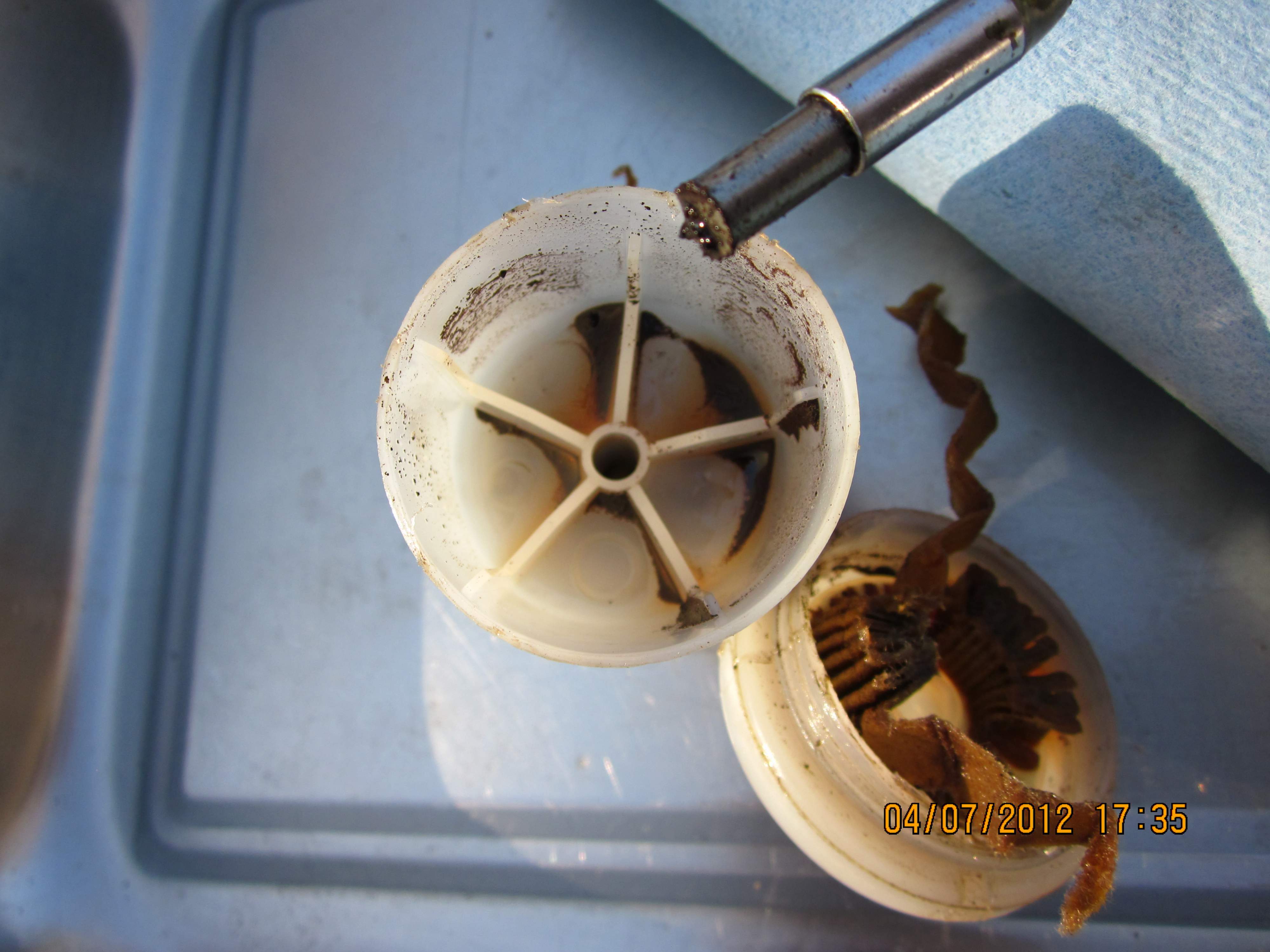

From iPhone 1-6-14 142.jpgFrom iPhone 1-6-14 145.jpgFrom iPhone 1-6-14 151.jpgFrom iPhone 1-6-14 159.jpgKeeping the tank full is a good idea but we shouldn't have to, especially as Kubota doesn't say to or even suggest it.
I know the rust/corrosion is known however there was a lot of comment about an additive possibly being a culprit or if it was just a very odd occurrence. I'm saying that even with other circumstances I have the exact same result. I called my dealer and they looked up the p/n for a s/b or any comment at all about the design and there was none. So presumably Kubota is making the exact same item today.
I showed the sender to some mechanics at work and all were amazed that such damage could be caused inside a tank.
I have attached 4 pics, the orange thing is the Home Depot bucket of fuel that was totally clean so you can see all the crap that came out of the tank. The other 3 are of the sender, note the holes rusted right through the cover.
